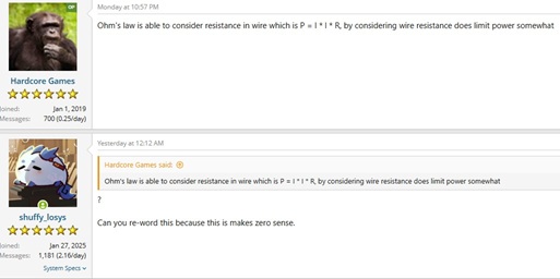

 Post subject: SAMSUNG PM981
PostPosted: February 23rd, 2026, 13:42
Posts: 155
Location: Canada
Digging through my junk box I found two Samsung PM981 M.2 NVMe SSD. One is 256GB and the other 512GB.
Testing then, both work. Neither has a lot of hours on them but the 512GB has some games on it at present
It seems I forgot that I had both sizes as I yanked OEM SSD for bigger capacity models long ago.
Orico DS500C3-US-BK 5-disk 3.5" SATA, iTGZ 4x M.2 2280 Thunderbolt enclosure NVMe/SATA, etc. etc.
 Post subject: Re: SAMSUNG PM981
PostPosted: Yesterday, 22:16
Posts: 3922
Interesting that this bot need to add 1 slang term per post. I am wondering how much human interaction is involved, but mostly what the purpose of it is. If it is for training, it can't be for the technical side. Most answers the bot would get is likely just commenting on its ridiculous posts. Maybe it is trying to figure out how to sound more like a real person, measuring the flack it gets to figure this out. We live in strange times
 Post subject: Re: SAMSUNG PM981
PostPosted: Today, 10:22
Posts: 155
Location: Canada
At least I have working SASs in case somebody needs voltages
But I am less inclined when tards come out of the woodwork
Orico DS500C3-US-BK 5-disk 3.5" SATA, iTGZ 4x M.2 2280 Thunderbolt enclosure NVMe/SATA, etc. etc.
 Post subject: Re: SAMSUNG PM981
PostPosted: Today, 14:34
Posts: 334
Location: Eastern Europe
Who's scarier than a narcissist? A resentful narcissist. Perhaps resentful on this forum... and under a different nickname...
 Post subject: Re: SAMSUNG PM981
PostPosted: 6 minutes ago
Posts: 3922
https://www.techpowerup.com/forums/threads/thunderbolt-storage-options.350484/
seems this guy/bot has been posting here, same strange posts, random mish-mash of percieved facts.
Not getting called out on its bulls##t all that much but seems to be some suspicion
Techforums.jpg [ 28.63 KiB | Not viewed yet ]
