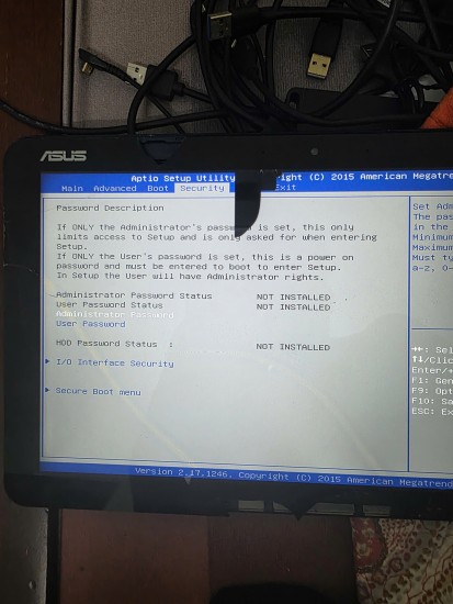

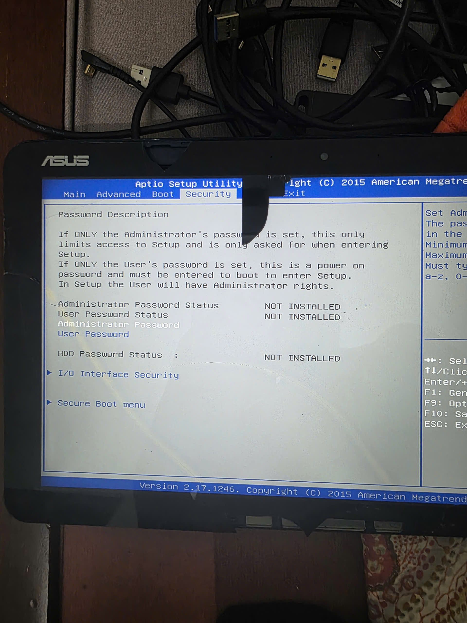

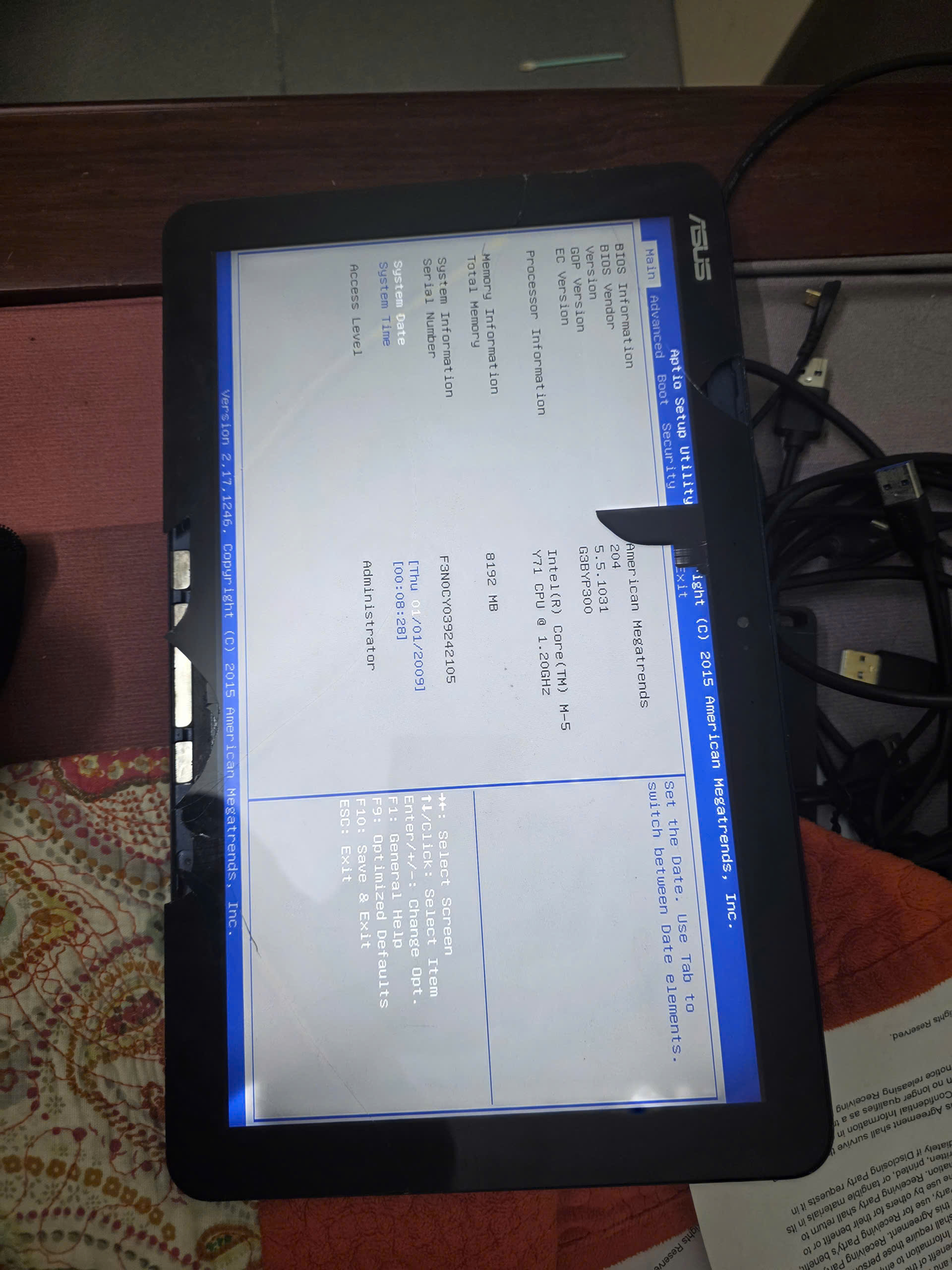

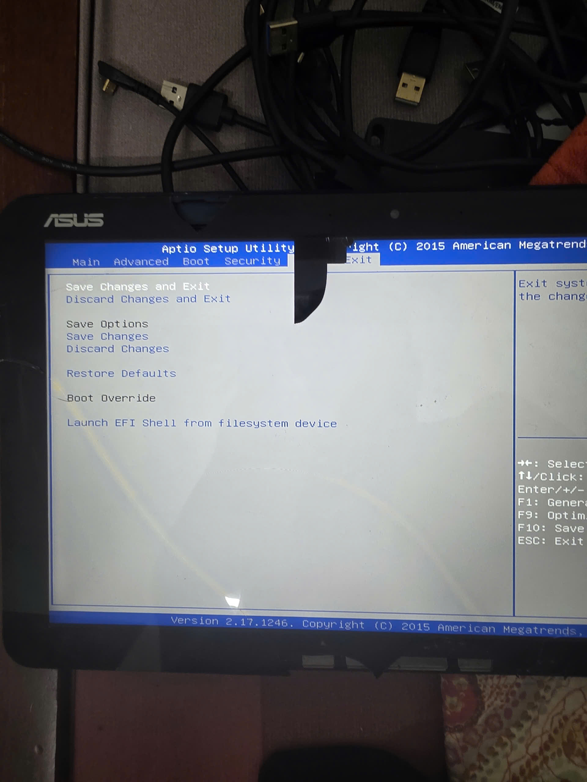

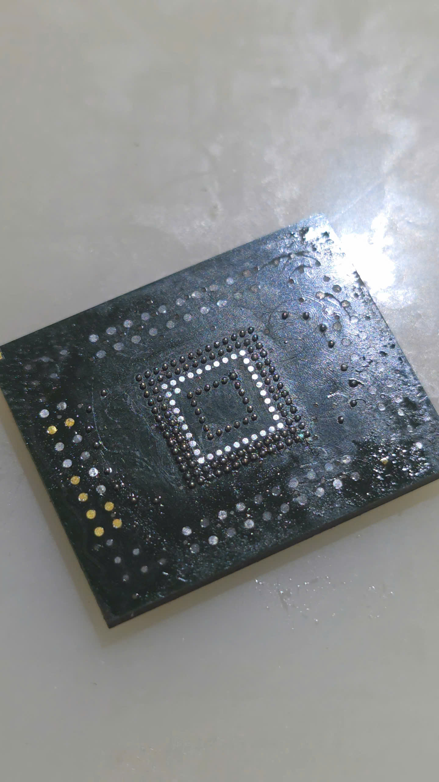

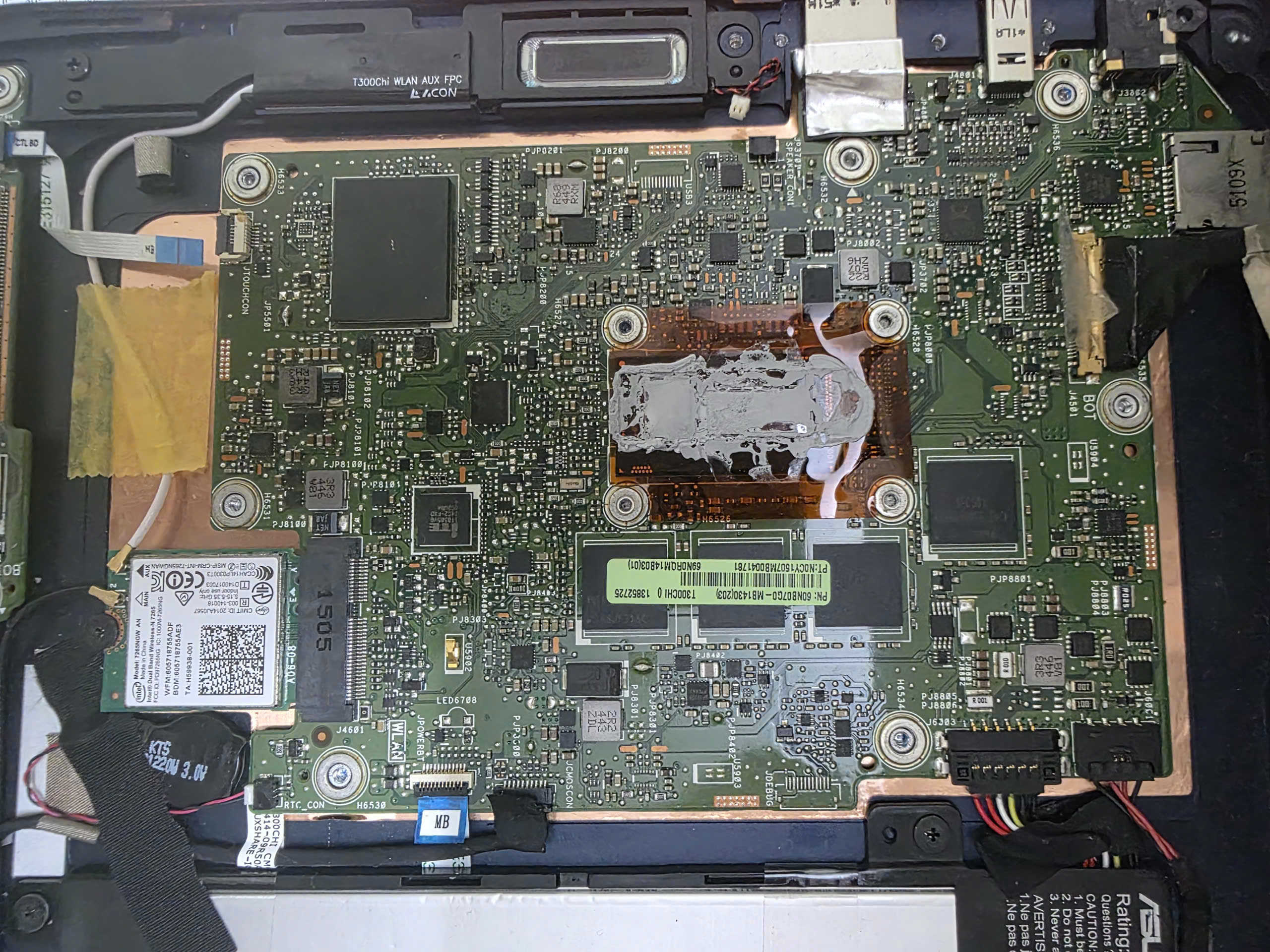

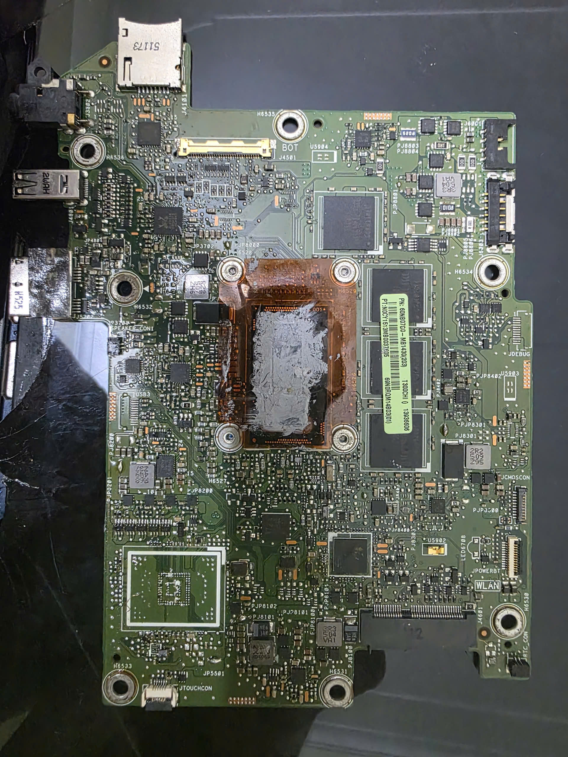

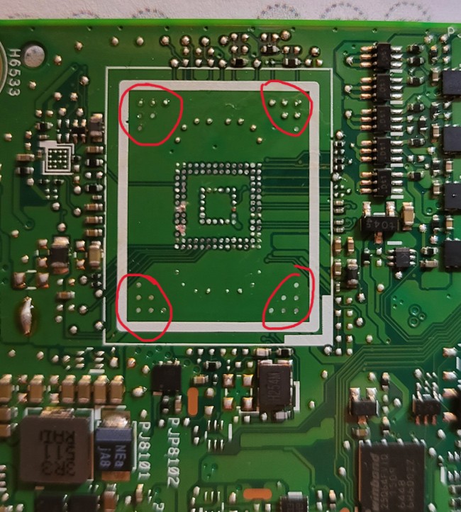

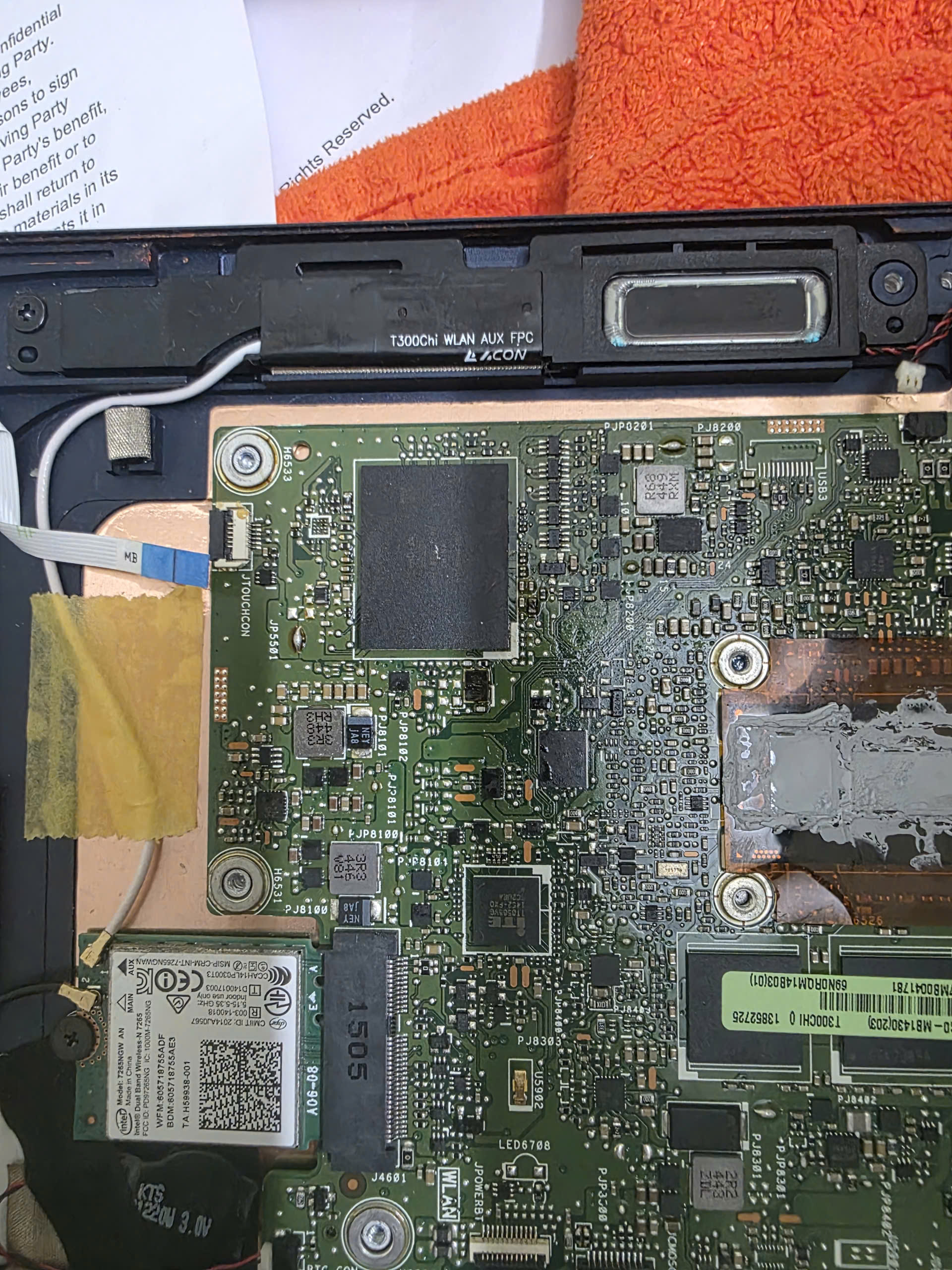

 Post subject: Sandisk iSSD SDIS6BM-128G
PostPosted: November 27th, 2022, 20:22
Joined: November 21st, 2009, 10:38
Posts: 72
Location: Europe
I need to recover data from this chip: Sandisk iSSD SDIS6BM-128G
It come from ASUS Tablet T300 chi.
I thought about trying to read it as a common eMMC but the pinout doesn't seem to match.
Can anyone help me?
20221125_003516.jpg [ 103.35 KiB | Viewed 9062 times ]
File comment: PCB
20221128_002834.jpg [ 235.94 KiB | Viewed 9062 times ]
20221125_004438.jpg [ 426.39 KiB | Viewed 9062 times ]
 Post subject: Re: Sandisk iSSD SDIS6BM-128G
PostPosted: November 27th, 2022, 23:09
Posts: 17095
That's a complete SATA SSD on a chip.
Here is an example:
https://www.worthpoint.com/worthopedia/sandisk-24gb-half-msata-ssd-drive-1787396198
https://thumbs.worthpoint.com/zoom/images2/1/1115/17/sandisk-24gb-half-msata-ssd-drive_1_1c2daa154296923cf00a661abbe914b2.jpg
https://thumbs.worthpoint.com/zoom/images1/1/1115/17/sandisk-24gb-half-msata-ssd-drive_1_1c2daa154296923cf00a661abbe914b2.jpg
 Post subject: Re: Sandisk iSSD SDIS6BM-128G
PostPosted: November 28th, 2022, 5:39
Joined: November 21st, 2009, 10:38
Posts: 72
Location: Europe
That's a complete SATA SSD on a chip.
So how to read without PCB ?
 Post subject: Re: Sandisk iSSD SDIS6BM-128G
PostPosted: November 28th, 2022, 12:06
Posts: 17095
Find a complete SSD solution and transfer the chip, eg ...
http://images.mjdic.com/Attachments/product/201601/569489714b97d.jpg
... or repair the tablet.
 Post subject: Re: Sandisk iSSD SDIS6BM-128G
PostPosted: June 15th, 2026, 16:39
Posts: 257
Location: Vietnam
i my self also stumbled accross this drive. The SSD boards are so hard to find. There are almost none
 Post subject: Re: Sandisk iSSD SDIS6BM-128G
PostPosted: July 30th, 2026, 12:49
Posts: 257
Location: Vietnam
I am digging this up. I got my hands on a donor board. that was fully functional and can get into windows
I swapped the SSD
But both the donor and patient SSD now is not recognisable in BIOS
I don't think i killed the SSD. Since i use 360 degrees C to solder and desolder the SSDs
I think i am coming accross somekind of hard lock on the tablet
7 SOLDERING SSD.jpg
7 SOLDERING SSD.jpg [ 444.77 KiB | Viewed 438 times ]
6 BIOS 4.jpg
6 BIOS 4.jpg [ 337.87 KiB | Viewed 438 times ]
5 BIOS 3.jpg
5 BIOS 3.jpg [ 575.49 KiB | Viewed 438 times ]
4 BIOS 1.jpg
4 BIOS 1.jpg [ 550.42 KiB | Viewed 438 times ]
3 PATIENT PCB.jpg
3 PATIENT PCB.jpg [ 1.11 MiB | Viewed 438 times ]
2 DONOR PCB.jpg
2 DONOR PCB.jpg [ 1.13 MiB | Viewed 438 times ]
1 DONOR PCB.jpg
1 DONOR PCB.jpg [ 1.15 MiB | Viewed 438 times ]
 Post subject: Re: Sandisk iSSD SDIS6BM-128G
PostPosted: July 30th, 2026, 13:20
Posts: 257
Location: Vietnam
I am curious if these pins serve any purpose. Only this SSD have those pins
8.1.jpg [ 144.88 KiB | Viewed 422 times ]
 Post subject: Re: Sandisk iSSD SDIS6BM-128G
PostPosted: July 30th, 2026, 16:31
Posts: 1305
Size and location would suggest mechanical anchor points and grounding.
 Post subject: Re: Sandisk iSSD SDIS6BM-128G
PostPosted: July 31st, 2026, 6:37
Posts: 3929
looks like all on the ground plane, if looking at the PCB. You could probably buzz it out to see if they are all ground. But some datasheets do say similar pads need to be soldered. on your picture of the chip above, you can see that there are traces going to those pins, most look connected together, but the bottom left group at least has the top pin not connected to the others. I wouldn't assume anything just in case. You might be lucky to find a datasheet, or at least of something similar
Users browsing this forum: Google [Bot] and 26 guests
