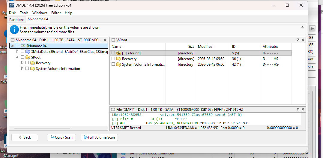

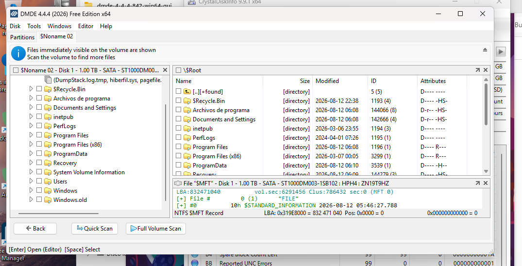

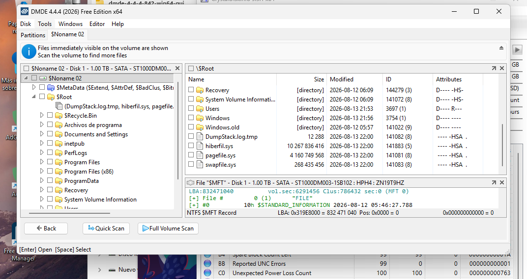

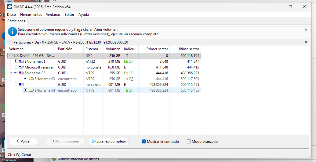

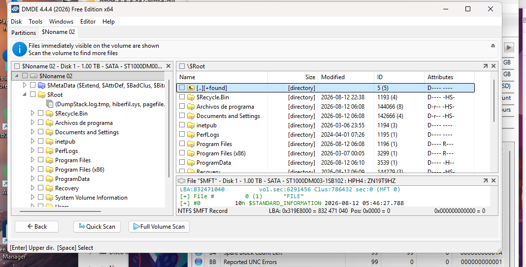

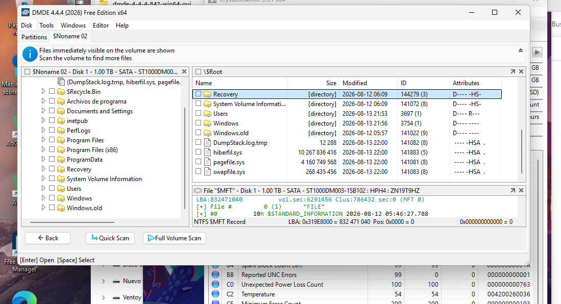

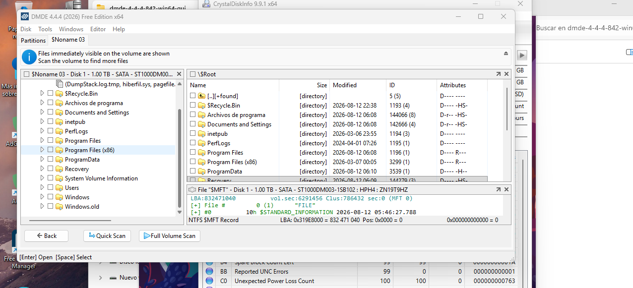

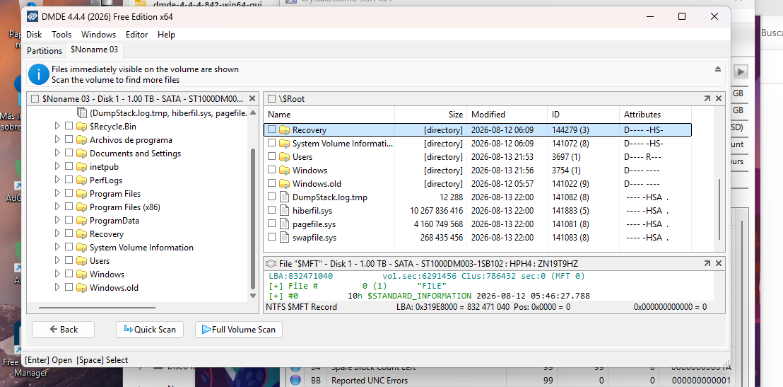

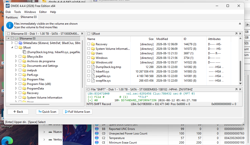

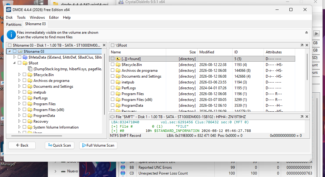

Post new topic Reply to topic  [ 30 posts ]  Go to page Previous  1, 2
 Post subject: Re: How to fix the SSD of the body of this thread using RAID
PostPosted: Today, 12:10
Joined: August 10th, 2026, 18:07
Posts: 22
Location: Miami
Yes, they are.
 Post subject: Re: How to fix the SSD of the body of this thread using RAID
PostPosted: Today, 12:13
Joined: August 10th, 2026, 18:07
Posts: 22
Location: Miami
Yes, they are, but only on the SSD, not on the RAID drive.
Last edited by gamingnogaming on August 13th, 2026, 12:15, edited 1 time in total.
 Post subject: Re: How to fix the SSD of the body of this thread using RAID
PostPosted: Today, 12:13
Joined: August 10th, 2026, 18:07
Posts: 22
Location: Miami
I didn't realize that it showed that the messages had been edited when I edited my posts on this forum, and since I needed you to read edited messages, I had to mention that they had been edited. But now that I know the forum indicates when a message has been edited, I don't need to do that anymore.
 Post subject: Re: How to fix the SSD of the body of this thread using RAID
PostPosted: Today, 12:18
Joined: August 10th, 2026, 18:07
Posts: 22
Location: Miami
And I won't do it.
 Post subject: Re: How to fix the SSD of the body of this thread using RAID
PostPosted: Today, 12:30
Online
Posts: 161
You have two drives in your computer, an SSD and an HDD.
gamingnogaming wrote:
Seagate ST1000DM003-1SB102 1,000.2 GB SATA III 6 Gb/s internal HDD, and a KingSpec P3-256 256.0 GB SATA III 6 Gb/s internal SSD
What RAID drive are you talking about?
gamingnogaming wrote:
Yes, they are, but only on the SSD, not on the RAID drive.
So you can see your files on the SSD.
This means no array is configured.
Show the partitioning of the second disk in DMDE.
There is a damaged partition on the SSD (B red mark - volume boot sector), you need to repair it (which is risky without making a disk copy), or recover the data immediately (for example via DMDE), which is also risky without a disk copy.
Or maybe I don't understand something...
 Post subject: Re: How to fix the SSD of the body of this thread using RAID
PostPosted: Today, 13:29
Joined: August 10th, 2026, 18:07
Posts: 22
Location: Miami
This is the Seagate ST1000DM003-1SB102 1,000.2 GB SATA III 6 Gb/s internal HDD. As I have already mentioned, this is not the HDD I used to create the RAID. I will show its partitioning in DMDE in the attached images, in chronological order from bottom to top.
(Explicación de DMDE HDD en inglés)9.png
(Explicación de DMDE HDD en inglés)9.png [ 92.01 KiB | Viewed 52 times ]
(Explicación de DMDE HDD en inglés)8.png
(Explicación de DMDE HDD en inglés)8.png [ 134.04 KiB | Viewed 52 times ]
(Explicación de DMDE HDD en inglés)7.png
(Explicación de DMDE HDD en inglés)7.png [ 163.76 KiB | Viewed 52 times ]
(Explicación de DMDE HDD en inglés)6.png
(Explicación de DMDE HDD en inglés)6.png [ 156.77 KiB | Viewed 52 times ]
(Explicación de DMDE HDD en inglés)5.png
(Explicación de DMDE HDD en inglés)5.png [ 136.67 KiB | Viewed 52 times ]
(Explicación de DMDE HDD en inglés)4.png
(Explicación de DMDE HDD en inglés)4.png [ 174.64 KiB | Viewed 52 times ]
(Explicación de DMDE HDD en inglés)3.png
(Explicación de DMDE HDD en inglés)3.png [ 118.04 KiB | Viewed 52 times ]
(Explicación de DMDE HDD en inglés)2.png
(Explicación de DMDE HDD en inglés)2.png [ 149.05 KiB | Viewed 52 times ]
(Explicación de DMDE HDD en inglés)1.png
(Explicación de DMDE HDD en inglés)1.png [ 117.65 KiB | Viewed 52 times ]
 Post subject: Re: How to fix the SSD of the body of this thread using RAID
PostPosted: Today, 13:34
Online
Posts: 161
gamingnogaming wrote:
As I have already mentioned, this is not the HDD I used to create the RAID.
I don't understand... Why are you showing devices that aren't affected by the problem?
You were supposed to post a screenshot of the main partition window, not everything you deem appropriate - these screenshots are useless...
I'm afraid I can't help you remotely, your descriptions are too chaotic.
 Post subject: Re: How to fix the SSD of the body of this thread using RAID
PostPosted: Today, 13:48
Joined: August 10th, 2026, 18:07
Posts: 22
Location: Miami
The SSD shown was affected by the problem. I showed that HDD because I believed you wanted me to do that, and I will also show the affected HDD. How can I identify the affected HDD if I don't remember which one it was?.
 Post subject: Re: How to fix the SSD of the body of this thread using RAID
PostPosted: Today, 14:01
Joined: August 10th, 2026, 18:07
Posts: 22
Location: Miami
How can I display the main partition window in DMDE? Please explain it in a way that someone with no computer knowledge can understand. Please forgive me for copying what I copied; I believed I was helping. From now on, I will ask what you want me to show before showing it, so I don't show unnecessary information.
 Post subject: Re: How to fix the SSD of the body of this thread using RAID
PostPosted: 45 minutes ago
Online
Posts: 161
Now I don't understand at all.
You wrote that your drives are in a RAID 0 array: SSD+HDD:
gamingnogaming wrote:
KingSpec P3-256 256.0 GB SATA III 6 Gb/s internal SSD( this is the drive is need to fix)
gamingnogaming wrote:
configured with the SATA Port set to Super Speed and the Storage Configuration set to RAID 0?
Which turned out to be false, at least based on all the information you provided.
Now you write that:
gamingnogaming wrote:
How can I identify the affected HDD if I don't remember which one it was?.
We're supposed to know which of your devices is failing, what you did during/after the failure, and finally, you write that the problem is with the HDD.
What is the main problem or which device is affected by the problem?
This is the main partition window in DMDE:
Captura de pantalla 2026-08-11 192057.png
Captura de pantalla 2026-08-11 192057.png [ 68.53 KiB | Viewed 16 times ]
Post new topic Reply to topic  [ 30 posts ]  Go to page Previous  1, 2
Users browsing this forum: Lukas and 38 guests
