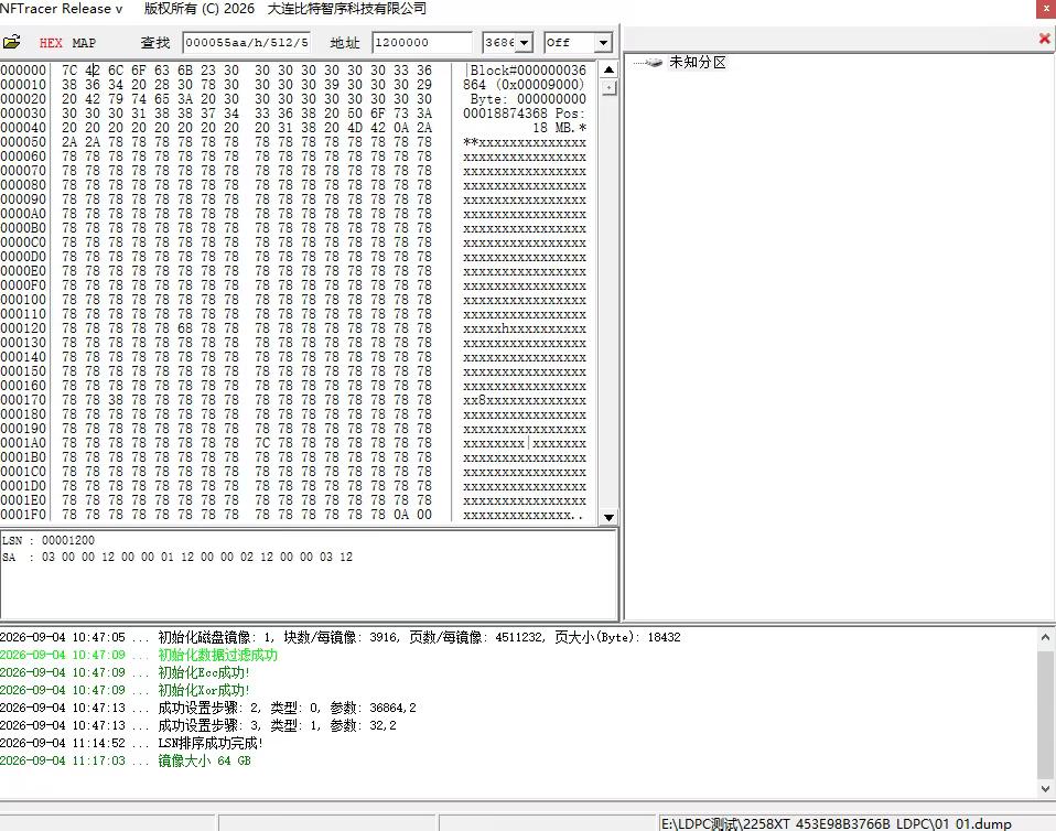

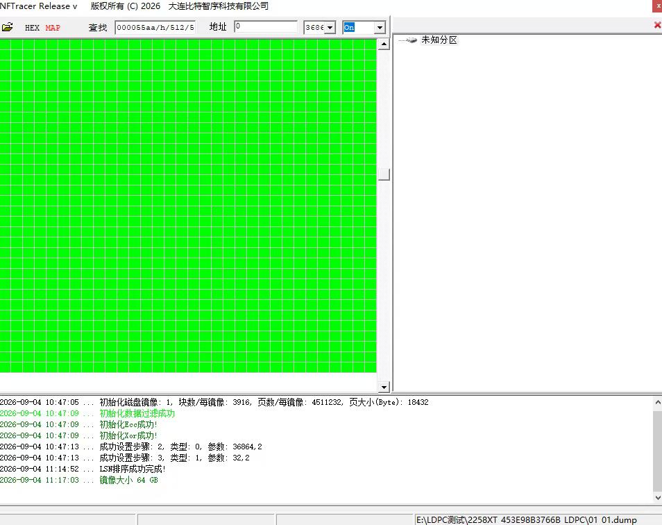

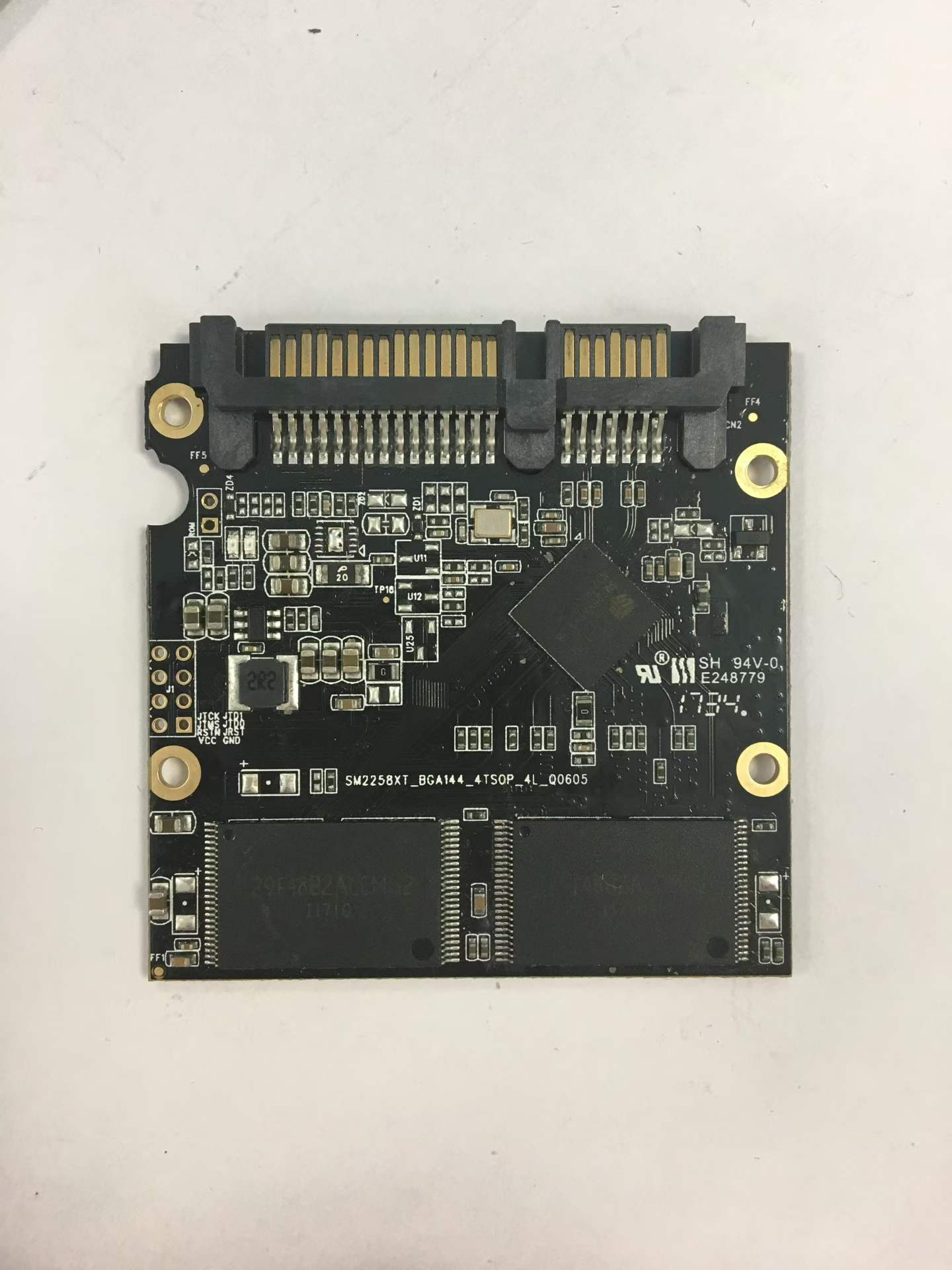

 Post subject: [SSD][SM2258XT]NAND Flash Tracer major new content
PostPosted: Yesterday, 3:09
Joined: April 9th, 2026, 0:03
Posts: 25
Location: china
NAND Flash Tracer is set to release major new content.
Full‑workflow data recovery support for the SM2258XT controller, one of the most widely‑used SSD controllers, will be added in the next update.
1.jpg [ 170.87 KiB | Viewed 116 times ]
2.jpg [ 107.76 KiB | Viewed 116 times ]
3.jpg [ 154.33 KiB | Viewed 116 times ]
website: https://www.flash-tracer.com/
