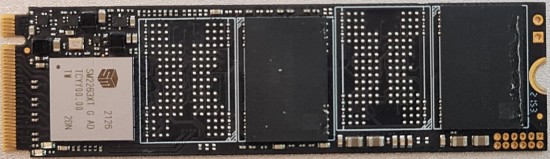

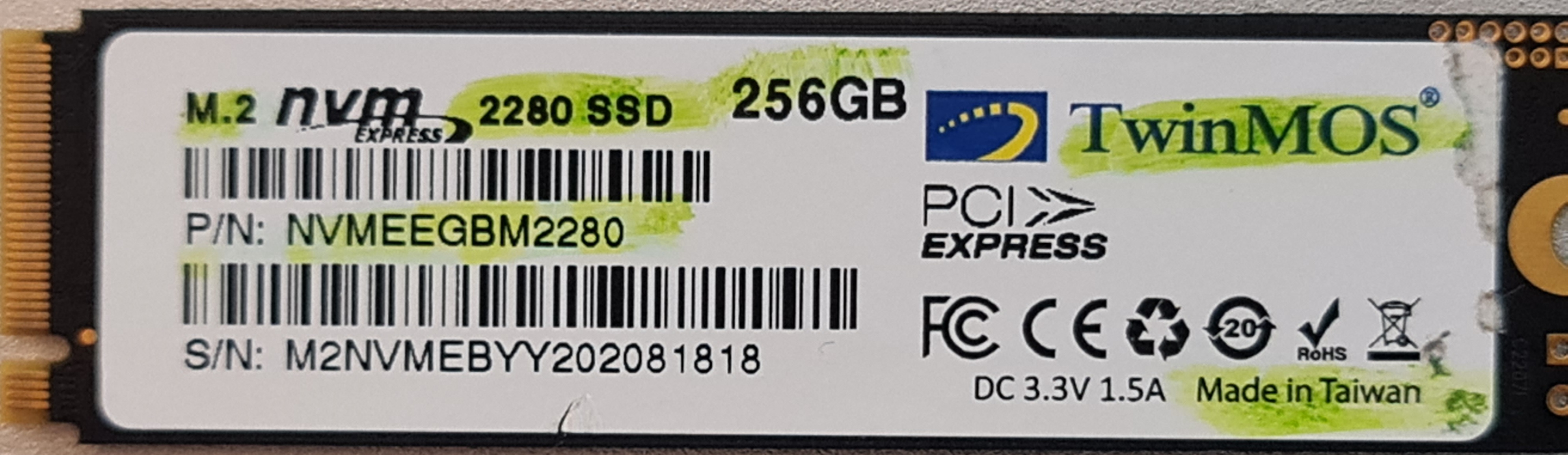

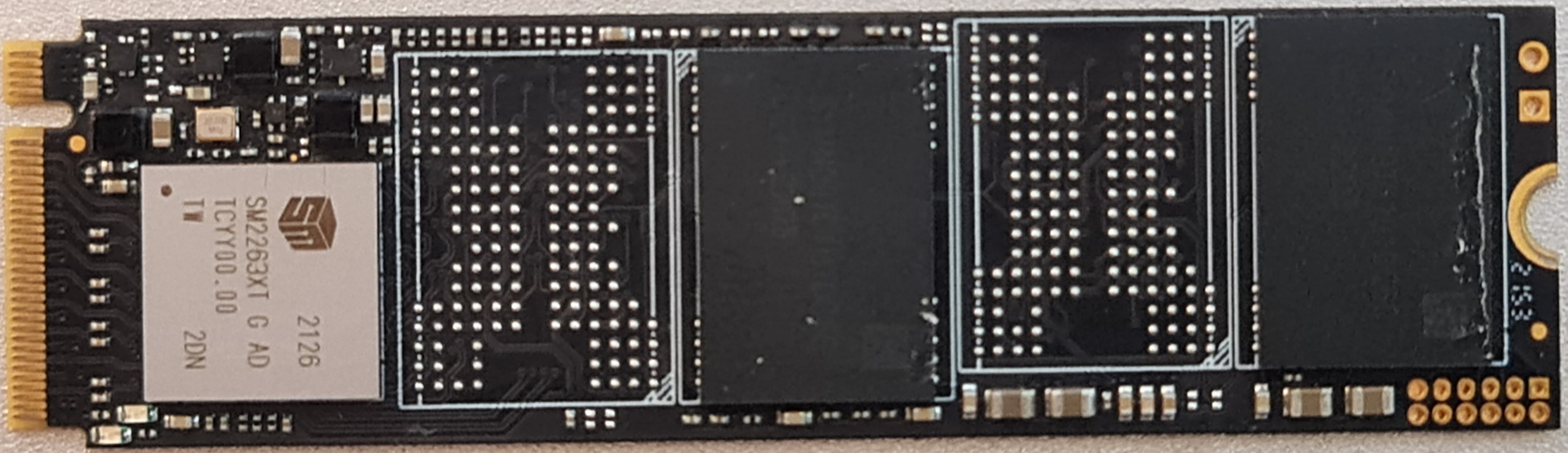

 Post subject: Help me find power schematic SSD TwinMos 256G
PostPosted: Yesterday, 8:53
Joined: September 2nd, 2026, 7:56
Location: iraq/baghdad
Hi everyone
Can someone help me find power schematic of this SSD TwinMos 256G
The SSD no powering
thanks
File comment: Back
20260908_041247.jpg [ 3.79 MiB | Viewed 114 times ]
File comment: Front
20260908_041159.jpg [ 4.01 MiB | Viewed 114 times ]
 Post subject: Re: Help me find power schematic SSD TwinMos 256G
PostPosted: Yesterday, 9:51
Posts: 1312
You're not likely to find any off the shelf, but the power components looks to be above the controller. We're going to need much better images to try and identify the ICs used though we need to be able to read the IC markings.
Users browsing this forum: No registered users and 32 guests
