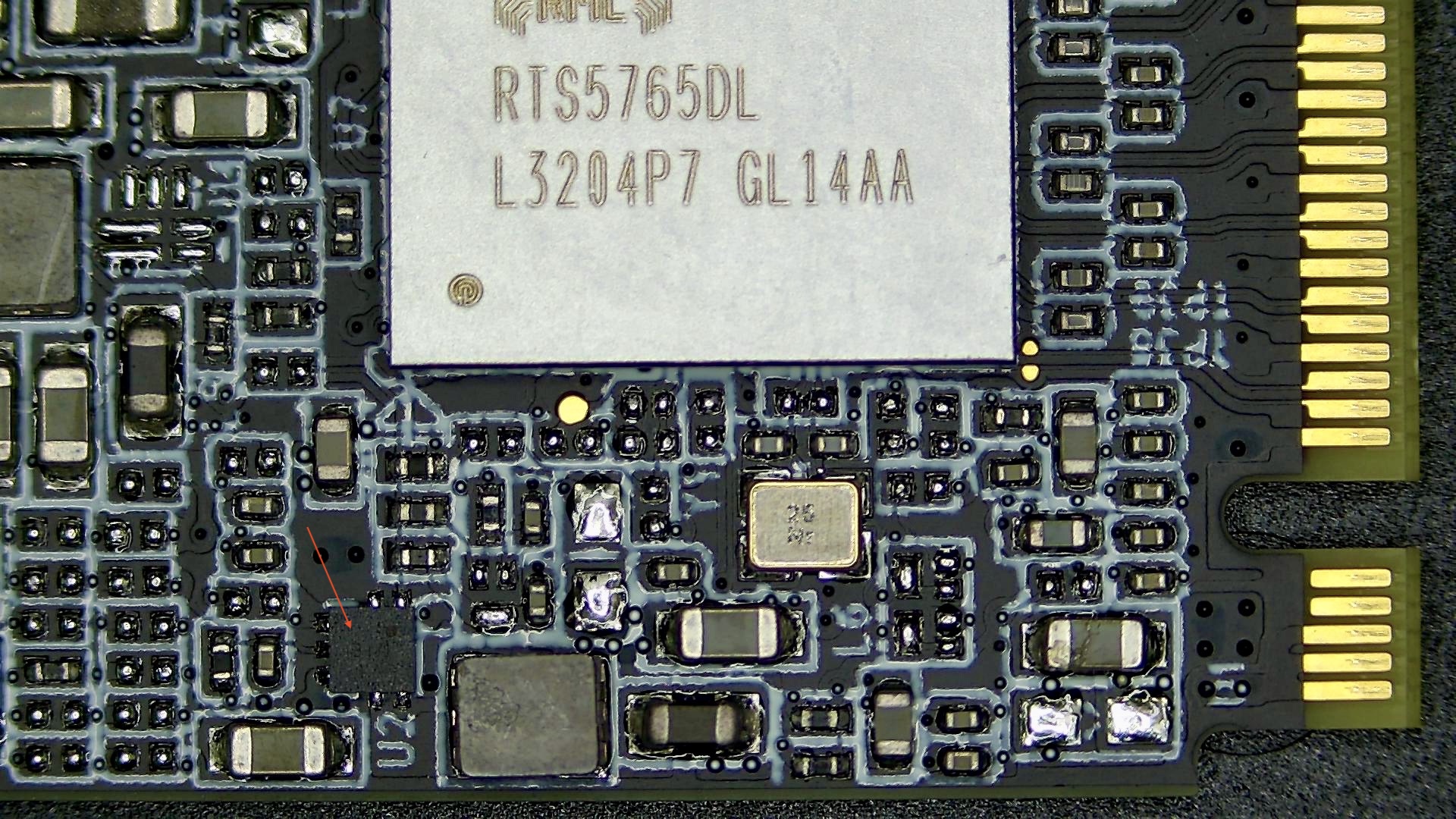

 Post subject: Does anyone know what SMD this is?
PostPosted: Yesterday, 0:33
Posts: 1241
Location: inside ROM
Does anyone know what SMD this is? from nvme ssd.
Thank you
IMG_7248.JPG [ 3.63 MiB | Viewed 314 times ]
 Post subject: Re: Does anyone know what SMD this is?
PostPosted: Yesterday, 6:15
Posts: 17256
Could we see the whole PCB, for context?
 Post subject: Re: Does anyone know what SMD this is?
PostPosted: Yesterday, 20:06
Posts: 1241
Location: inside ROM
Thank you
1.jpg [ 811.92 KiB | Viewed 172 times ]
 Post subject: Re: Does anyone know what SMD this is?
PostPosted: Yesterday, 22:43
Posts: 17256
It's a step-down converter, but I can't identify it.
I have posted a question on your behalf:
https://www.reddit.com/r/ElectronicsRepair/comments/1wviisu/need_help_to_id_stepdown_converter_marking_vt_die/
 Post subject: Re: Does anyone know what SMD this is?
PostPosted: Today, 0:37
Posts: 1241
Location: inside ROM
The post for somehow has been removed.
 Post subject: Re: Does anyone know what SMD this is?
PostPosted: Today, 3:45
Joined: September 18th, 2026, 5:10
Posts: 14
Location: San Diego, CA
TerraNova wrote:
The post for somehow has been removed.
That's reddit for you LOL
 Post subject: Re: Does anyone know what SMD this is?
PostPosted: Today, 10:24
Posts: 17256
It might help if we could identify the other ICs. Often a designer will select ICs from the same manufacturer.
 Post subject: Re: Does anyone know what SMD this is?
PostPosted: Today, 10:46
Posts: 17256
It appears that "Vt" is the part ID. The second line is probably a date/batch code.
https://www.inhdd.com/wp-content/uploads/2022/07/75a797caf6745ed.png
Users browsing this forum: No registered users and 111 guests
