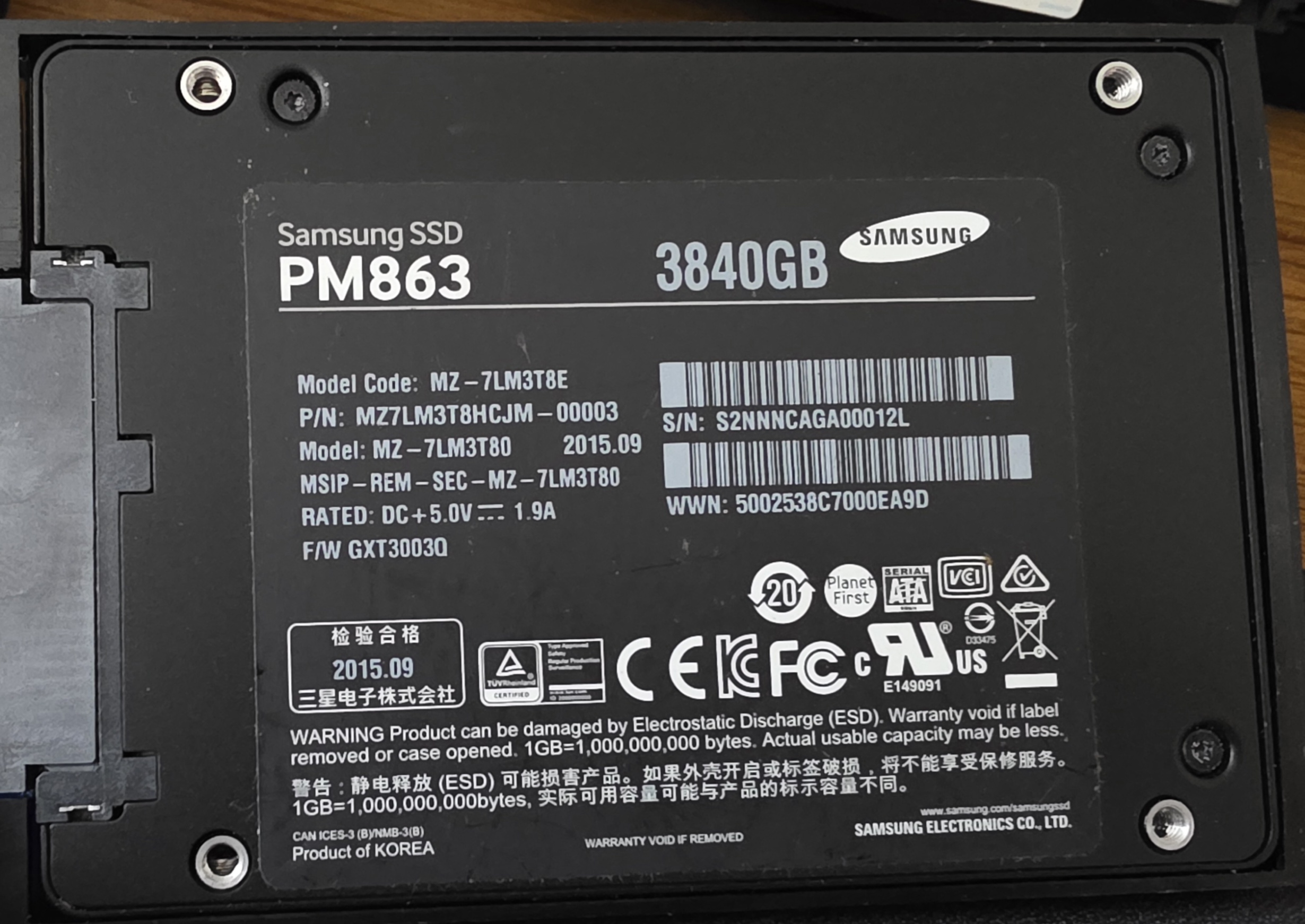

 Post subject: Looking for Samsung PM863 3.84TB firmware. Please help.
PostPosted: Today, 13:01
Joined: Today, 12:55
Location: Dhaka
Hello everyone,
Hope you are doing well. I have two 3.84TB Samsung PM863 SATA SSD that I purchased about 10 years ago. I bought them from a website (new), so they are not from Dell/HP etc.
There were some file corruptions, and I think that it could be due to an early bug these SSDs had. My SSD firmware is very old: GXT3003Q. I was wondering if anyone have any later firmware that I can flash my SSDs with.
I've attached an image of one of the SSDs, just in case if it helps.
I found and updated firmware from the amazing repository I found on hddguru, but sadly no firmware for PM863 (Non-A)
Please help. Many thanks in advance.
20261004_220650.jpg [ 819.57 KiB | Viewed 31 times ]
Users browsing this forum: No registered users and 122 guests
