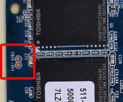

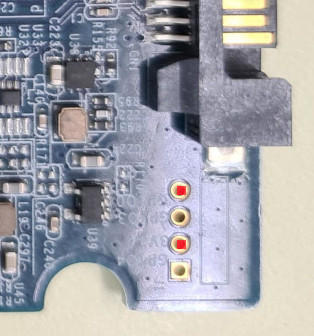

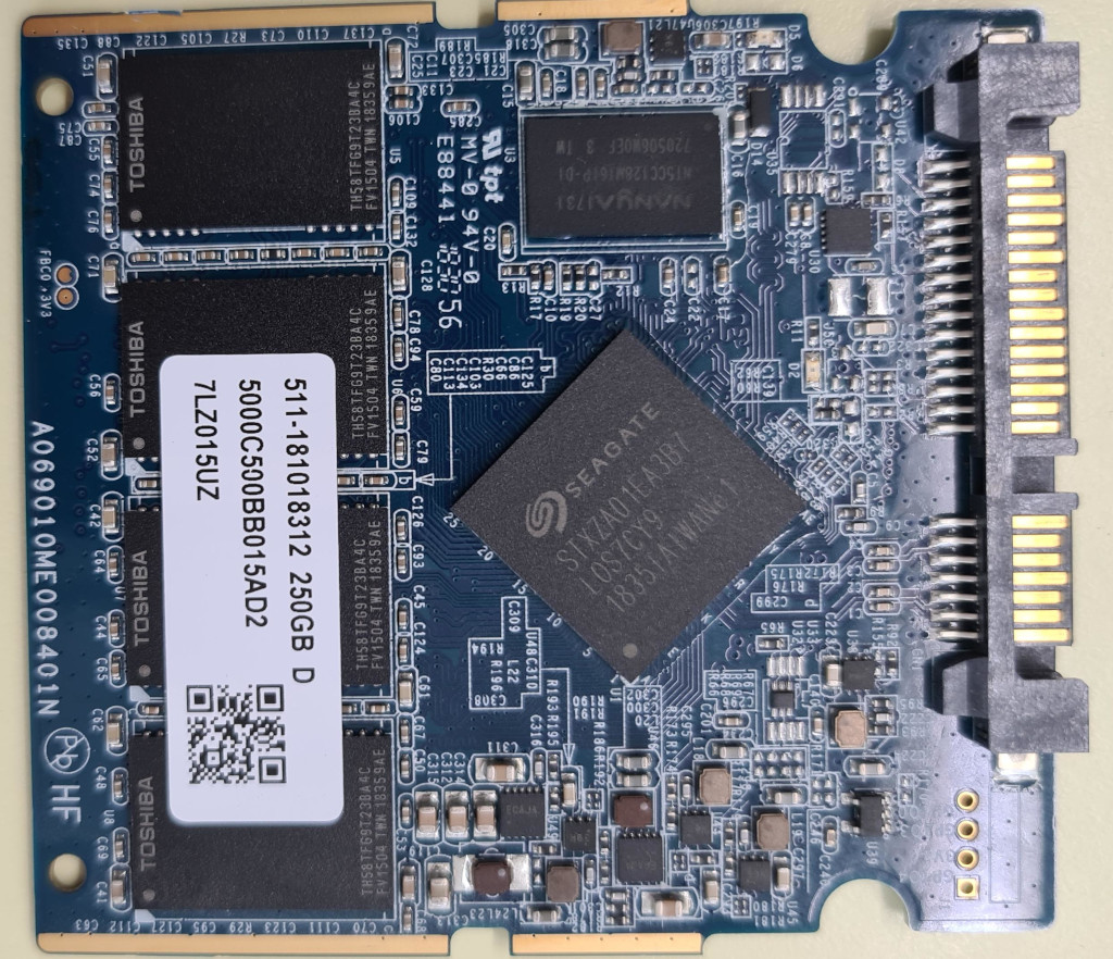

 Post subject: BarraCuda ZA250CM10002 controller STXZA01EA3B7
PostPosted: Yesterday, 11:47
Joined: October 24th, 2019, 4:36
Posts: 12
Location: Milan
I need to now how to short this SSD to bring it in safe mode.
It's seem to work but the 10% of files are blank so I'd like to try the PS3110 LDR to create the translator.
Thanks a lot
Donato
RAID Data Recovery Cases
 Post subject: Re: BarraCuda ZA250CM10002 controller STXZA01EA3B7
PostPosted: Today, 9:50
Joined: October 24th, 2019, 4:36
Posts: 12
Location: Milan
here the picture
pv20261006_114823.jpg [ 328.79 KiB | Viewed 120 times ]
RAID Data Recovery Cases
 Post subject: Re: BarraCuda ZA250CM10002 controller STXZA01EA3B7
PostPosted: Today, 10:06
Joined: November 5th, 2015, 18:00
Posts: 82
Location: in the lab
I would try those test points.
FCB0-3V3.jpg [ 21.39 KiB | Viewed 107 times ]
VEXUS Data Recovery
 Post subject: Re: BarraCuda ZA250CM10002 controller STXZA01EA3B7
PostPosted: Today, 10:15
Posts: 17261
https://www.hddoracle.com/viewtopic.php?p=22242#p22242
 Post subject: Re: BarraCuda ZA250CM10002 controller STXZA01EA3B7
PostPosted: Today, 10:46
Joined: October 24th, 2019, 4:36
Posts: 12
Location: Milan
Thank you.
Meanwhile I've found this short for safe mode, what do you think about?
pv20261006_114823shortCut.jpg [ 41.55 KiB | Viewed 95 times ]
RAID Data Recovery Cases
 Post subject: Re: BarraCuda ZA250CM10002 controller STXZA01EA3B7
PostPosted: Today, 13:20
Posts: 17261
From my HDD Oracle link ...
This thread talks about the safe mode shorting point for a Toshiba TC58NC1000GSB controller (rebadged Phison PS3110s):
https://forum.acelaboratory.com/viewtopic.php?t=8881
The shorting points are claimed to be "3V3" and "GPIO0". I can't see whether any resistors are involved, but the GPIO (General Purpose Input Output) pads would be connected to the controller's I/O section.
Here is a similar SSD:
https://i0.wp.com/www.thessdreview.com/wp-content/uploads/2014/08/Phison-Controller-1.jpg
Users browsing this forum: No registered users and 107 guests
