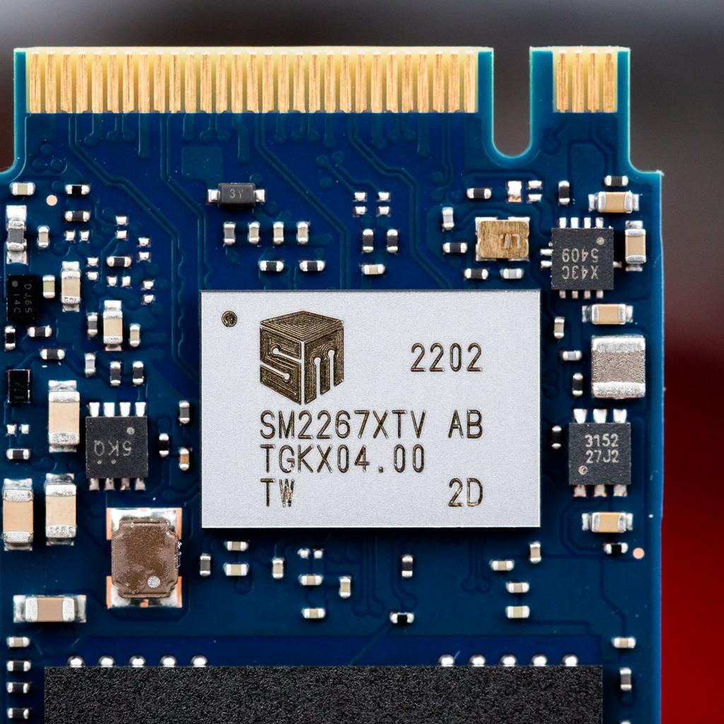

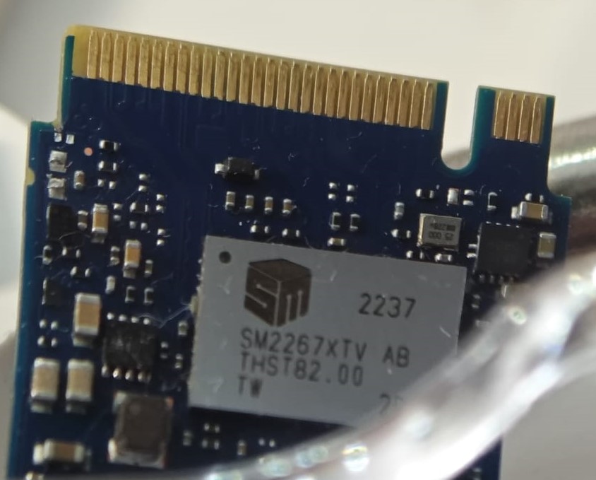

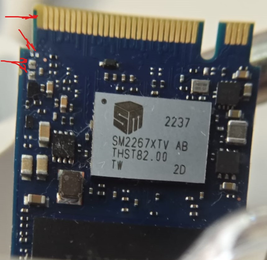

 Post subject: Kingston NV2 PCIe 4.0NVMe M.2 2TB
PostPosted: Today, 15:41
Joined: October 6th, 2026, 11:30
Location: Deutschland
I have a Kingston NV2 PCIe 4.0NVMe M.2 2TB (SNV2S/2000G).
While removing the heatsink from the SSD, I accidentally damaged the PCB. After that, the SSD stopped being detected.
It is now completely undetected — not in BIOS, Windows Device Manager, or Disk Management. I also tested it in another M.2 slot with the same result.
After carefully inspecting the PCB, I noticed several suspicious/damaged areas in the upper-left part of the board. There appear to be two small component locations/pairs of solder pads, and I am also unsure about one edge contact.
I would like to determine exactly what was damaged and whether the SSD can be repaired.
My questions:
What are these two small components/pads?
What should their values/specifications be?
Is the edge contact supposed to be there, or was it intentionally not populated?
Does anyone have a high-resolution photo of the exact same Kingston NV2 2TB PCB revision for comparison?
Could damage to these components/pads cause the SSD to become completely undetectable?
What power rails, voltages, or resistance measurements should I safely check with a multimeter before attempting any repair?
The data on the SSD is very important, so I don't want to solder or short anything without first knowing exactly what these components and pads are.
I have attached close-up photos of the damaged area.
I would really appreciate help from anyone experienced with NVMe SSD repair or data recovery.
Thank you!
I found photos of the Kingston NV2 SNV2S/2000G with a very similar PCB layout. Could you compare them with my board and check the positions of the two components I marked? I’m trying to determine the exact values of these two components.
File comment: A complete donor SSD.
3.jpg [ 151.01 KiB | Viewed 41 times ]
File comment: An SSD with two missing components and a damaged trace in the upper-left corner.
0.jpeg [ 107.97 KiB | Viewed 41 times ]
File comment: An SSD with two missing components and a damaged trace in the upper-left corner.
1_LI.jpg [ 1.52 MiB | Viewed 41 times ]
 Post subject: Re: Kingston NV2 PCIe 4.0NVMe M.2 2TB
PostPosted: Today, 16:26
Online
Joined: May 5th, 2025, 11:14
Posts: 73
Location: Planet Earth
What are these two small components/pads?
What should their values/specifications be?
Is the edge contact supposed to be there, or was it intentionally not populated?
The missing contact is a ground connection; it is redundant, so its absence can safely be ignored. The small, detached yellow component is likely a filter capacitor. This can also be ignored if it is not part of some power supply circuit, but rather a filter element. The slightly larger, detached gray component is a ferrite bead. Its absence is significant and is likely the reason the SSD isn't working. If absolutely necessary, you can replace it with a blob of solder, and the SSD should work. It is unlikely anyone can tell you the exact specifications of these components, as determining them would require an identical SSD, high-quality measuring equipment, and desoldering the parts for testing.
If you don't want to resort to a "hack job," you'll need to buy an identical (with the same board, but a smaller capacity, so it's not too expensive), preferably a faulty SSD, and take these parts from it.
Last edited by ora on October 13th, 2026, 16:29, edited 1 time in total.
 Post subject: Re: Kingston NV2 PCIe 4.0NVMe M.2 2TB
PostPosted: Today, 16:28
Posts: 275
Location: Canada
See; https://tpucdn.com/ssd-specs/images/d/1 ... -front.jpg
