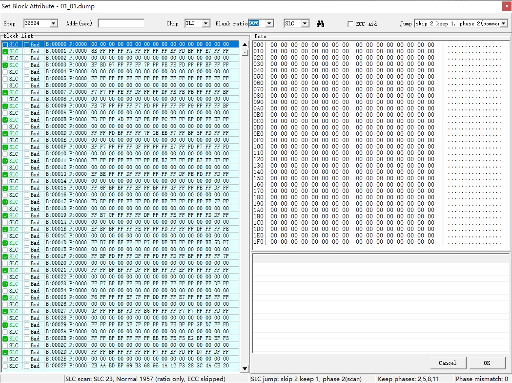

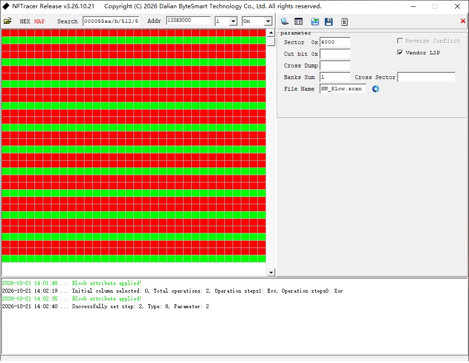

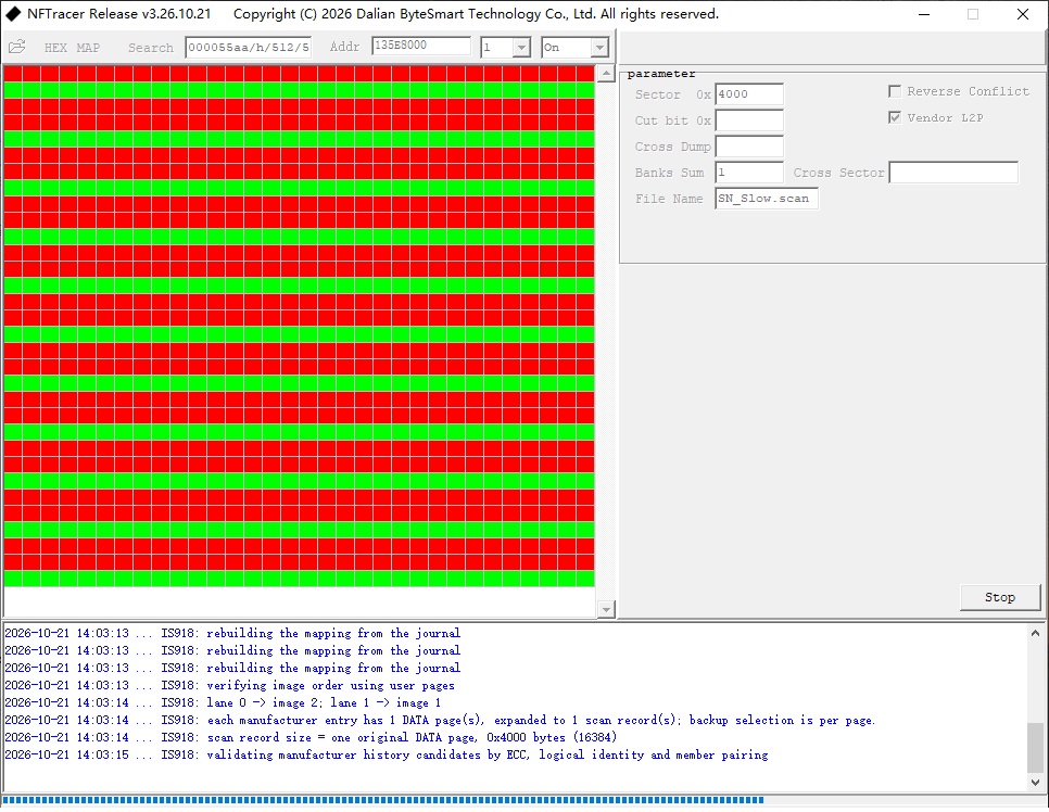

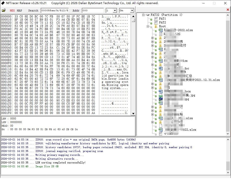

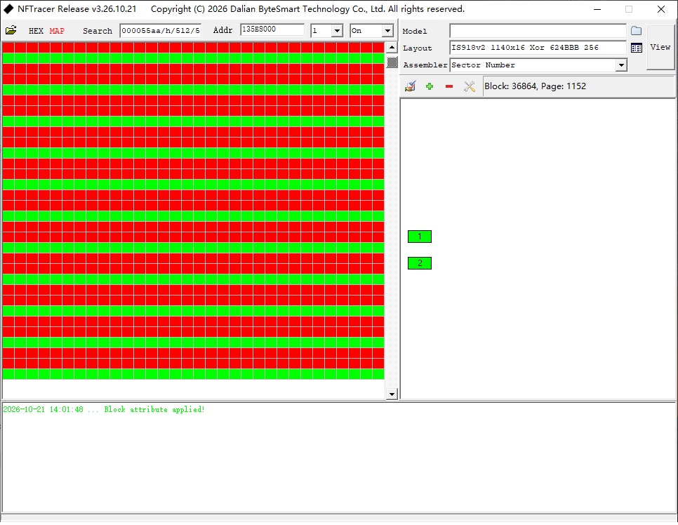

 Post subject: IS918 Original Firmware Table Analysis
PostPosted: Today, 2:32
Joined: April 9th, 2026, 0:03
Posts: 33
Location: china
Today we release a new build of Nand Flash Tracer (NFT), with the brand-new feature: IS918 original table data analysis.
Combined with the existing “Set Block Attributes” function, this new module delivers extremely high accuracy for IS918 dumps.
Manual correction of analysis results is almost unnecessary, matching the reading performance of the original controller firmware.
The upgraded algorithm reads raw original tables directly and accurately locates the latest valid data blocks with minimal user interaction.
It supports one-click image reconstruction.
1.jpg [ 546.12 KiB | Viewed 82 times ]
2.jpg [ 191.56 KiB | Viewed 82 times ]
3.jpg [ 216.17 KiB | Viewed 82 times ]
4.jpg [ 262.28 KiB | Viewed 82 times ]
5.jpg [ 352.35 KiB | Viewed 82 times ]
website: https://www.flash-tracer.com/
Users browsing this forum: No registered users and 31 guests
