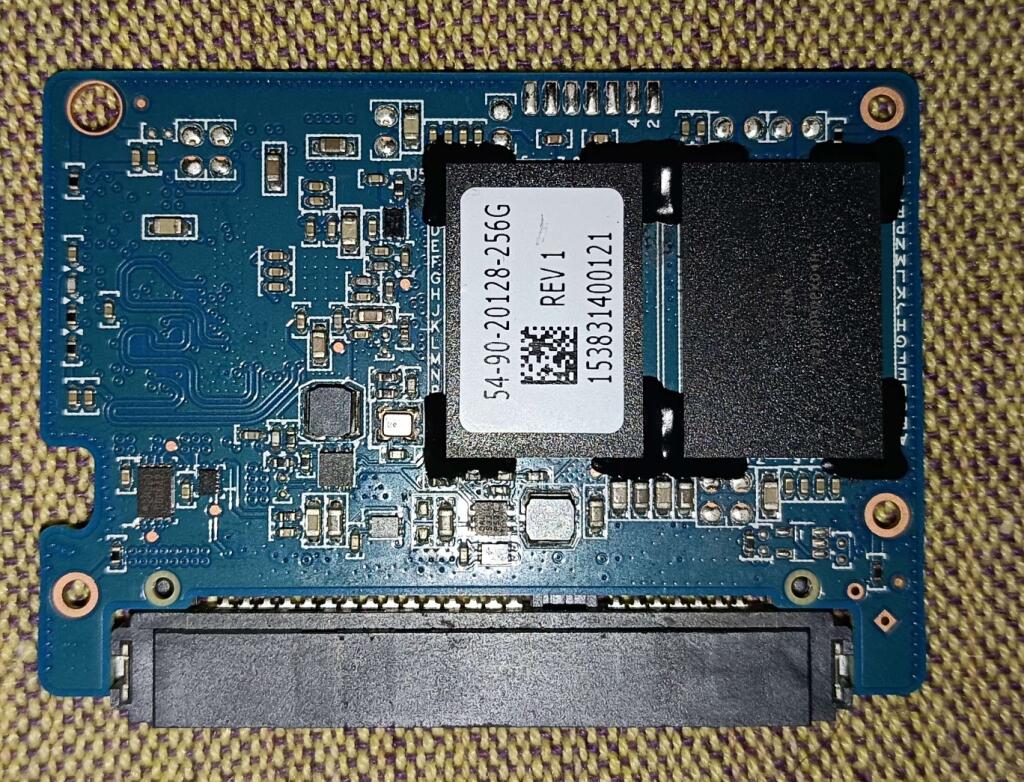

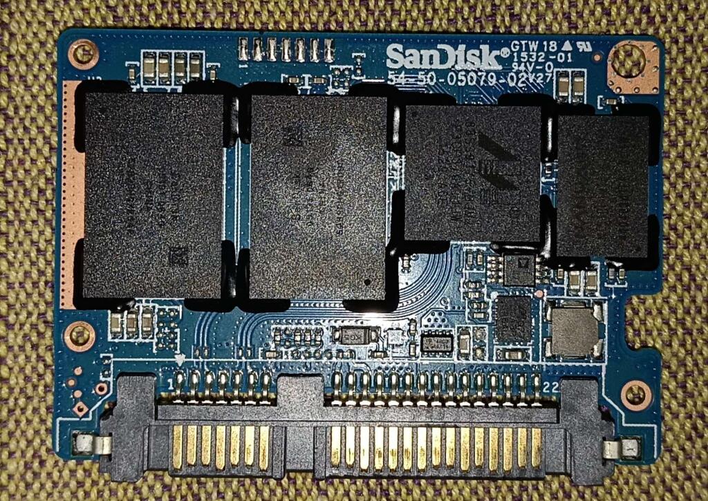

 Post subject: SanDisk X110 256GB (Marvell 88SS9175): FATAL FAILURE in STAR
PostPosted: Today, 3:15
Joined: Today, 2:53
Location: Cololmbo
Drive: SanDisk X110 256GB, SD6SB1M-256G-1022I, 2.5" SATA
Controller: Marvell 88SS9175, MLC NAND
PCB: 54-50-05079-02 (underside label 54-90-20128-256G)
Firmware on label: X231600
History:
I connected the drive to a Promise FastTrak 376 RAID card, and it stopped working. It reported about 80% health before that.
On a different SSD that was on the same card, HxD shows a “Promise Technology, Inc.” block 63 sectors before the end of the disk, so the card probably wrote something similar to the X110.
The drive is no longer detected. The BIOS (ASRock B75) freezes while waiting for it. It’s also not detected on a second PC or through a USB-SATA adapter.
I never formatted, initialized, or flashed it.
Console findings:
UART at 115200, 3.3 V, on the pads along the top edge. I read it with an ESP32, and the output is scrambled in the usual way.
With no SATA link, it repeats a “no SATA PHY” message about every 0.64 s.
With the SATA link connected, it prints one burst and stops. I decoded it by matching it against the HardMaster SD6SP1M log: a [FATAL FAILURE] dump, RTOS ErrNo 0x10A00082, RTOS Task ID [0x4 = STAR_4], module STAR_ErrorHandler.c. The values are approximate. (These are according to claude AI)
Questions:
Has anyone seen this fault on an X110 or Ultra Plus after a RAID card wrote to the drive?
Does anyone know the safe-mode pads for PCB 54-50-05079-02?
Does PC-3000 SSD (VanGogh) handle the 88SS9175 well enough to recover the data?
