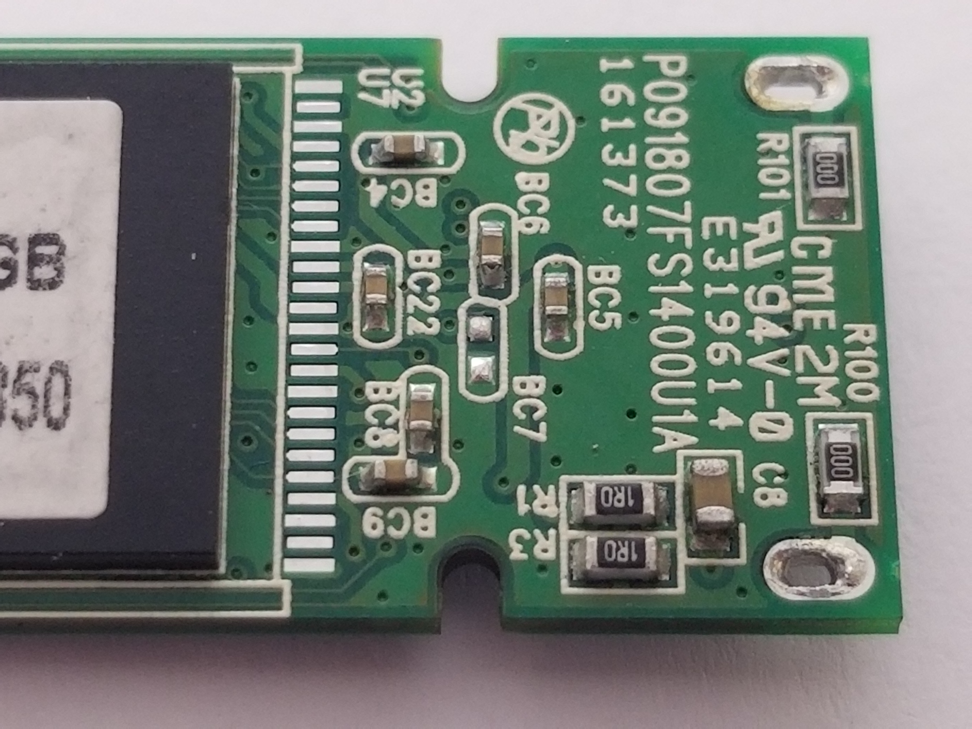

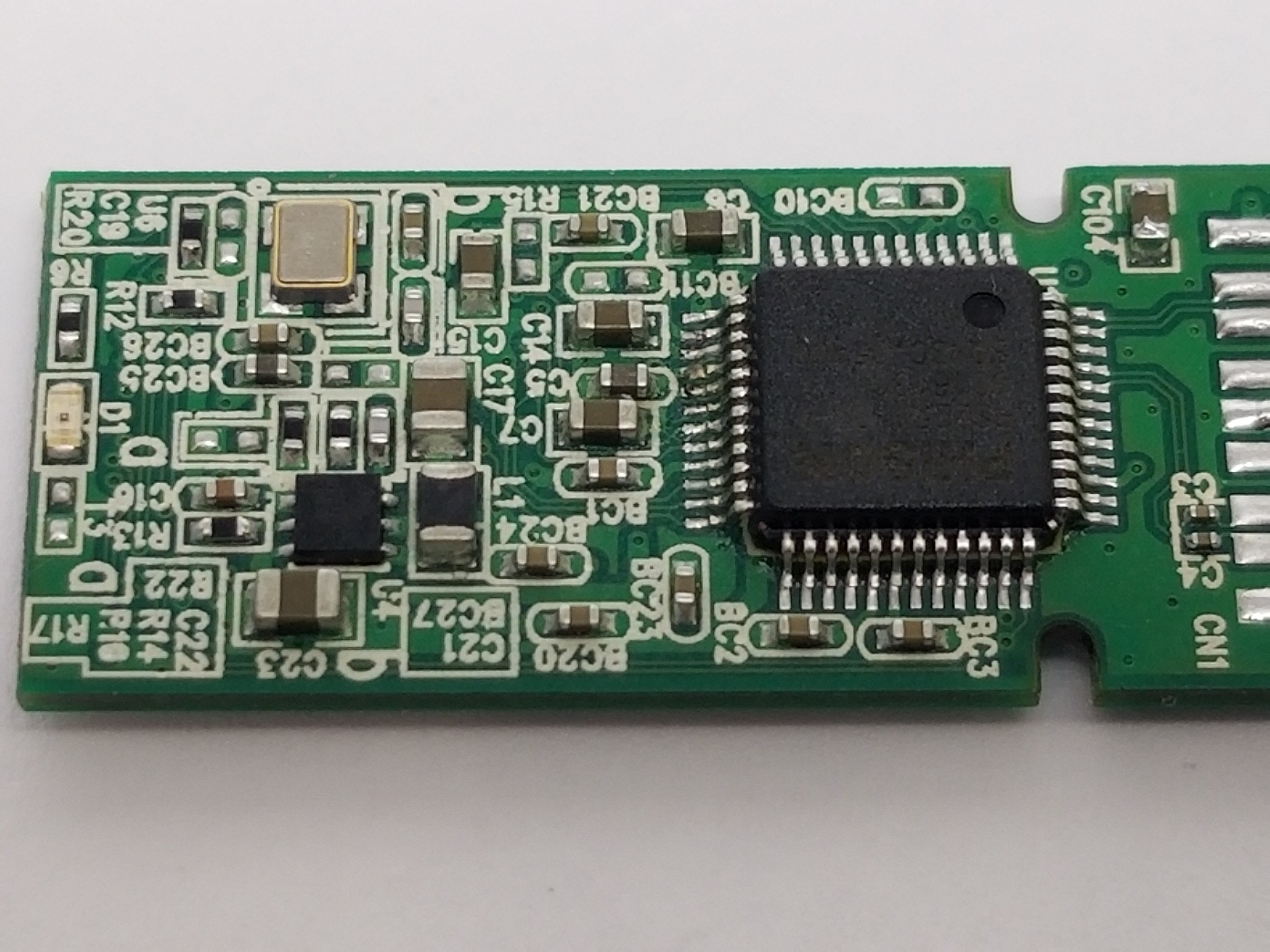

This flash drive had a broken connector. Board seems physically okay but still not recognized when connected. The LED does not light up. Caps test okay. Data lines to CPU have continuity. Would like some additional testing advice before completing a chip off.

Check the 2 "000" resistors for continuity, plug in and put tweezers over to make circuit.
also, is C8 sldered ok? hard to tell, may just be shadow on the bottom.
Sometimes BGA balls get lifed if drive was bent or stressed.

Zero-ohm resistors R100 and R101 appear to be connecting PCB ground to the metalwork of the USB connector. I can't see how they could possibly affect the circuit. Instead I'd be checking the two 1R0 resistors (R1 & R3, 1 ohm) for continuity.
I'd also confirm that the crystal oscillator (U6) is oscillating.
U4 appears to be a switchmode regulator IC. I expect that the junction of L1 and C17 would the Vcore supply for the flash controller.

I would also try removing/re-soldering the micro-controller. If the drive took physical damages (broken connector), it's possible that some of the pads beneath the IC legs have cracked. Removing the controller will allow you to see if the pads are in good condition. Any damaged pads can be repaired.

Resistors do show continuity.
I changed out the crystal just to make sure.
There is no voltage at the junction of L1 and C17 (also no voltage to the LED) so that area could be our issue.
HaQue wrote:
Is C8 sldered ok? hard to tell, may just be shadow on the bottom.
Yes that is okay, just a shadow.
While I have not removed the controller, I checked the pads under the microscope and tacked them all down again.

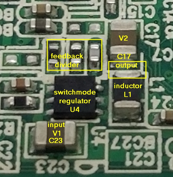

Can you tell us the markings on U4?
Can you measure the voltages across C23 (V1) and C17 (V2)?

I had one that passed the microscope inspection but when I lifted the controller, the pads lifted with the IC. Sometimes the damage occurs at the junction between the trace and the pad and these can often be underneath the IC. If everything else looks good, then lift the controller to rule out all possibilities.

Markings on U4 is ETC
V1 - 0.303v
V2 - 0.v

It appears that U4 (RT8010) is not getting an input voltage (Vin, pin 3). We need to find where Vin is coming from. I suspect that the flash controller may be reducing the USB +5V input to +3.3V via an internal LDO regulator. Then this +3.3V supply would be applied to the Vin pin of U4 to generate the controller's Vcore supply.
I would confirm that +5V is present at each end of resistors R1 and R3 (1R0). I would then use the multimeter's continuity function to determine which pin of the controller is connected to the Vin pin of U4, if any. If the controller is receiving +5V but is not outputting +3.3V, then it would be suspect. Alternatively, U4 could be powered from the +5V input, so I would test for that possibility as well.
RT8010GQW, Richtek, 1.5MHz, 1A, High Efficiency PWM Step-Down DC/DC Converter, 2.5V to 5.5V input, marking ET, adjustable:
http://www.richtek.com/assets/product_file/RT8010=RT8010A/DS8010A-10.pdf
R1 and R3 - 0.25v
Controller pin voltage from U4 is 0.3v
We definitely seem to have a power issue.
