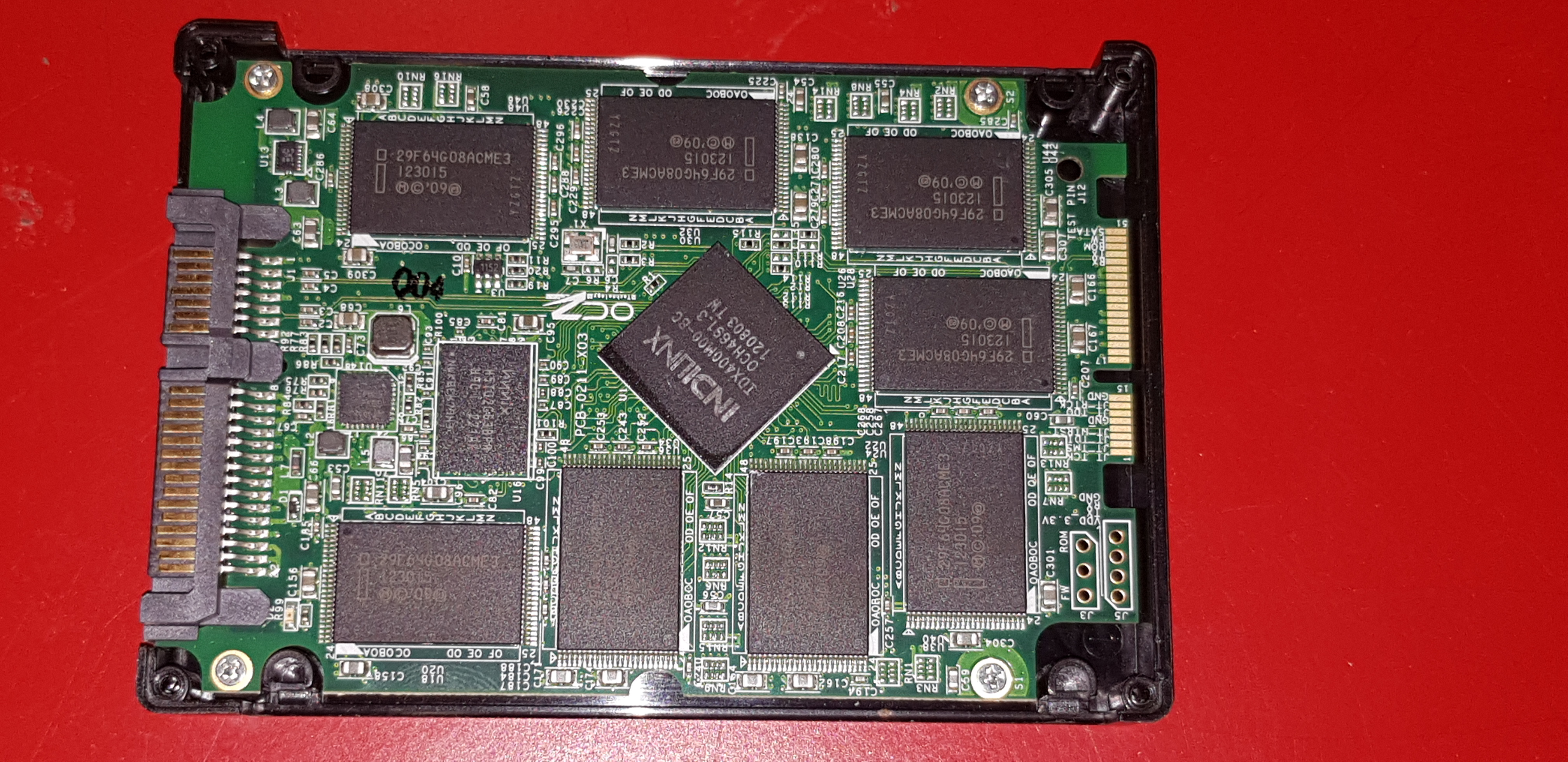

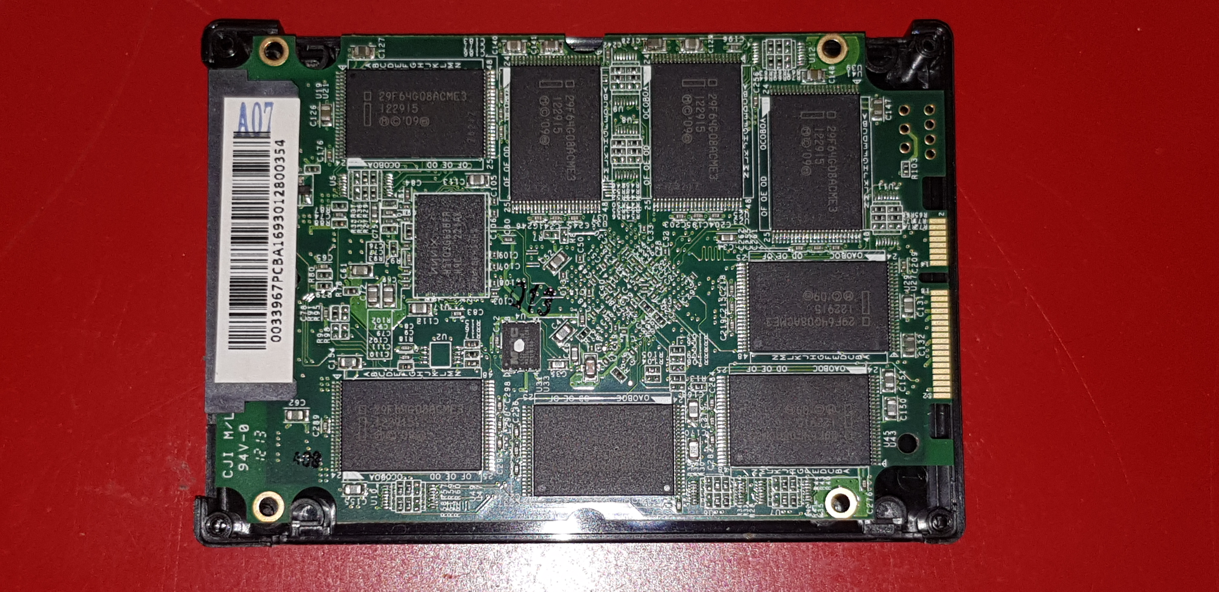

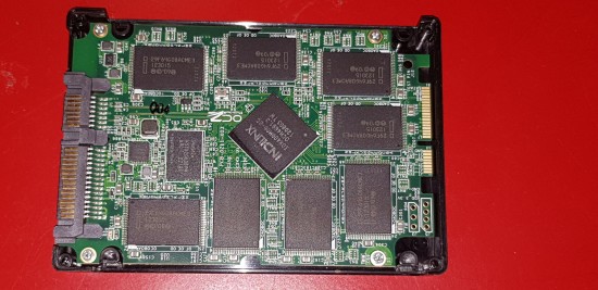

So, as you probably guessed from the title, I have an OCZ Vertex 4 (128Go) which is 8 years old, I had it brand new. The other day, I was just on my desktop, double click a game shortcut, and after three seconds, I got a black screen and an automatic reboot.
On the said reboot, my computers tells me that it failed to find a bootable device. My only OS is on my ssd. After a few checks I’m sure that’s the SSD fault. I took the SSD out of my computer and tested it on an external sata reader which I know works fine. The SSD is not recognized with this method, nor in the disk manager, nor in the BIOS of my computer. So I obviously got a problem with this SSD.
I had nothing extremely important on this disk, however I have some files I would like to have back. That’s why I’m here today, seeking help to at least have a diagnostic or even (I can dream) find a fix just to have some quite important file back
I add to this post photos of both sides of the SSD’s pcb (I tried my best on the quality with my non-cooperative cellphone). I have a multi meter and I’m willing to do any measurement as long as it doesn’t compromise my data. I don’t send to any professional now because with everything that happened covid-related, I’m very tight on money. But at the end if the only solution is for example to read the data directly on unsoldered chips I’ll go for it with a professional. One last thing : I read on some other topics about this same SSD that there should be a led, and I don’t see it (at least no lighting). Is this the component labeled C2 next to the sata/alimentation connectors ?

File comment: Back of the PCB
File comment: Front of the PCB

Take some continuity measurements around D1 and L7, C128 (other side) looks a little funny too. D2 top left looks like an LED.
Anything getting hot.
Can't do chip off on most SSD if it's anything more than a blow component you're going to need a pro.

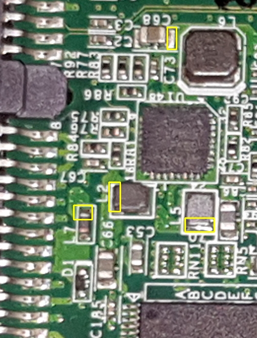

Measure the voltages at the highlighted locations.

With the SSD disconnected from power, measure the resistances between ground (eg a screw hole) and each of the marked locations. Do this on the 200 ohms range of your digital multimeter.
This procedure is perfectly safe, and your results will tell us if any component is shorted.
The voltage measurements in my previous post need to performed with the SSD powered on. Don't bother with these until we have analysed your resistance measurements.

So I did the measurements you asked for. At least I tried my best, I might have to invest in some thin measurement pin as the traditional one are quite big compared with the size of the components. Here are my results, if some seem odd to you, let me know, i'll do them again.
L4 difficult, between 0 and 4 Ohm (shorted ?)
L5 strange behavior goes up to 40 MOhm and down (shorted, error from me ?)
L3 90 Ohm
L2 14 kOhm
L7 39 kOhm
Thank you !

The supply at L4 does appear to be shorted to ground. You can confirm this by measuring the resistance between the ends of the adjacent capacitor (C64).
Your next task is to find out which chips are powered from this supply.
Choose one of the NANDs (29F64G08ACME3) on each side of the PCB and test the capacitors adjacent to it. Do the same for the Indilinx controller and Hynix SDRAMs.
If the readings are unstable, you can scrape away some of the PCB lacquer from the solder joints with your probe tip.

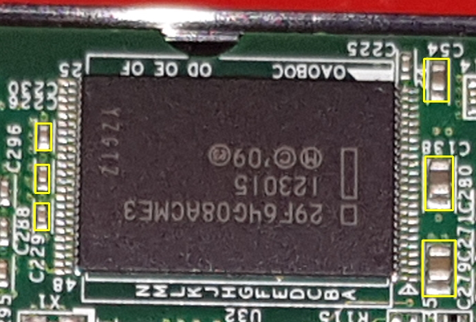

As for the chips, they are surrounded by tiny capacitors with circuit references of the form Cnnn. You need to measure all the Cnnn components. There will be many which will test as short circuits. Measure the resistance of each Cnnn by attaching your probes to each end.

I did the measurements you asked for :
memory 1, photo 1, bottom left
C301 0
C304 0
C257 0
C268 0
C258 0
C267 0
C60 0
memory 2, photo2, top right
C176 0
C126 0
C127 0
C186 0
C177 0
C183 0
C113 0
Indilinx
C217 0
C208 0
C216 0
C198 0
C193 0
C197 109k
C57 0
C252 0
C243 0
C253 0
C87 0
C88 0
C89 0
C90 0
c95 0
C6 0
c7 0
Hynix SDRAMs
C86 0
C87 0
C88 0
C89 0
C90 0
C99 0
C100 0
C82 0
C96 0
C95 0
C81 0
C85 0
C93 0
C92 0
C91 0
C71 (next to C92) 55k
I reamesured L5 following you advice, it's 105kOhm
If want me to verify one of this measure, just tell, as well as if you want some other.
