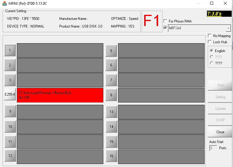

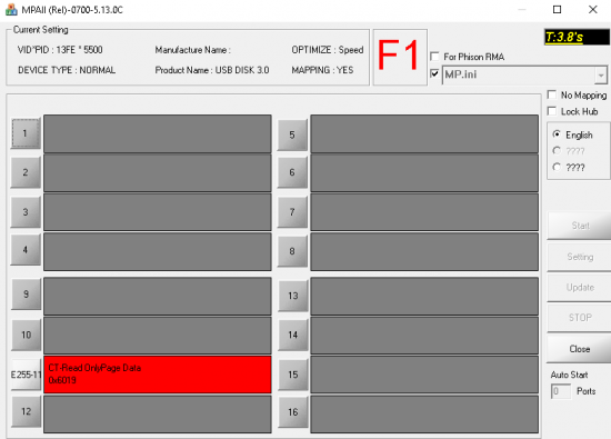

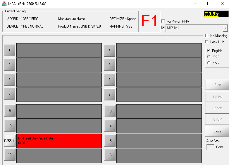

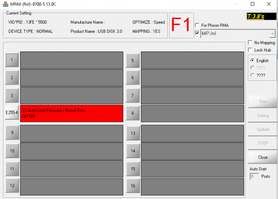

What Firmware does i have to use? I tried in the Auto ISP and gave me the same error of CT-ReadOnlyPageData.

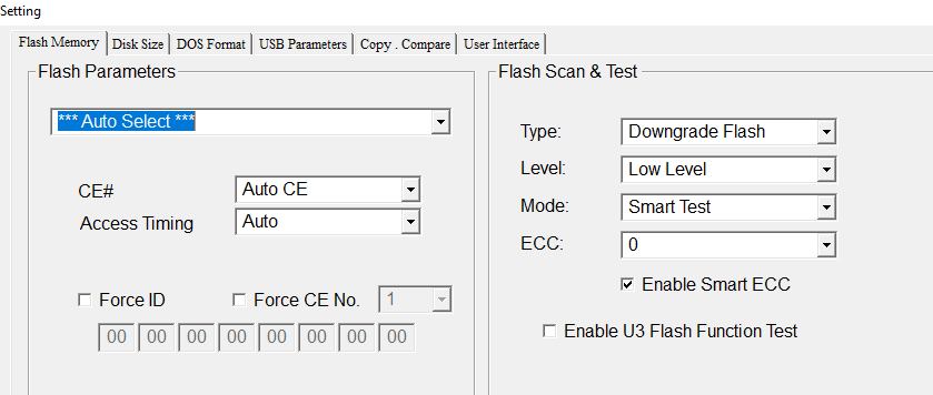

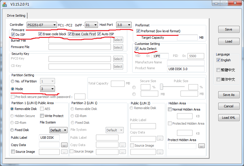

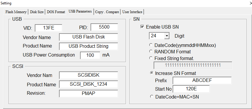

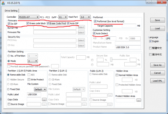

Try this configuration:
Or switch to test mode.

It gave me this other error, So ¿How i can switch to test mode?

This should help. Just remember to set it up as shown in the image above (except erase first).
I don't see any point in switching it to test mode yet—it's already in ROM mode. You need to choose the right utility (or bin and fw).

Yep, I tried that and is the same result, (From the image of Auto Burner and Firmware Error) And idk what is the correct BN and FW files. :(

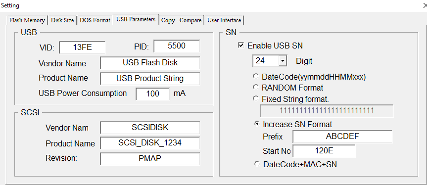

I got an error with these settings, thus i think its a compatibility error.

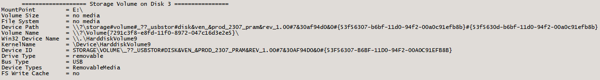

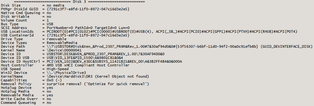

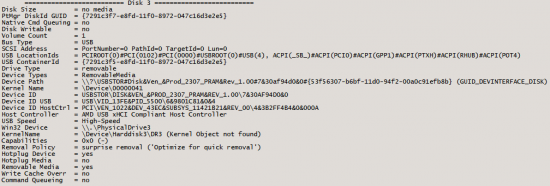

So, if the USB has no vital data does that mean its no longer recoverable? (Here is other data related to my USB, With the UsbDriveInfo Software)
 Post subject: Re: I have a problem with my generic Phison USB.
PostPosted: January 24th, 2026, 13:14
Posts: 347
Location: Eastern Europe
OS information is useless for repairs. Then GetInfo.exe is better.

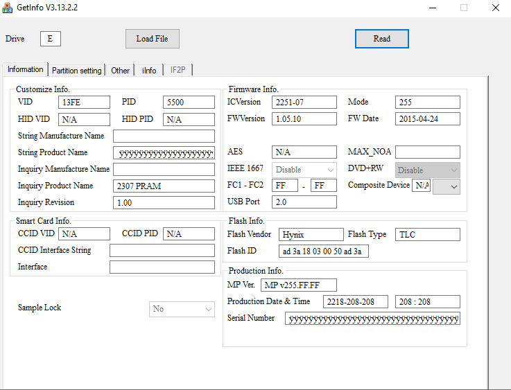

Now all that's left is to try UPTooL...
https://www.cryptoprofi.info/?p=18268
For PS2307 and Nynix TLC, the only online queries are for MPTool resources. I haven't found a solution.

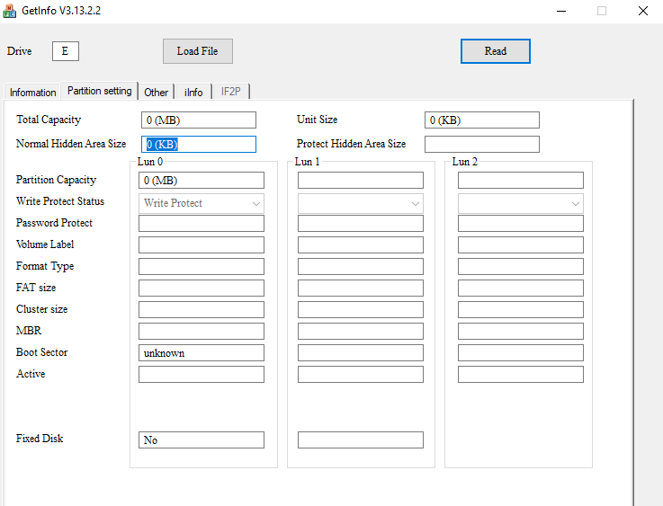

Wow :shock: I had never heard of UPTool before, I tried it, but it doesn't seem to be compatible with my USB (I say this because the message appears in red, and when I click “START,” nothing happens). And about GetInfo, here are some images that may be useful.

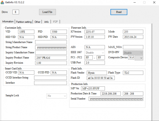

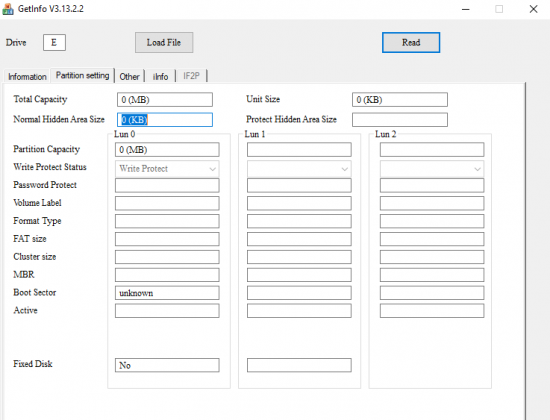

:oops: , My bad! I'm sorry, Here is the actual info of GetInfo

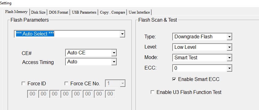

SWM wrote:
I wonder what this one will write.

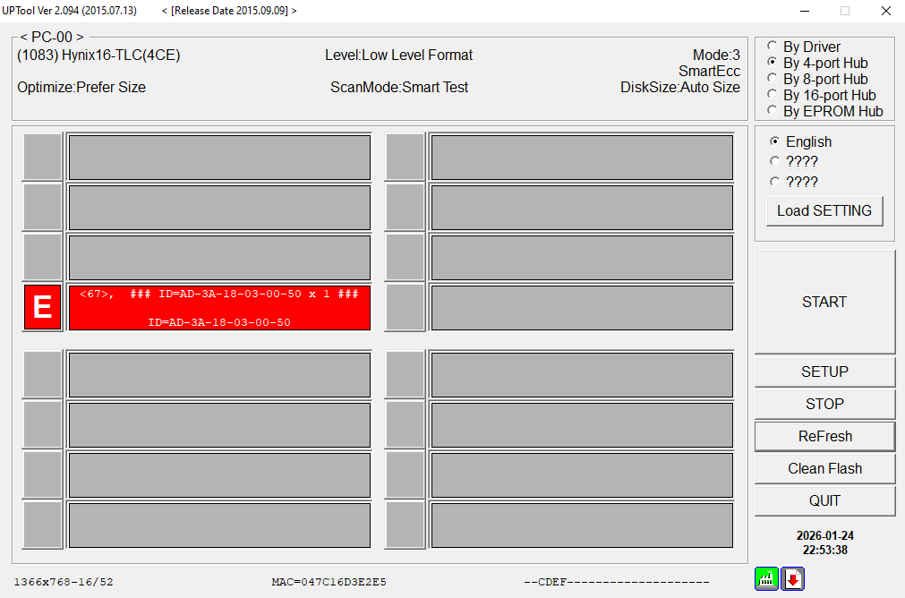

The blue text appears, So is compatible with the USB, but when I click "START", the program closes automatically after 5 seconds, I think it's because the configuration by default, is not the same as the USB (I think so).

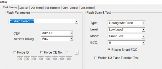

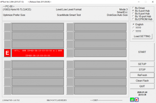

SWM wrote:
Unable to find complete information on the memory chip... Last option...
When I run the process with this version of the program, I get this errors and the Windows warning that appears when the device is not detected, and I notice that the USB automatically disconnects every time I try to flash. I'm already giving up on this USB... :cry: :weep:
