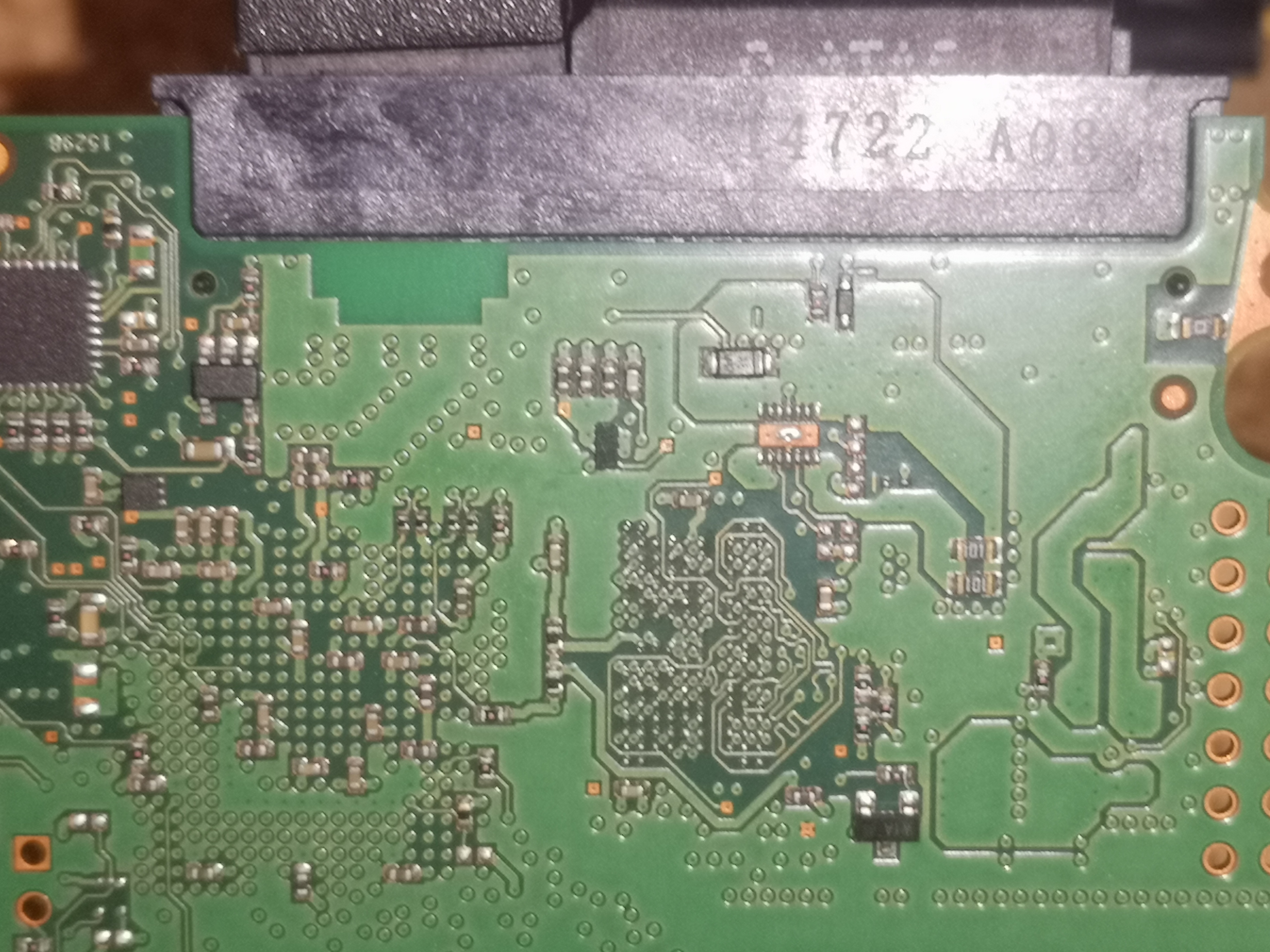

Good day!
On donor board there are "54Y6ZI" chip at the same place, as "48H6ZI" on original board. On donor there is another "54Y6ZI", but on original board at the same place is "4C56ZI". I`m thinking it`s the same purpose chip, but don`t know what it does.
Also I repaired broken trace near 25211 and all voltages got rised:
5505VIN=5.2V
Storage caps voltage (pin 10) went up to 12.7V
Input voltage on all regulators also increased to 5.2V - as input voltage from SATA.
But PC still doesn`t recognises SSD... :(
It looks like all is stuck at the software or something like it...
Looks like I have to return original flash and MPS430 chips back to original board and hope that it will help.

I still can't identify that mystery part, but I suspect that its markings may be encoded as follows:
    1st char -> year of manufacture
    2nd char -> week
    3rd -> batch/country code
    6ZI -> device code
Congratulations anyway.
Edit:
FWIW, the TPS22920 load switch has a part marking of 6Z and comes in a DBGA package. However, its input voltage range is limited to 3.6V.
http://www.ti.com/lit/ds/symlink/tps22920.pdf

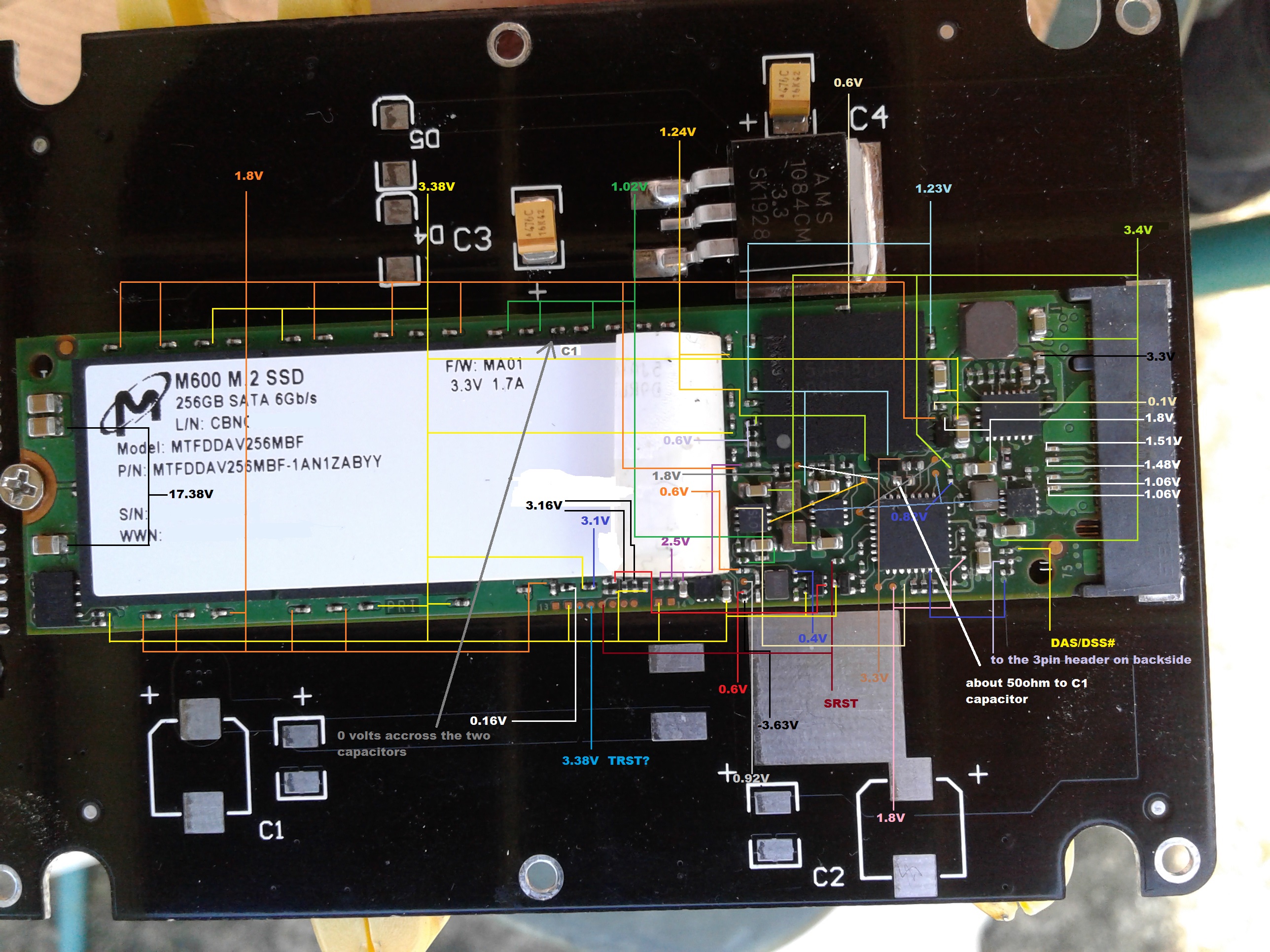

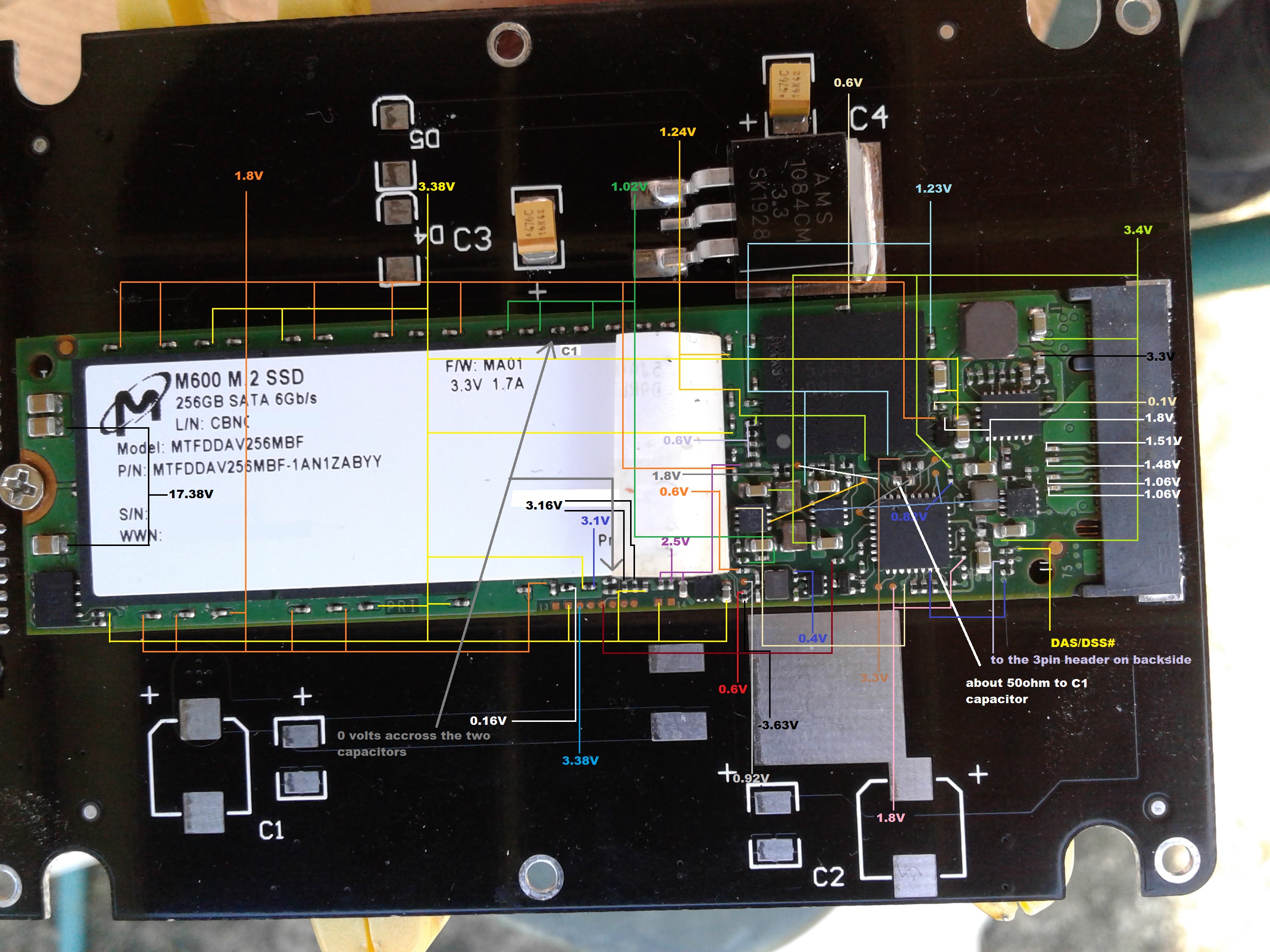

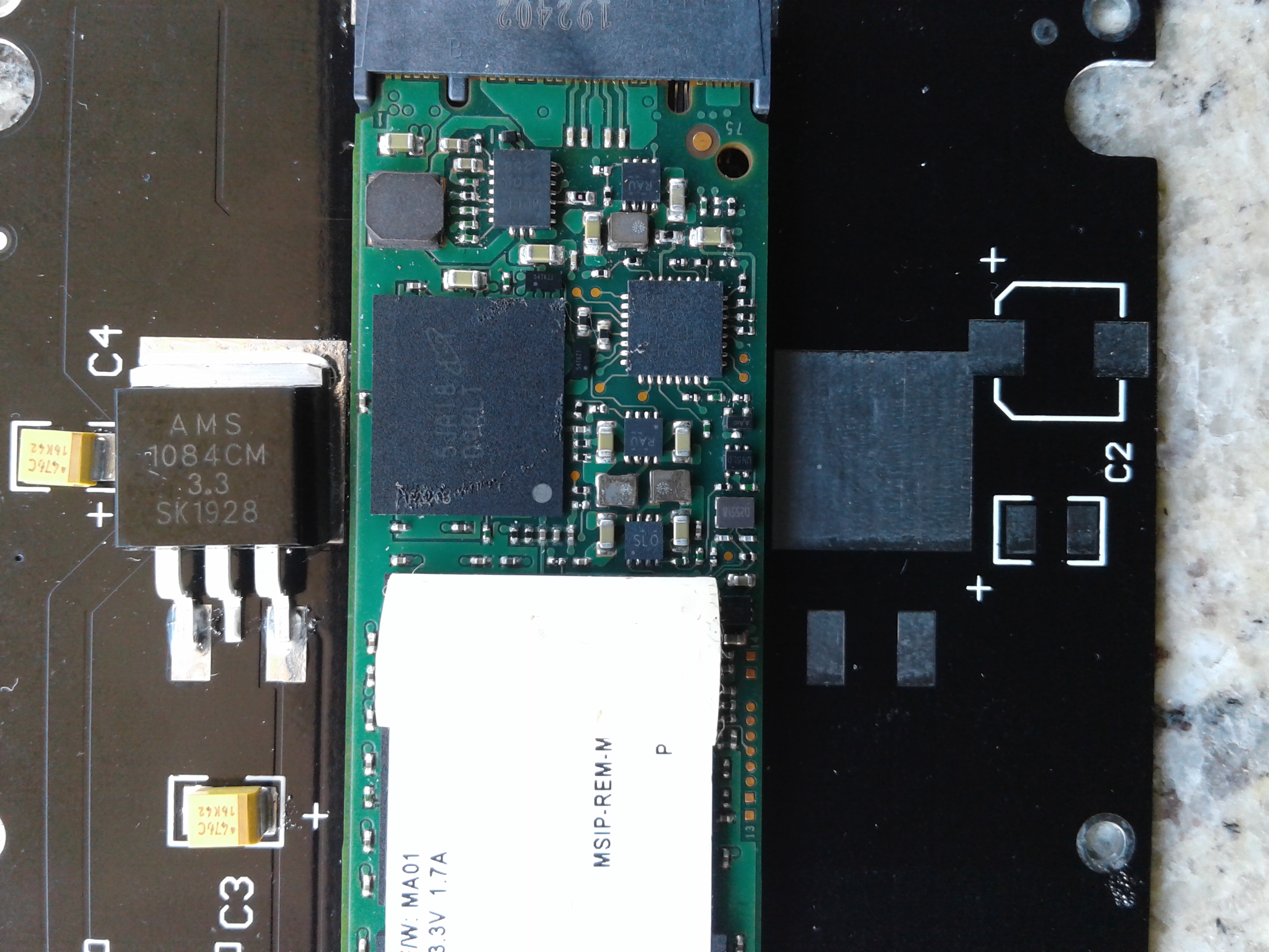

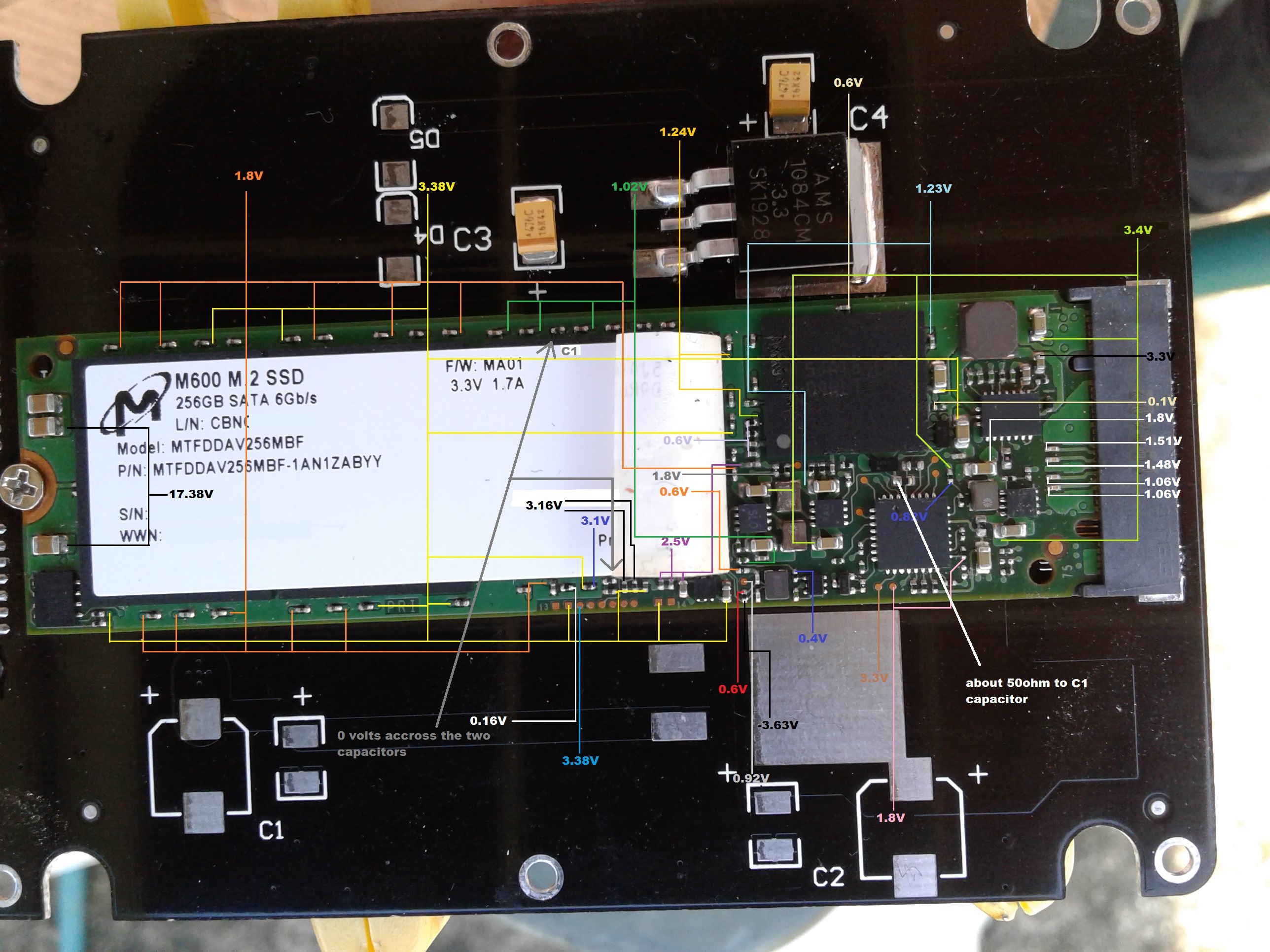

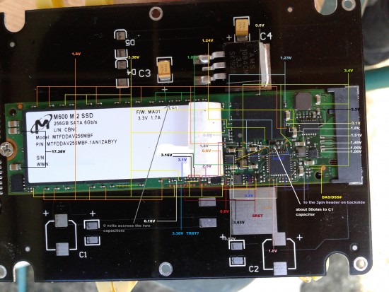

Hello
Have a broken m2 drive Micron M600, detected by system, show as uninitialized in disk management, cannot initialize or fix MBR.
Made a measurement with DMM, there is 0 volts across two capacitors, unsure if they are blown or something else in circuit.
Also suspicious look the SATA line voltages, the measurements were done with only power connected to drive.
Any suggestion, what to start replacing?

ISTM that all the supply voltages are OK (3.3V, 2.5V, 1.8V, 1.2V). It's looking like a firmware fault.

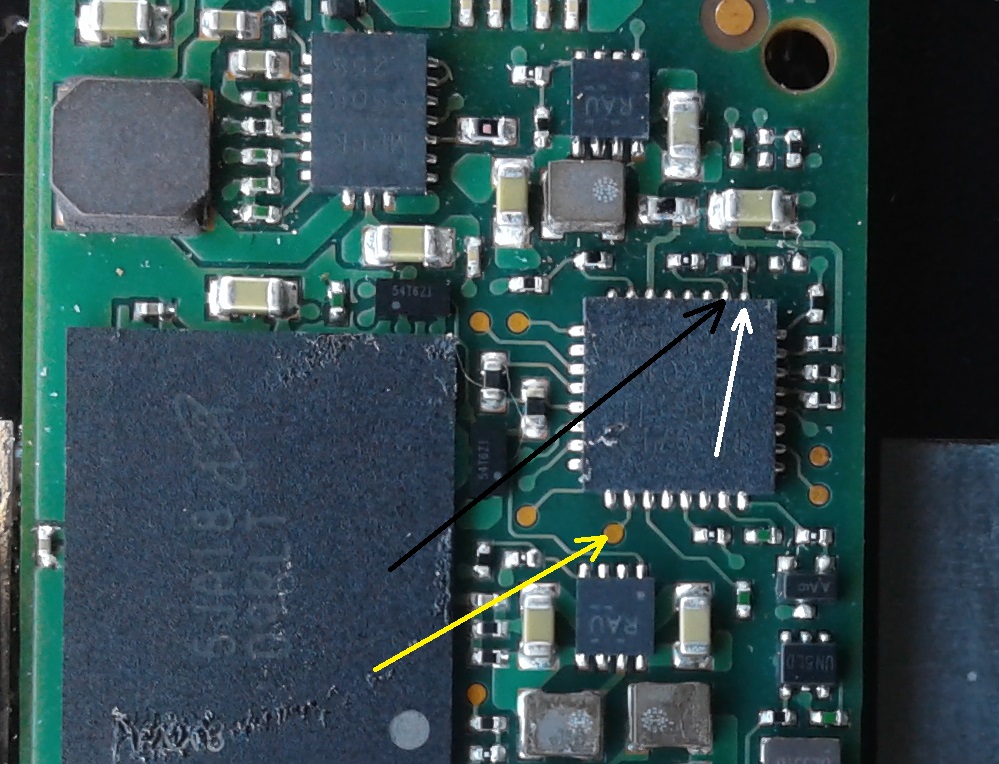

it is what i thought too at first, but i'm not so sure anymore, few hours before i noticed the drive failed a small screwdriver was dropped on the mainboard just above drive area while the system was on. continuity test with DMM is giving a beep on C1. also measured about -0.01V to -0.06V on few resistors nearby MSP430. this leaves me under impression part of the SoC is not initializing.
do you know what voltages should be on MSP430 pins? it is MSP430V402, looks like it is identical to MSP430G2353 as the latter one is also used in this same drive model according to this review image

thought the same at first. small screwdriver was dropped on the mainboard above ssd area an hours before it would no longer boot (haven't noticed immediately because hdd was used for windows). 0 volts across capacitor sounds like a hw problem, DMM beeps with probes on the cap, reading 50 in continuity test, couldn't find other component in parallel with the cap... MSP430V402 looks like is identical to MSP430G2353 (is linking photos from other site not allowed, since my reply was submitted for moderation and it wasn't posted?)

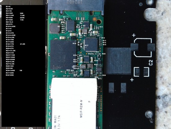

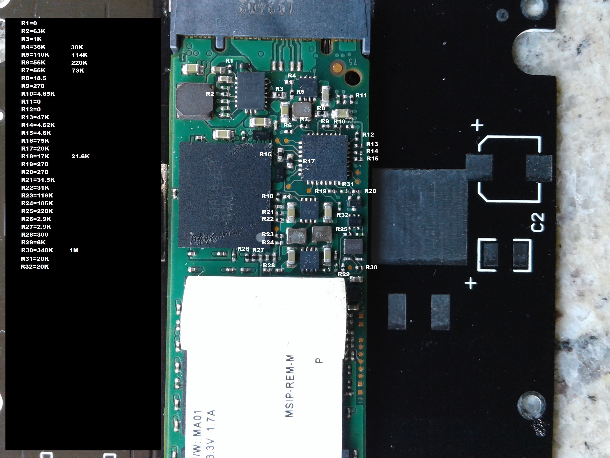

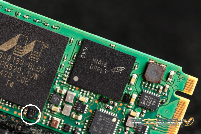

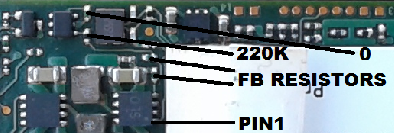

anyone know which part number is the marked 6pin IC? cannot see the reading on mine, it looks like MX100 drives have them too
 Post subject: Re: Crucial MX100 repair after PSU failure
PostPosted: July 19th, 2020, 10:07
Joined: June 27th, 2020, 8:58
Posts: 60
Location: europe
ok, missed that this IC was identified as on the image

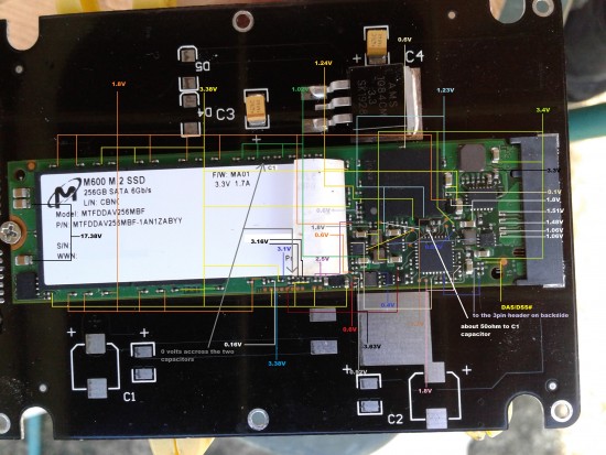

IN to C1 cap give only 56ohm, while GND to C1 give 50ohm, is that good?
next, these voltages, pin pointed with black arrow (XIN) was always 0V, pin pointed with yellow arrow would measure 0.6V and then dropping fast to as low as 0.08V
pin pointed with white arrow (XOUT) was 1.8V, i made a mess somewhere while measuring voltages, it is 0V now and disk size is no longer detected in OS (SATA errors)
replace MSP430?

R19, R20, R31 have been lost as well as resistor next to R18
R19 and R20 replaced with 100ohm, R31 with 22K
i took off R4 and R5, put R4 next to R18, and in place of R4 22K, R5 67K
C1 from voltage screenshot also lost, no idea if it is 220nF or maybe 1uF, installed there 330nF. it appeared at first this C1 had connection to one of resistors on the bottom side of the CPU, but there was something wrong with this (maybe because of shorted CPU?) as it now appears not to be connected to the same resistor. this is in fact a single line under the CPU bypassed to GND. either way still no voltage on it even though the resistance is not in low 50ohm range anymore
in windows it is installed, then disk management prompts to initialize it and fails with I/O error. no idea if it has anything to do with the D9RLT memory, is this chip powered via 3.3V ?
I/O would look like SATA interface, it looks like differential voltage there is OK. and if this was bad there would be no any kind of information from the disk provided to the OS, like FW version, right?
so it is internal I/O problem

when i first looked up reviews for this ssd some of the sites incorrectly decoded D9RLT part and result in digikey showed operating voltage such as 1.8-2.5 V
now i found correct part and digikey specifies it as 1.13-1.30V. good thing i did not experiment with 1.4V feedback resistors and took the correct one from 1.8V divider

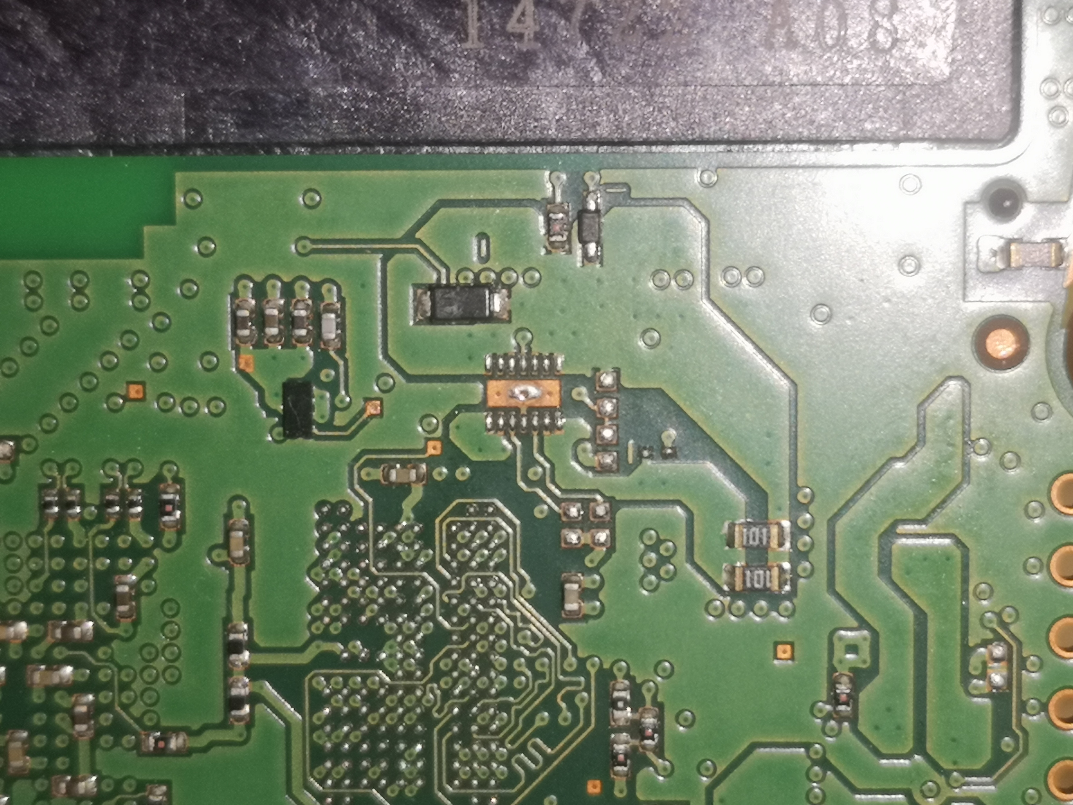

I'm wondering whether two of the enables are buffered by the "CV" chips. If so, then the "A" inputs would come from the MSP430, and the "Y" outputs would go to regulators.
http://www.ti.com/lit/ds/symlink/sn74lvc1g07-ep.pdf
what does it buffer on my disk ? Y output goes through 220K resistor to FB pin of SLO chip while A input comes from CPU i guess ? the component inline to A pin appears to be shorted. i did not measure it initially as i thought it is capacitor but there are resistors in colors too on this board. if it's not suppose to be 0ohm then it's definitely busted. 0V on it
the marking of the chip is UN5LD, at least GND VCC and NC pins do correspond to TI part
PostPosted: April 23rd, 2024, 15:53
Posts: 16955
The pinout in the "Typical Application Schematic" on page 1 of the SLO and RAU datasheet is deceptive. The actual pinout is on page 4 (Pin Configuration and Functions).

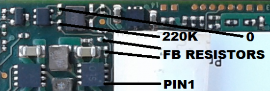

correct. and there is no mistake here. does it make sense that since this is partial-power-down IC (devsleep or similar) the input should come from CPU and the voltage should be present only when drive is in suspended state? if yes what it's output does to FB divider, reduces voltage?
PostPosted: April 23rd, 2024, 20:34
Posts: 16955
If 220K is paralleled with the bottom leg of the divider, then the output voltage increases. If the output of the UNxxx chip goes high, then the output voltage decreases. I've seen this kind of arrangement in standby circuits. ISTM that your circuit is producing the highest voltage that it can, in which case I can't see that there is anything wrong here.
