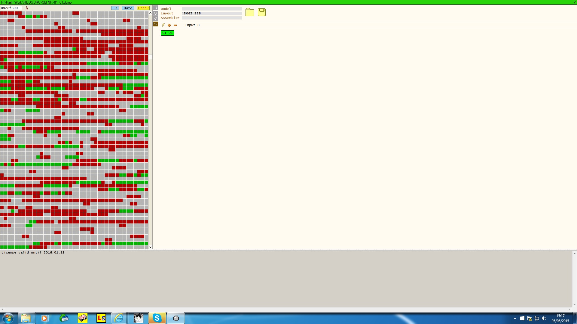

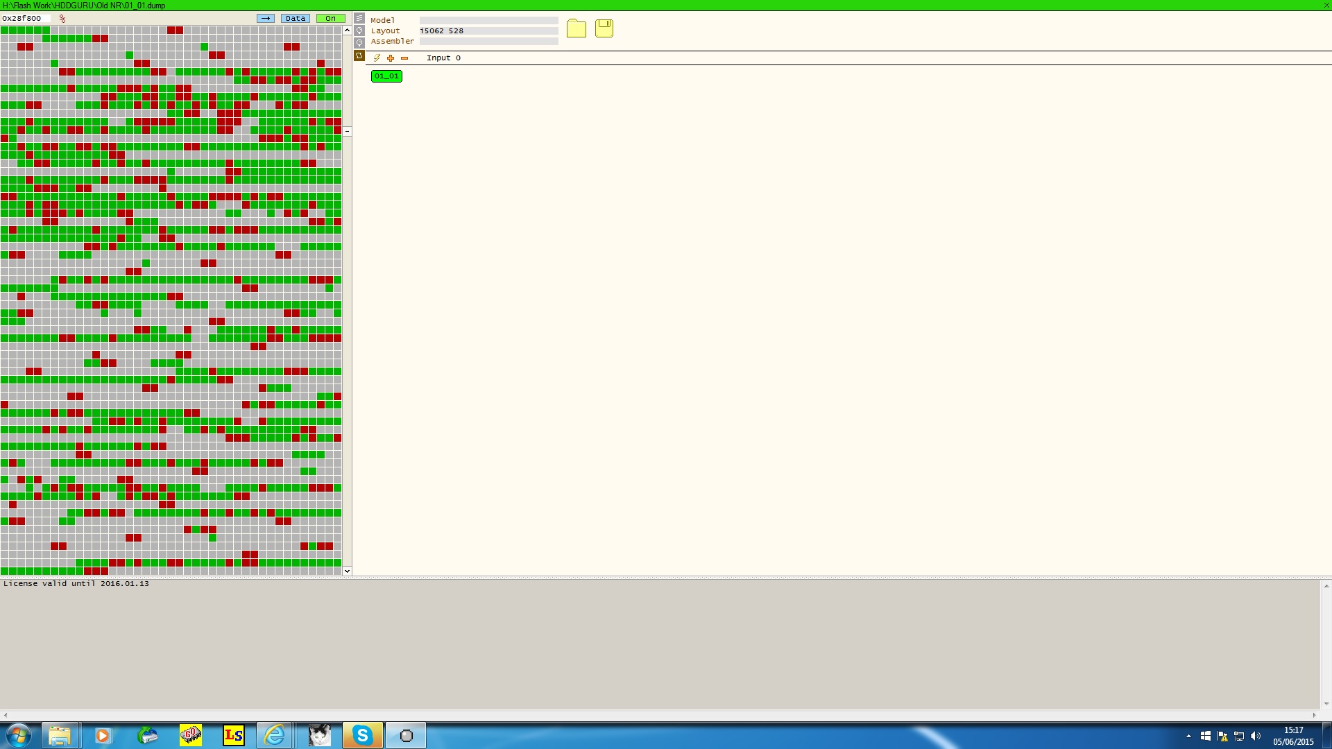

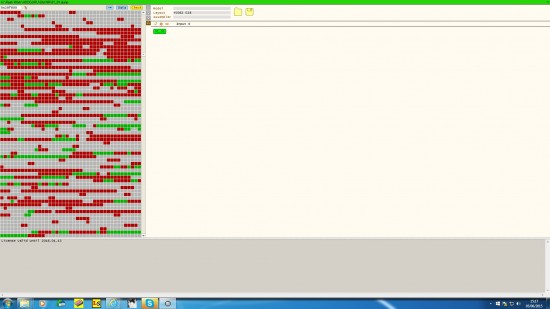

Think I have managed to find ECC coding for this chip.
Here's a map with ECC=CHECK...
 Post subject: Re: Help needed - Serious challange with this one
PostPosted: June 5th, 2015, 10:13

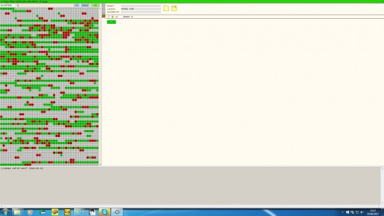

And the same page with ECC=ON...
As you'll see, good but not perfect :-(

Multiple readings at slow speeds produce 100% identical dumps.

@pcimage, I assumed that your uploaded 01_01.dump file was an error corrected NAND dump. Is this the case, and if so, are we to understand that it includes data errors, as suggested by your latest screenshots? Otherwise, could we see the raw uncorrected dump?
ISTM that you could, in general, determine the ECC algorithm by testing it against a zero-filled page (0x00). AFAICT, the first 6 bytes of each page are the ECC bytes for that page. In the present case the corresponding ECC pattern for a zero-filled page appears to be 5B 00 C8 05 91 08.
The SA for pages 0 and 1 of each block appears to contain the FTL and wear levelling information in bytes 8 - 15. I have used SA bytes 8 & 9 of page 0 to build the logical-to-physical block map. Any block whose logical block number is 0x8nnn has been treated as free, as have the 0xFFFF blocks. I know that there is something missing in my logic, but I can't see it.
Bytes 6 & 7 of each page appear to reflect the page "type". There are 3 values -- 0x5555, 0x0000 or 0xFFFF. Are these values added by the error correction processs in the data recovery software, or are they as they appear in the original uncorrected raw dump?
SA bytes    page
06 & 07   frequency
0x5555        20821
0x0000         1426
0xFFFF        10521
Total        0x8000

I didn't do any correction in the uploaded dump, it's entirely possible that FE has misinterpreted the ECC in this case and it's a red herring.
IIUC, your disk.image reconstruction and recovered files are based on the same raw, uncorrected dump, in which case the OP's machine would be running on an uncorrected version of NK.BIN. The size of this file (4740883 bytes) corresponds to 960 sectors or 290 blocks. That's about 30% of the capacity of the flash chip. Moreover, I compared your dump against the OP's original PC3K dump (after removing the SA bytes) and found a massive number of bit differences, yet you have found that repeated reads produce 100% consistent results. That seems very strange to me.
If I were testing the ECC algorithm, I would start with a known good zero-filled template (pages 0,1,2 of logical block 0x0000) and make various single-bit and 2-bit changes to both the data area and the ECC bytes.
