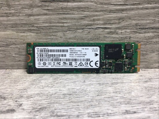

good. thanks for confirmation. so nothing wrong here, but there is definitely something wrong elsewhere. "C1" capacitor which is not a capacitor, but resistor
i looked for photos around and found a good one. it also explains why i measured negative capacitance one time before i lost it

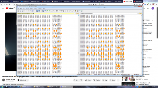

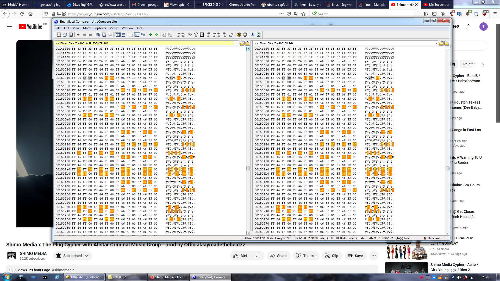

next i change BIOS again to the one drive initally tried to reconstruct, and on first boot both crystal pins are good at 0.63V, however 0.92V pin remained at 0.64V - it seems that one of these tables in BIOS contains CPU config register, and with wrong values sets up hw incorrectly.
not knowing enough about the BIOS structure i suspect on table at 0x150000, because if i flash dump that would boot drive to "unallocated" state quick, after messing with MU03 loader, this code gets overwritten with same values each time, boot is slow takes several restarts to get the drive detected in disk utility, in general unstable and unpredictable behavior. likely the MU03 loader looked for data at different offset and fooled the CPU somehow

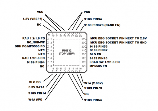

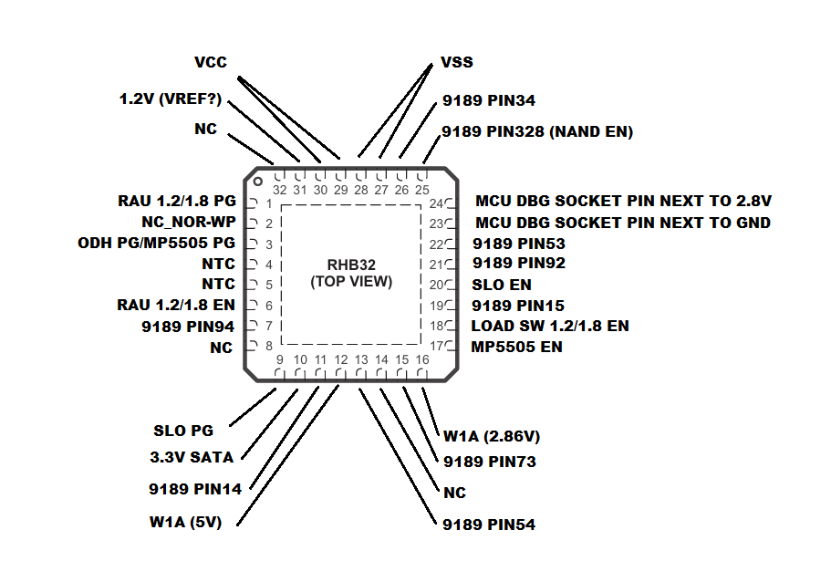

i just don't believe what am seeing with this device right now!
thought at first, a small transistor on msp pin16 is a supervisor to reset the mcu. one of its pins is on gnd, another 3.3V. so if it failed the msp would stuck in reset mode which would explain missing voltage on its other pins. but the transistor looks fine, same reading as when i soldered it a while ago.
then came the idea to re-check dram, and at the same time load switches since they are right next to it and one of them gave me problems in the beginning. a small 'resistor' on msp pins 4-5 as well since its shape looked more like a capacitor or bead. turned out to be NTC.
if the above suspect pin on msp had anything to do with reset the culprit would be on 3.3V so i check all the resistances after removal of components, and immediatelly caught my attention is 3.3V after the 5505. used to be around 78kohm, with removed parts went down to 25kohm
no problem, it will go back when parts are soldered again. checked dram, everything as before (680-710mV on DQxx, lower on power pins)
check load switches, both are the same - 0.5V to output, 1.7V to gnd, 1.4V to enable. cleaned them and put on 0.3mm balls
soldered everything. 3.3V after 5505 remain at 25kohm. i'm thinking either something made no connection or there was short under load switch.
already tired of this, i decide to just plug it in, holding fingers on nand and controller chips, if it starts burning i'll unplug it.
nothing. heats up slowly and boots slowly just as before.
check voltages, surprise, there is no longer 3.38 or 3.4V, it returned to standard 3.3V, 3.32V on msp pins (probably input too)
what the fuck did i just do i have no idea, by just removing and soldering few components back, to have Vcc fixed into normal value.
even more strange, before anything was touched (after initial failure few years ago) there was already 3.4V and i did not replace anything today, out of a sudden it is 3.3V

zzattack wrote:
My bad, I should clarify: the 4 enable pins all trace back to different pins on the MSP430.
i don't think so
msp430 does constantly communicate with 88ss9189 - there is this dump telemetry command and i think it's related to msp430
