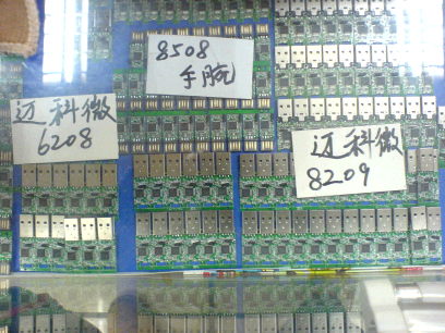

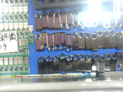

Well i said i was going to SZ on the 7 NOV....... ( my undercover video did not come out (mainly legs and i nearly got my head cracked open by security)), but i got some 'stills'
Pssst... ya want any bare board controllers (or knock off Kingston/Sony kit....)
