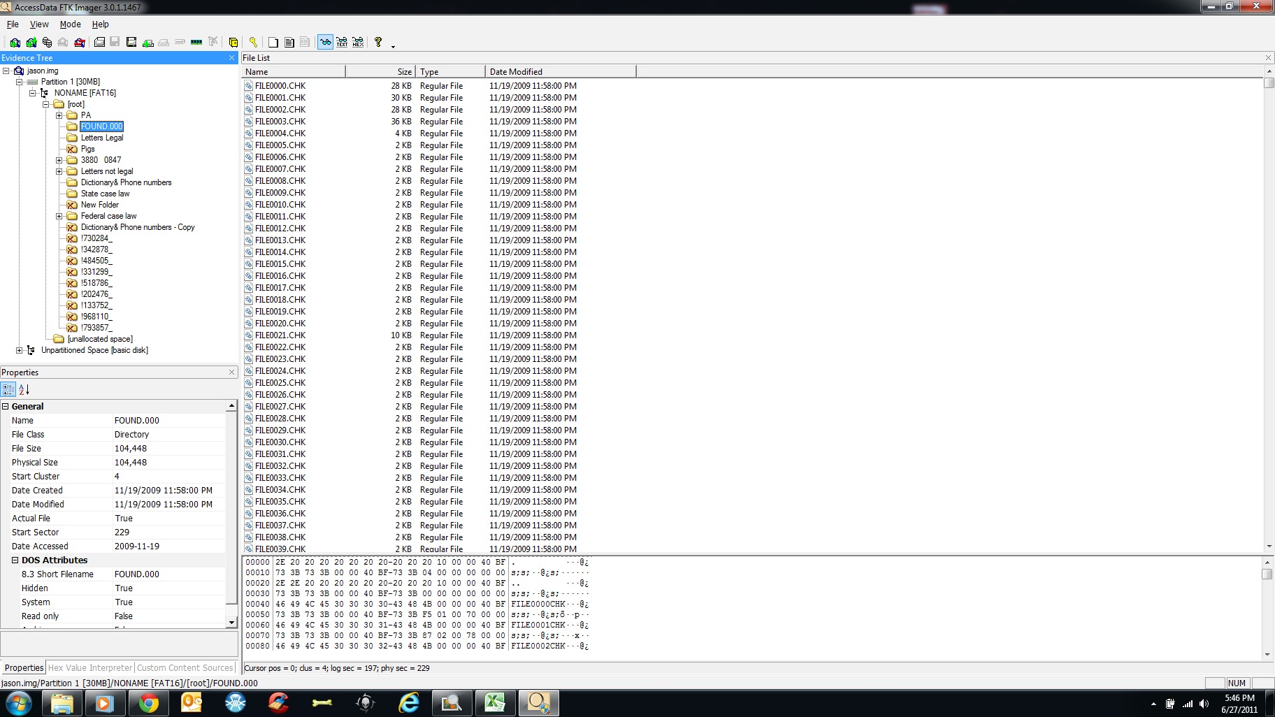

P.S. What is the date & time of the folder FOUND.000 in the root directory? Also, are there are any files named filennnn.chk in the root directory (where nnnn can be any number) - and if so, what date & time do they each have? This info is to help build a history of what has happened, regarding previous detected problems with the filesystem.

Yes the found.000 file has a date of 11/19/2009 11:58 PM

Thanks for the info about those chkdsk output files. Assuming that the PC involved had an accurate clock, then obviously that event was in 2009. Whether that was actually the time that the docx files were corrupted, depends on the answers to some of the questions I asked previously.
