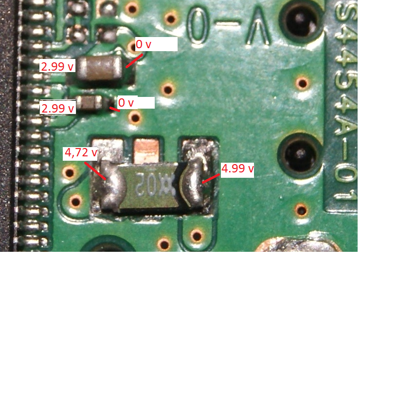

The "green resistor" appears to be a polyswitch.
Thanks, fzabkar. I'm not a native speaker and had no idea it's called in English this way. So instead of "self-restorable protector" and "thermal resistor" (which sounds more like a temperature sensor) I decided to call it just a resistor on Friday night adding its non-standard color :)
I do not work with flash drives myself (perhaps a bit of SSD play only), so my flash expertise is limited, but yes, that's the part, which dies rarely in flash drives, but still worth replacing with a piece of wire.

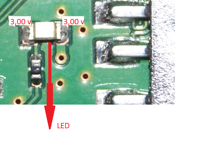

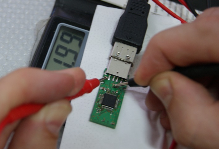

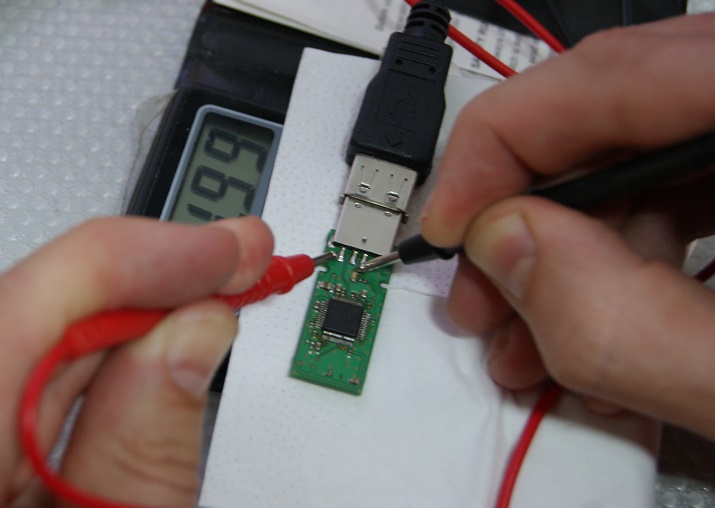

hhddrec wrote:
I atach pics wit measusres
Sorry about the LED (I'm colourblind). As for your measurements, they don't make any sense to me. ISTM that you have the ground and +5V supply the wrong way round.
Thanks fzabkar for your help, and do not worry about LED. probably pic qulity problems,
i atach another time some measures, think i am measuring correctly but you will see.
Thakns another time

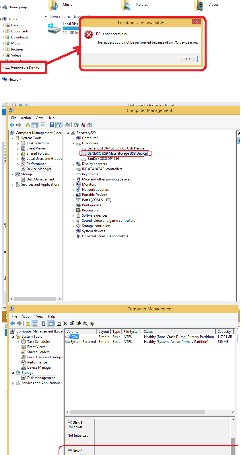

Dmitri wrote:
hhddrec, Also what happens / how the flash drive behaves when you insert it into a USB port?
Hi Dmitri!
I attach a pic about behaviours about flash
but, when i attach the pen-drive to my computer i can see flash atached to computer but not access to data
NOTE: i resoldered all pins. before re-iron, i could see the drive sometimes, and sometimes not

You are measuring incorrectly. The black probe should be on the ground pin. The red probe should connect to each of the components.
The actual voltage at the polyswitch is 4.97V / 4.62V, and the voltage across the capacitors is 3.0V. Those appear to be OK, even though one might expect 3.3V for the NAND. Others might want to offer their own opinions, though.
Sorry fzabkar!
you are in true.
In the LED measure as you suggest me is: 3.00 V
the other measured i will review it another time
thanks for your help

Posts: 811
Location: World
i upload another time measures
