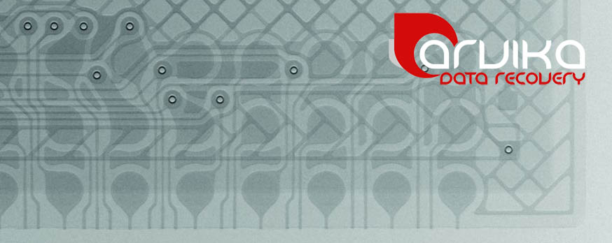

HaQue wrote:
My wish list is a good high res camera/microscope combo to around 100x, a wire bonding machine and an X-Ray machine.
X-ray sounds nice but the resolution on all the pictures I see looks so poor. I can see traces but it's fuzzy or not obvious where the via is in some cases. On eBay I've seen some x-ray sensors for $1200 and the xray generator for $300 but I've seen mixed results with that too, the picture will be mostly black because the generator is too strong.
Also the scale seems wrong so aligning it perfectly to the pcb to make a connection looks unreliable.
Those are my general thoughts on x-ray for monolithics.. Anyone have different results?

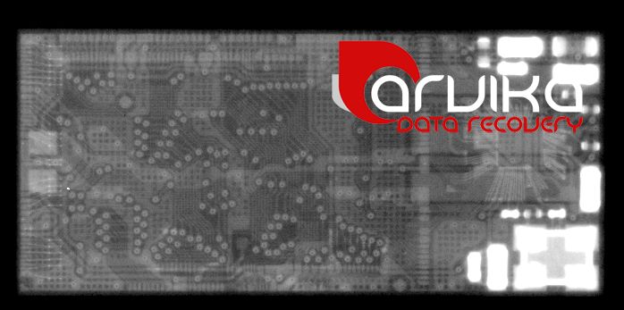

We have not bad results with Xray analysis of pinouts, quality is perfect, but that's not xxxx$ device...
But yes, you can break your eyes trying to trace all tracks :) But it works.

You can use very very veeeery expensive x-ray machine with good resolution - first photo.
You can use chip dentist X-ray machine (cost about 4000-8000 euro) but quality is poor - second photo.
It can help but i think not for all cases.

Yes, dentist xray is bad, maybe what I'm trying to say is the focus looks poor going from one layer to another. That said the quality on some of those is pretty good, #2 is pretty impressive but it makes me go blind looking at all those traces.. Maybe zoomed in at high resolution is better.
