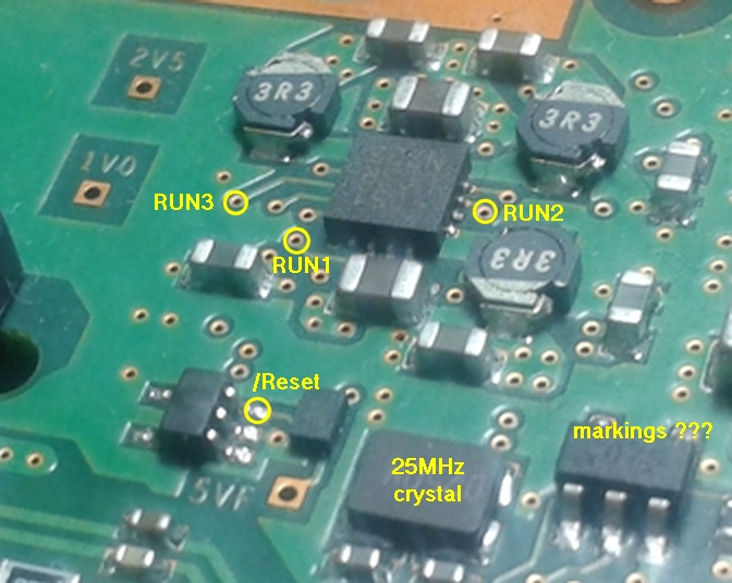

You should be measuring 5.0V between those two IC pins. That's the SSD's supply voltage.
What voltages are you measuring at the 2V5, 1V0, 1V5, and 5VF test points? Also measure the voltage at the 1.0uH coil near the 88SS9174-BLD2 flash controller.

Voltages are as follows
2V5 0.19v - 0.20v
1V0 0.61v - 0.62v
1V5 0.01v
5VF 3.30v - 3.31v (this is the actual test point, IC leg was 4.35)
1.0uH coil 3.30v - 3.31v
I'm using ground from the JTAG header and from the 5V test points near the LCT regulator, both give the same reading.

If your PSU is delivering 5V at the SATA terminals but only 4.35V at the TPS3801T50DCK IC, then something weird is going on with your PCB. Otherwise, if the PSU is delivering 4.35V at the SATA terminals, then it is either a lousy PSU, or it is improperly loaded. This is what can happen if the 12V rail of a 5V/12V PSU is unloaded, as would be the case if the SSD (a 5V-only device) is the only device attached to the PSU.
Anyway, the 3.3V supply is working. Just for the sake of completeness, what are the markings on the 16-pin LT chip on the underside of the PCB?
Your most recent voltage measurements would suggest that the LTC3545 chip is faulty, or that its 3 regulators are not being switched on, or that one or more of its outputs are overloaded.
Can you measure the resistances between ground and each of the 1.5V, 1.0V, and 2.5V test points (with the power switched off)?
Can you measure the RUN1/2/3 and Reset voltages?
Can you tell me the markings on the serial flash memory (?) and the 5-pin chip near the 25MHz crystal?

Ok, this is getting a bit weird...
I don't know if RUN1..3 have to be measured in that exact order, but I did it that way, then waited for the SDD to cool and discharge to take some other readings.
Here goes:
Resistances:
2V5 24.9~25
1V0 25.6
1V5 12.2
Voltages
RUN1 it tilts from 1.90 to 3.27 till it sits stable there (3.27)
RUN2 This one is a bit of a wildcard, it could be totally stable at 1.40, then go all the way up to 3.27 and stay
RUN3 Same as RUN2
RESET I never got anything concrete from this one, 1.40, 2.90, 1.30, 1.0, seems to change as long as power keeps running
RUN1..3 :As soon as 1 of them reads 3.27 all of them will do the same, but if I remove GND, they will start tilting till they get to 327
Also, as the time runs and the device is still powered, some other voltages will change
2V5 0.12
1V0 0.49
1V5 0
5VF stable 3.30 as before
AVI Vdd, Coil, will remain stable
The 16pin chip reads 3412A N2962
The supposed flash chip, well, I'm not completely sure, will try some other lamp/light magnifier combinations, but I read C075 so far
As for the testing suply, I'm using both a PC PSU rated 250W (from an old dell computer), and a standalone supply for a USB HDD.
After you told me the PSU could possibly be unloaded, I added another hard drive and some fans.
The reads remain almost the same even in the different time lapses, if I measure the SATA molex it will read 5.0~ in both PSUs, but as soon as I connect the SSD the will read 4.75 aprox (from the connected molex), all other molex in the Dell PSU will read 5.0~ correctly.

I don't understand what you are doing when you say "if I remove GND", but the RUN voltages are OK. That would suggest that the LTC3545 IC is faulty.
The RESET voltage should be sitting at a constant high level, so there is something wrong there. I can't identify the "CC" component, so I'm not sure what part it plays.
I would try to source the two faulty ICs (LTC3545 and TPS3801T50DCK) from places like Farnell, RS Components, Newark, Digikey or Mouser.

The only other concern I have is in regard to the "CC" component. I don't recognise it, nor do I understand its function. :-(

Could we see the area of the PCB where the component was located? Perhaps the traces will provide a clue.

The "CC" chip appears to be the "DRY" packaged version of the SN74LVC1G04. It is inverting the Reset pin of the adjacent PSU supervisor IC to produce 5VF.
See the datasheet for confirmation.
