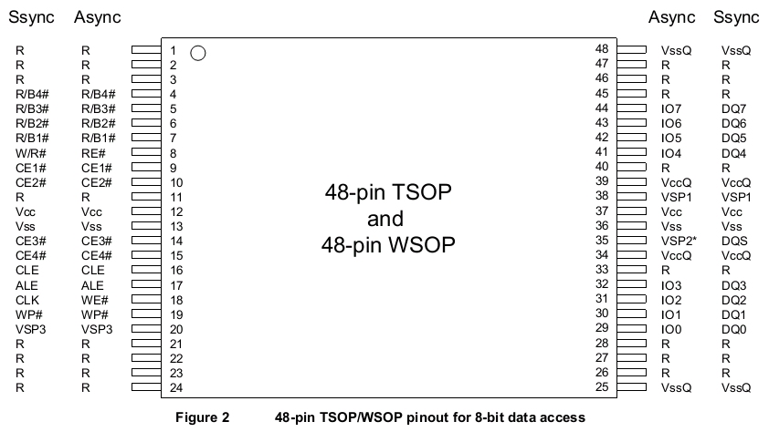

fzabkar wrote:As for C168, I would measure the resistance between ground and each of the pins of a single NAND. Then consult the NAND pinout and determine which, if any, of the grounded pins is not actually a power ground.
This NAND pins are grounded:
2 - 13 - 23 - 25 - 27 - 33 - 36 - 40 - 46 -48
Re: SanDisk X100 256G no BIOS detection
February 13th, 2015, 22:14
ISTM that your NAND array must be powered from both the 3.3V and 1.8V supplies. The Vcc supply (3.3V) would power the logic and the NAND cells, while the VccQ (1.8V) supply would power the I/O section.
Capacitor C168 would provide local bypassing of the VccQ supply for all NANDs. However, if the NAND chips follow the ONFI 2.2 spec, then we would expect that pins 34 and 39 would be connected together. :?
http://www.onfi.org/~/media/onfi/specs/ ... .pdf?la=en
That said, your latest measurements would suggest that C168 is no longer shorted. Are you certain that your original measurement was correct? :?
February 13th, 2015, 22:45
fzabkar wrote:Capacitor C168 would provide local bypassing of the VccQ supply for all NANDs. However, if the NAND chips follow the ONFI 2.2 spec, then we would expect that pins 34 and 39 would be connected together. :?
Yes i'm sure that pin 34 and 39 are not connected together.
C168 is still shorted.

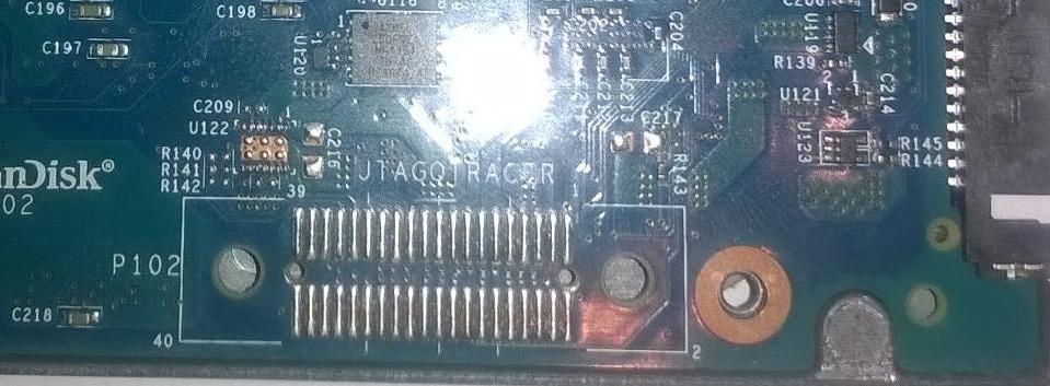

Does anybody of you know how to JTAG this SSD so that i will be able to see terminal log?
February 14th, 2015, 21:54
I can't tell if C145 is populated. If not then JTAG probably disabled by removed components, probably some resistors elsewhere. Then JTAG might be disabled in the system as well. Usually companies like Sandforce don't leave JTAG open at the front door.
JTAG and Terminal log are 2 separate things. Terminal Log is from the serial port. I would be interested to see just what is available on the JTAG Port though.
RDT stands for a number of things.. one is "Remote Distributed Testing" and Sandisk would have some software custom for this.
or it could be based on something like this:
JTAG, Ethernet, etc.; in SHAPES jargon, this tile configuration
is called RISC+DSP+DNP Tile (RDT)
which could be more likely.
http://www.google.com.au/url?sa=t&rct=j&q=&esrc=s&source=web&cd=50&ved=0CLUCEBYwMQ&url=http%3A%2F%2Farxiv.org%2Fpdf%2F1203.1536&ei=cfnfVNW_MsSF8gX-3YJI&usg=AFQjCNETSf1r2ZC45XKMblIkGp_oIkIEaA&sig2=oz3DvuW9BmcWMV6hX0AR9A
I have a JTAGulator which would be very good for quickly figuring out the layout/operability of the JTAG port.

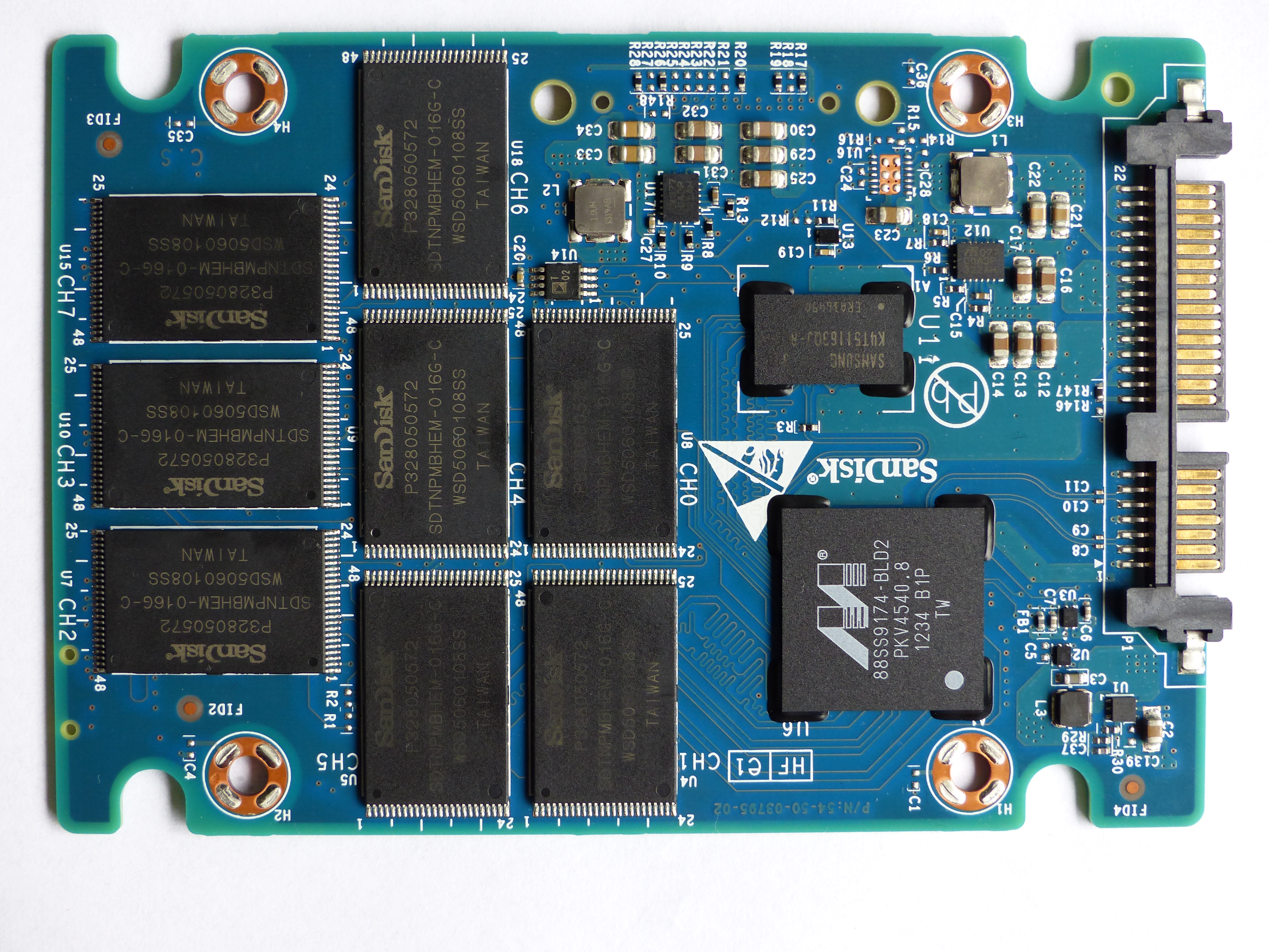

Could you please post pictures of the front and back of case so I can try and buy the same SSD and do some testing?
February 16th, 2015, 10:23
Hi HaQue, thank you for your help.
C145 is populated, C145 tracks are connected to a NAND chip.
Here the pics you asked:

michael chiklis wrote:Does anybody of you know how to JTAG this SSD so that i will be able to see terminal log?
Old post I know, but it appears the JTAGOTRACER pads may sport a Mictor connector :
http://www.malwaretech.com/2015/04/hard-disk-firmware-hacking-part-3.html

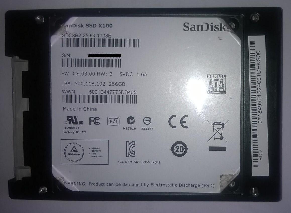

Have you finally solved the ssd repair? Because I have an identical ssd, dead , and I'm sure it can be brought to life somehow.
May 4th, 2018, 4:35

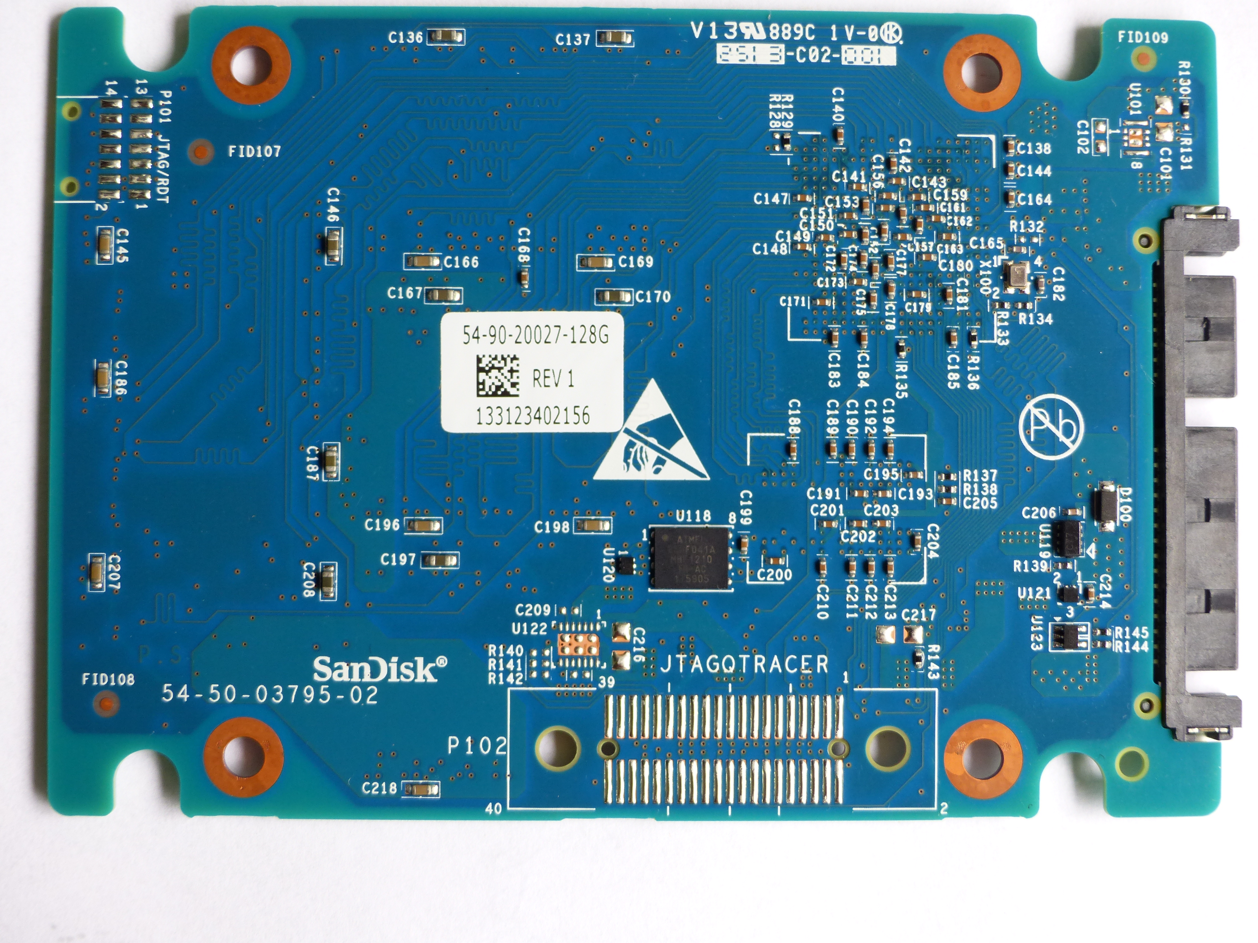

@alindumitru46, can you provide better photos of both sides of the PCB?
May 7th, 2018, 13:10
Of course, in the last days I was very busy. Now I'll test the option to edit the post ;)
May 8th, 2018, 6:05
These are the best pictures I can make.
May 8th, 2018, 6:55
The short story: I purchased 4 Sandisk X100 SSD with a "strange" SMART issue 5 years ago . Only 1 died, after 1 month, the others 3 pcs run fine with max performances in 2 laptops and 1 NUC.
After running for about 1 month, the next day he was not recognized in the BIOS, then by any motherboard I checked.

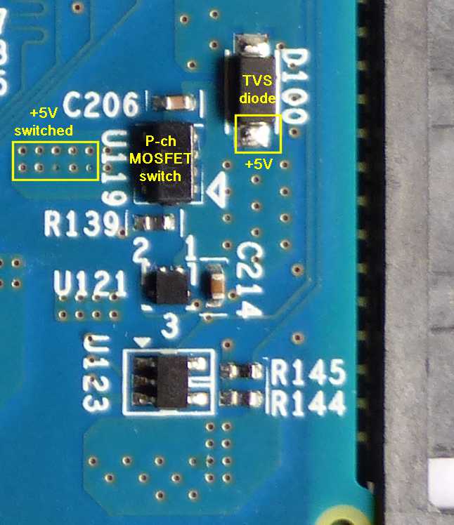

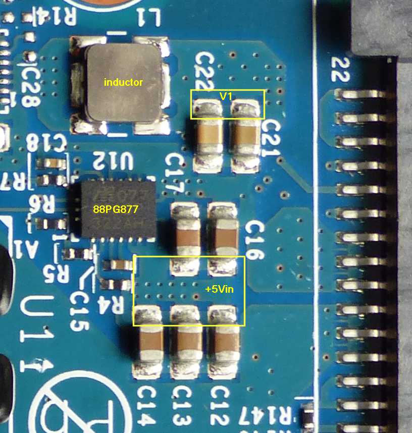

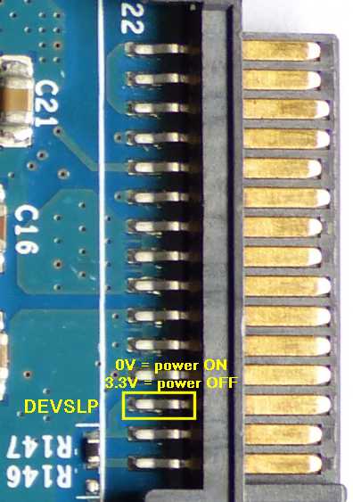

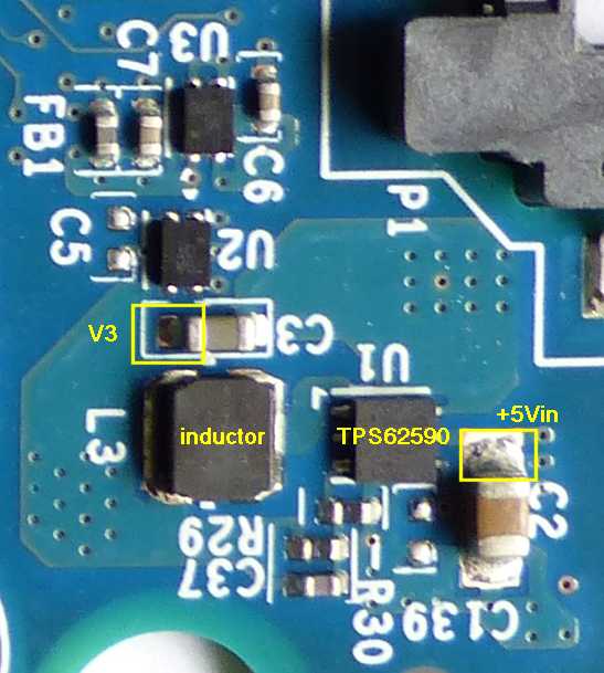

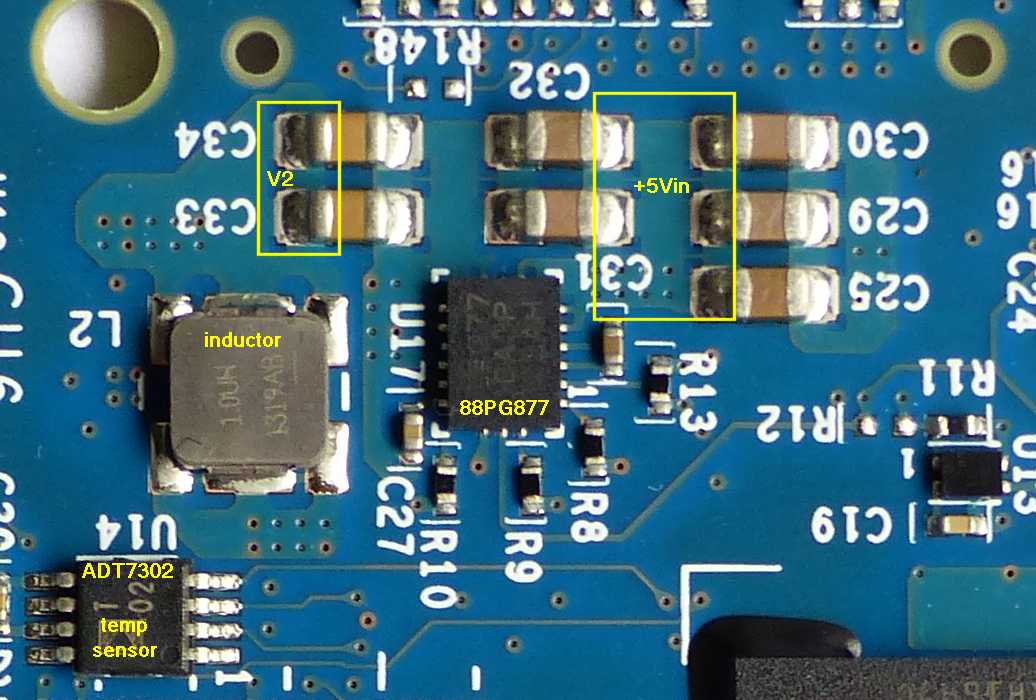

Can you measure the voltages at V1, V2 and V3?
88PG877, Marvell, Field Programmable DSP Switcher, 1 MHz, 7.5A Step-Down Regulator, marking G77, QFN-18, Vin = 3V - 5.5V, Vout = 0.72V - 3.63V:
http://www.marvell.com.cn/selector_guide/downloads/ds/88pg8x7.pdf
ADT7302, Analog Devices, +/-2degC Accurate, Micropower Digital Temperature Sensor, marking T02:
http://www.analog.com/media/en/technical-documentation/data-sheets/ADT7302.pdf
TPS62590, Texas Instruments, 1A, 2.5V to 5.5V, Step Down Converter, 2.25-MHz, marking OAL:
http://www.ti.com/lit/ds/symlink/tps62590.pdf
May 10th, 2018, 3:52
I just finished measuring the voltages at those points, according to the scheme, using a no-name PSU and a UNI-T UT139B digital multimeter.
[URL=http://www.imagebam.com/image/287e99855409024]
May 10th, 2018, 5:33
Most of those voltages don't make sense. Are you using an appropriate PCB ground reference?? Does your meter have a weak battery??
May 10th, 2018, 6:54
I used the pcb ground :idea:
I'll try right now with ground from power connector
