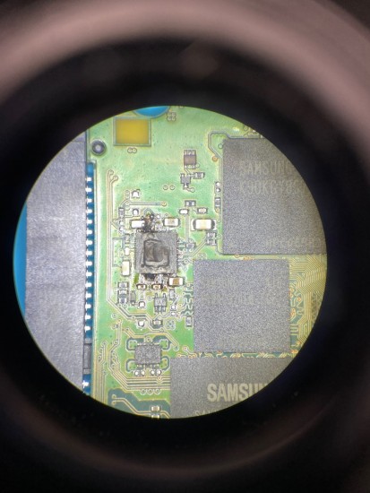

 Post subject: Re: Samsung 840 EVO 512GB - burned - pls need advice
PostPosted: June 27th, 2015, 4:58
Joined: June 25th, 2015, 16:16
Posts: 23
Location: Czech Republic
great investigation, thank you!
Its seems to be the right IC. And is orderable via ebay and Mouser.
The pad under is really grounded, pin 5 is ground, but on SSD PCB is not connected, because IC is grounded via large pad - and pin 5 - as is in datasheet - is internally grounded.
Pin 6 is really grounded via cap on ssd PCB, so it is OK too.
Pin 7 - EN - is connected to 5V input on second side of the PCB, see photo, so its enabled right by 5V sata voltage.
Dimension are same, 3x3 mm
5A seems odd ... dont know ...
And yes, 5V Guill input is connected to 5V output of ther burned JS4NAM
C1 and C2 are OK, not shorted, resistance in MOhms, C1 has 63μF and C2 128μF.
I measured all caps on both sides, quick test, seems to be no short.
Thx
Daniel

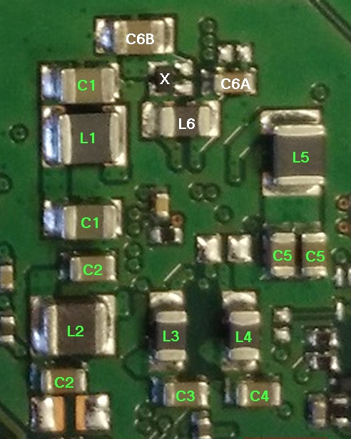

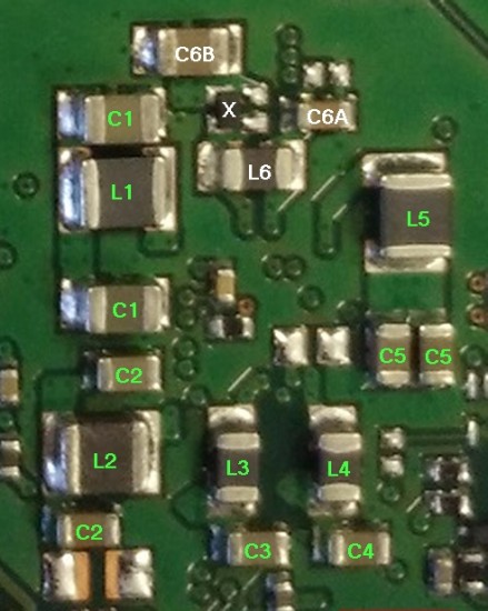

If pin 5 is connected to the IC's pad, then you should have measured a short between pin 5 and PCB ground when the IC was installed on the PCB. But you stated that there was no ground connection to any IC pin. BTW, Farnell and Digikey also have the STEF4S IC ($3).
As for the 5A rating, the datasheet does in fact specify that this IC is targeted at SSD applications. Otherwise, could it be that Samsung's IC is a special order with OEM specs?
ISTM that the GUILL IC and its load are probably OK. You could confirm whether this buck regulator supplies the NAND array by testing for continuity between its output and the ceramic Vcc bypass capacitors adjacent to any of the NANDs.
The AKE4JR chip appears to comprise 5 buck regulators and some other circuitry which I don't recognise. I suspect that these regulators would provide Vcore and Vio for the flash controller (S4LN045X01-8030), plus the Vcc for the SDRAM (K4P4G324EQ-FGC2).
You could confirm that no regulator output is shorted to ground by testing the resistances of C1 - C5. L1 - L5 are the corresponding inductors.
I don't understand the function of the area consisting of L6 (?), C6A, C6B, and X. It might be worth checking whether any of these components are connected to ground or 5Vout. If X is a diode, then it could be that this circuit constitutes a boost regulator, but I can't understand what this would do.

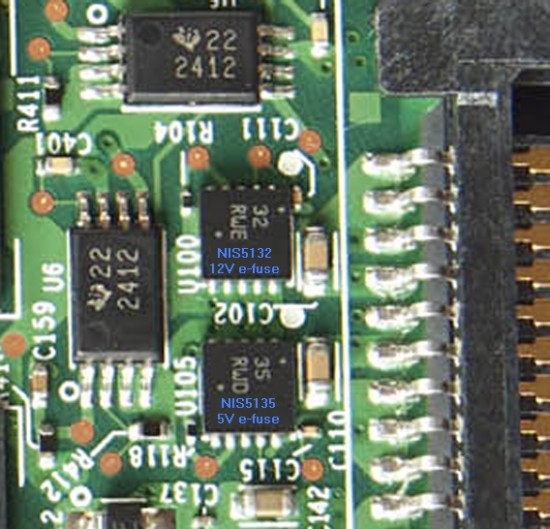

I notice that the 850 Evo 500GB has an unpopulated electronic fuse and a 5V TVS diode. The 5Vin and 5Vout are bridged with two components.
http://www.thessdreview.com/our-reviews ... lc-v-nand/
http://tssdrcdn.thessdreview1.netdna-cd ... B-Back.jpg

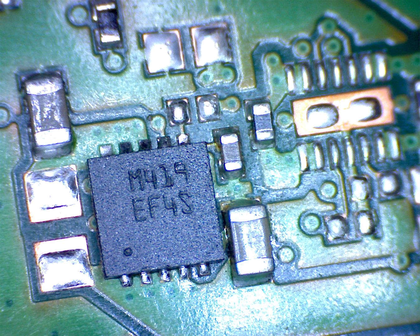

Hello!
replaced with STEF4S and its working!!! So many thanx to all, especialy to fzabkar, you are really master!
Hope it will help to someone in future ...
Nice day to all!
Daniel
PostPosted: June 30th, 2015, 16:52
Posts: 17223

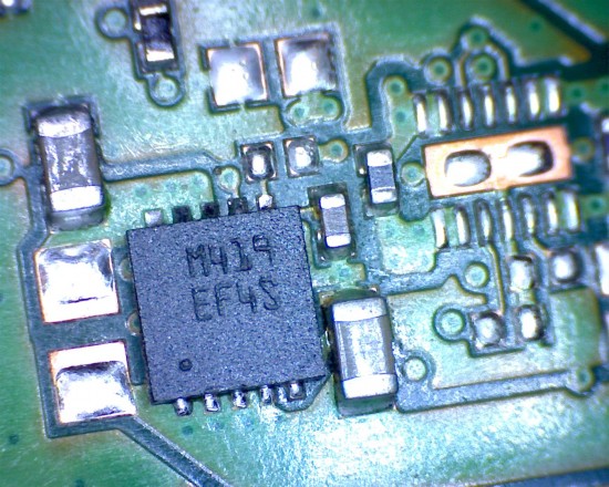

Congratulations. BTW, what are the markings on the STEF4S chip?
PostPosted: July 1st, 2015, 9:45
Posts: 23
Heelo, see photo. Nice day. Daniel

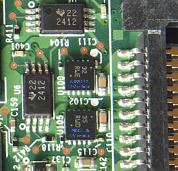

BTW I'm now seeing e-fuses everywhere.
Here is an example from an Intel S3700:

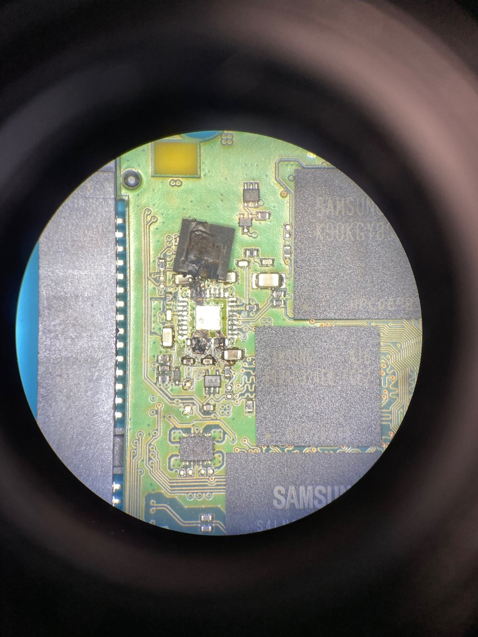

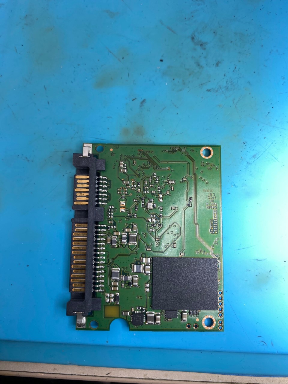

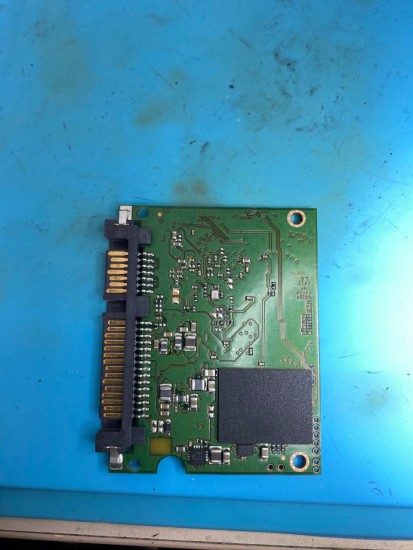

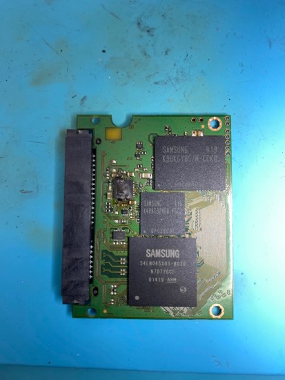

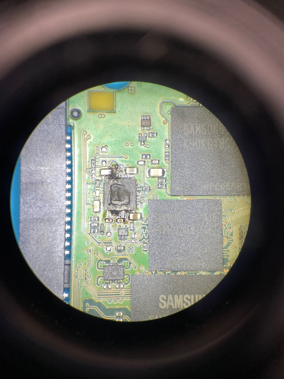

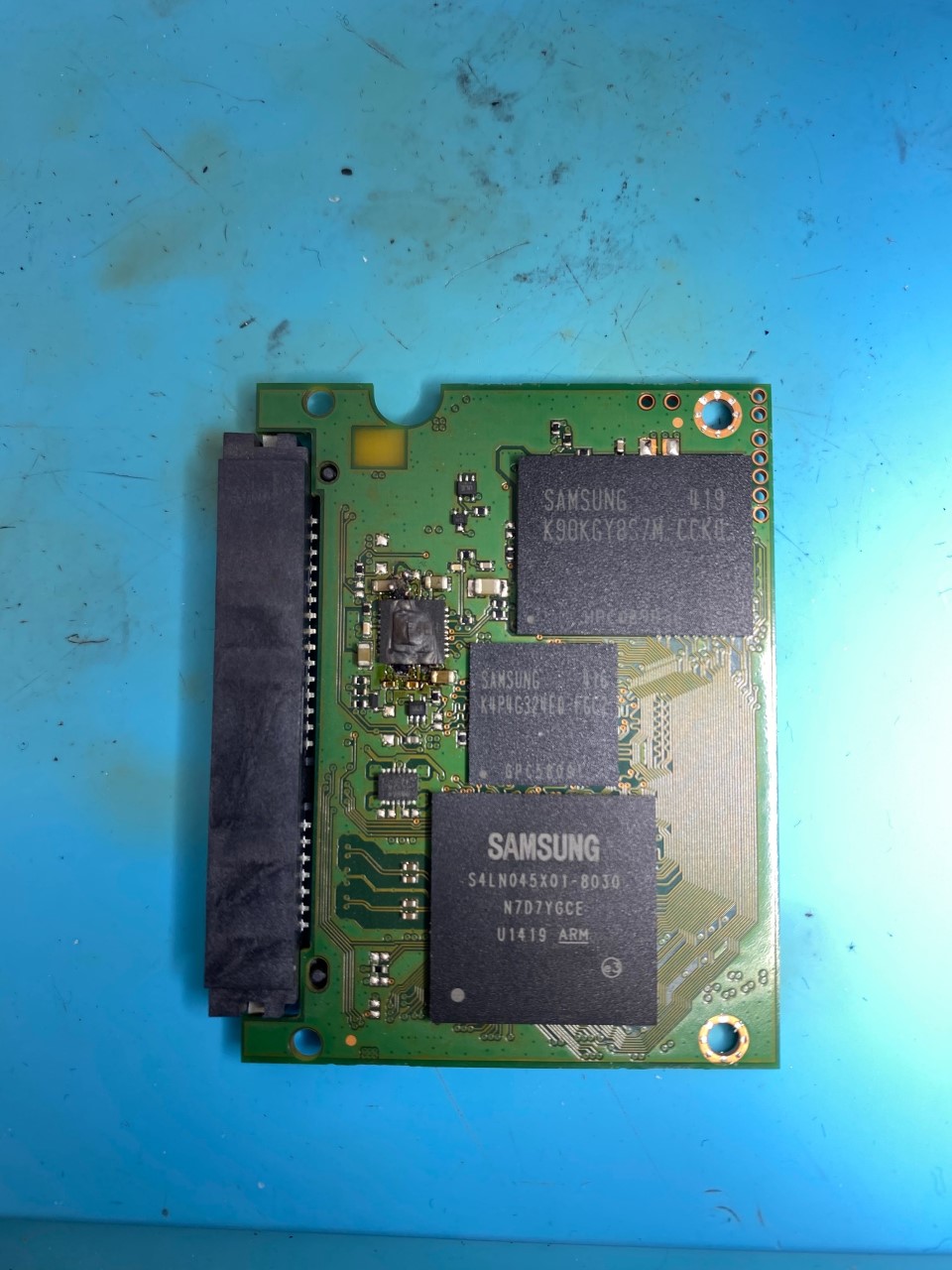

Hello guys,
I know thats an old topic but can anyone help me identify the AKE4JR chip? Anyone knows where I can source it from (except from donor)
Its on a samsung PM851 board and its completely blown.
TIA
iPhone & macbook Data Recovery Expert
PostPosted: March 12th, 2021, 14:42
Posts: 17223

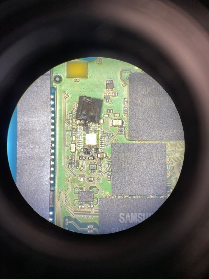

If you can show us a photo with the chip removed, we could try to match it up with likely candidates.
Personally, I would measure the resistances between ground and each of the inductors, after removing the chip. This will tell us if any of the loads may have been damaged. Often in cases like this, the input voltage (+5V) punches through the PMIC and damages the other ICs.

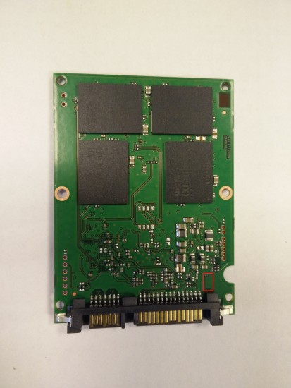

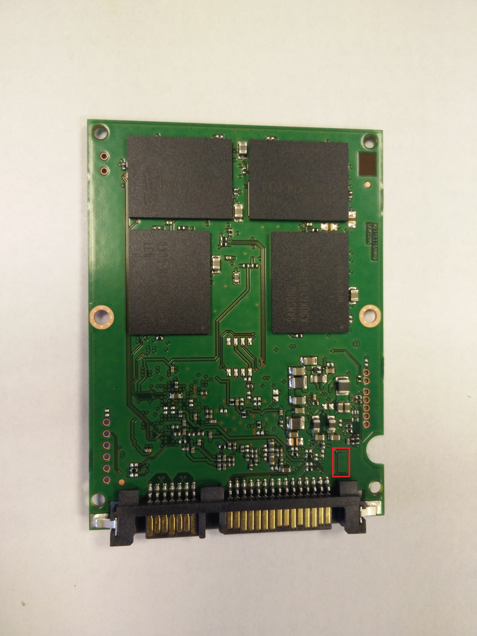

PostPosted: March 16th, 2021, 4:56
Joined: March 1st, 2021, 5:07
Posts: 24
Location: Athens - Greece
Thanks for your reply!
Yes Its pretty likely that other chips are damaged as well. its like 220v hit that chip as you can see on the pictures.

I couldn't find anything in Texas Instruments' lineup. I know Samsung's products often have PMICs with Samsung's own part number and logo, so it might be an in-house part.
It could even be a DIY user programmable PMIC:
https://www.ti.com/power-management/multi-channel-ics-pmic/diy-pmic.html
These are 40-pin PMICs which are configured for various processors:
https://www.ti.com/design-resources/design-tools-simulation/processor-fpga-power/other-processors.html
Other IC makers (eg Active Semiconductor) also produce PMICs which are preconfigured for particular processors. You see them on Sandisk SSDs, but many are custom designs.
The bottom line is that I don't know where to look. :-(
In any case you may be wasting your time if any of the outputs are shorted to ground.

I understand. Thanks anyway for your time. Much appreciated. I may have access to an identical disk so maybe I can source the chip or at least make some measurements. will keep you posted.

I have several of this AKE chip in my EVO840 collection:
AKE3NA
AKE4IP
AKE4QD
AKE4JJ
AKE3TK
AKE4GQ (twice)
AKE is the chip model, 3/4 is definitely the production year (2013/2014) , and the rest 2 characters are most likely a week code.
I have 2 of these AKE chips left from destructive research experiments, if you need them.
