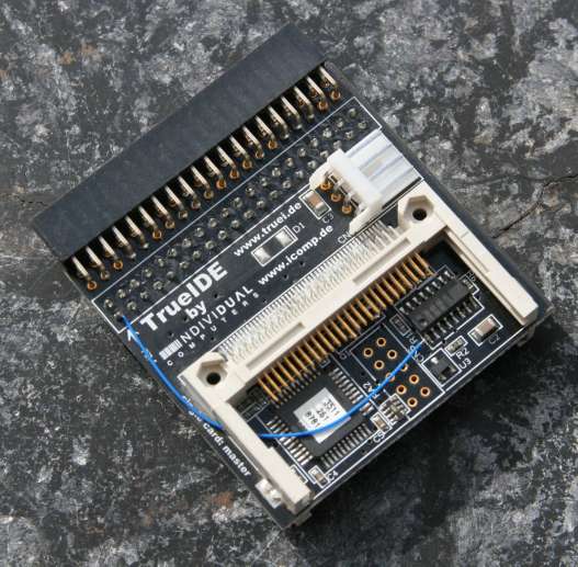

here is an example of a fixed disk CF:
http://californiapc.com/Industrial-Flash-Memory/SanDisk-CF-OEM-and-Commercial/SDCFAA-004G-F.html
and lastly - before I get back to what I SHOULD be doing:
Specialty Compact Flash reader such as TrueIDE by Individual Computers will show the card as fixed to the host device no matter what the device is.
Passive Compact Flash adapters such as the popular Addonics ADIDECFB or any of the inexpensive adapters will pass along whatever the FIXED/REMOVABLE bit is on the card. You will be able to use either of these types of adapters in your MPC. However it is very important to find a Compact Flash card that is a FIXED disk.
http://www.mpchunter.com/compact-flash-card-troubleshooting/

and looking around, I don't think I would be buying any soon.. way to expensive to just hack around on. I can see why one would want to use it though, a good card.
http://truei.de/
http://wiki.icomp.de/wiki/TrueIDE
TrueIDE
TrueIDE is a converter that allows you to use up to two Compact Flash cards with your IDE controller. TrueIDE even permits the use of CF cards that regular (passive) converters will only show as removable devices. The active part of TrueIDE parses the data stream that is exchanged between IDE controller and the CF card, and whenever the IDE controller checks for removability, TrueIDE will report back that the media is "fixed". This will allow installing and booting any operating system from a CF card.
