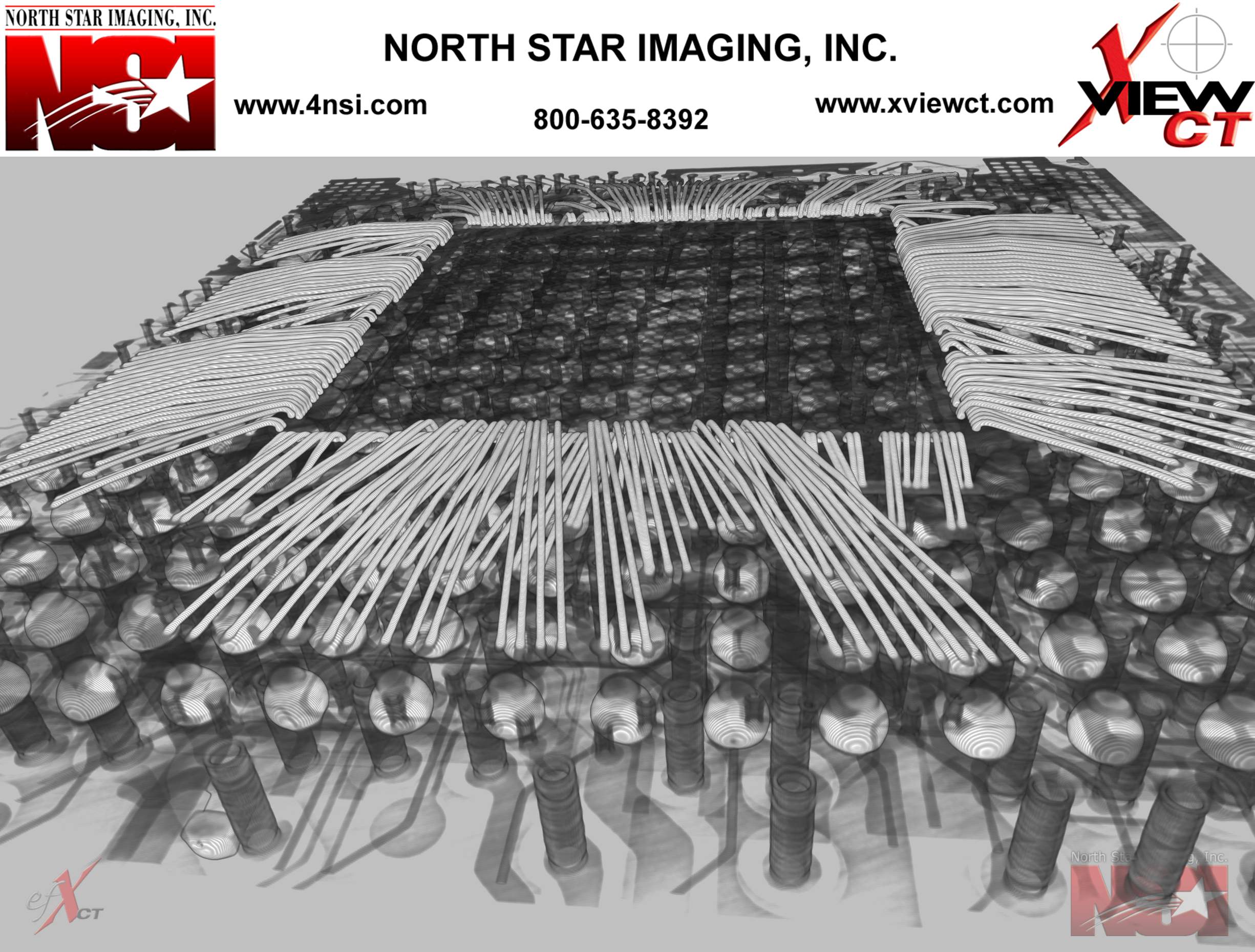

Sunny, nice work, you do some interesting cases. Did you scratch away the pcb to get at the traces inside? or another method, and how did you find pinout pints of subterranean traces..

What good is an X-Ray if you don't know the pin-out to the controller or NAND, I still don't know how this is derived. You're taking pictures of wires with no reference, like a map without street names.
You don't need a laser, use fine grit automotive sandpaper and be gentle, create a jig to put the device in so you're not sanding the edges off.
To get a proper laser is a HUGE waste of money. Yes it can do other things, like remove thermoset BUT it will destroy everything inside as well. Maybe 1 out of 100 times there is a blown fuse inside, fuses are in predictable locations, removing the thermoset will destroy the fuse, but you are replacing it anyway so it doesn't matter. I don't think it's worth it. (?Almost?) Nobody uses a laser. Put the money towards a sports car.

If One Needs To Accure a Xray What is The Recommendation .How About a Dental Xray Should Be Enough .Can You Pour in Your Suggestions .

The picture from a dental X-ray is unusable, very low quality

Sir Unusable Why So .What if You Have Good Quality Powerful Xray .What is Your Recommendation As a Senior In The Trade .

Being a big fan of Nikon, I can suggest you this one. It's very nice, with nanofocus, 0.1um and 3D.
 Post subject: Re: Monolithic Soldering Critique
PostPosted: October 9th, 2015, 18:09
Posts: 917
Dental Xray is to weak to our purpose, quality and resolution is bad.

Children's toys, you all disappoint me. If we're talking about "this" let's throw a 3D CT Scanner into the mix. It makes your X-Ray look like a toy car. Picture is of a SSD BGA with Bond Wires.. I'll take that any day over the spaghetti nightmare that you call an X-Ray.
