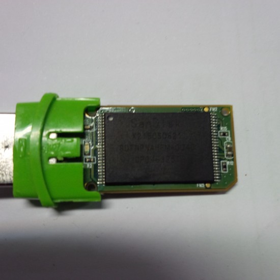

I opened my Pendrive and details are :
SanDisk
X215050821
SDTNPNAHEM-004G
CPD463251
What is your idea for format it?

Maybe I have been too verbose and you have missed the questions in the tens of lines Ive posted. I will ask again in a different way:
1. What is the numbers on the controller?
2. What capacity is it? I guessed 4GB, is this right?

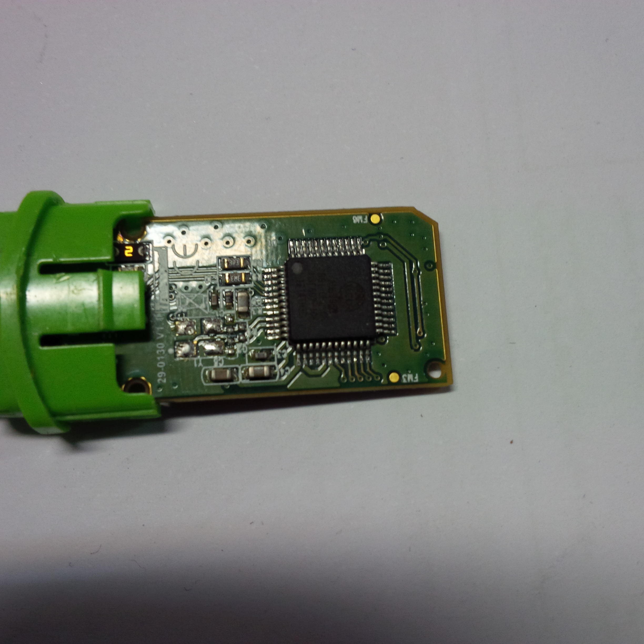

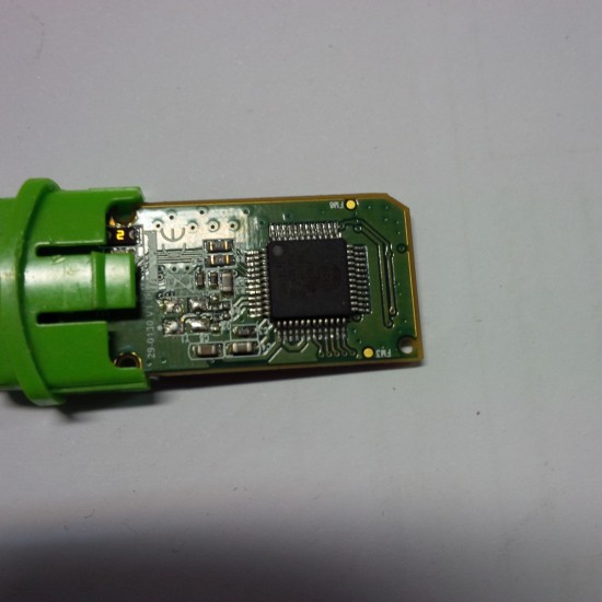

3. can you post pictures of both sides of flash PCB
4. Why do you want to spend time on trying to format it when it is quite probably faulty?
5. How did you come to the conclusion that no physical issues exist, when the time you said id, you had not opened the drive. Did you test the resistors/capacitors, look under microscope for damage?
6. is the drive
I've already stated that to fix flash drives if the firmware is fault, you need the Mass Production tools. There are two (2) chips.. a NAND chip and a controller chip. So far we have worked out the NAND is a Sandisk, though still don't know if refurbished, maybe not. But what is controller chip? You cant get the right tools without knowing that.
This is a Transcend JetFlash right? did you know they have a lifetime warranty? just get it replaced!

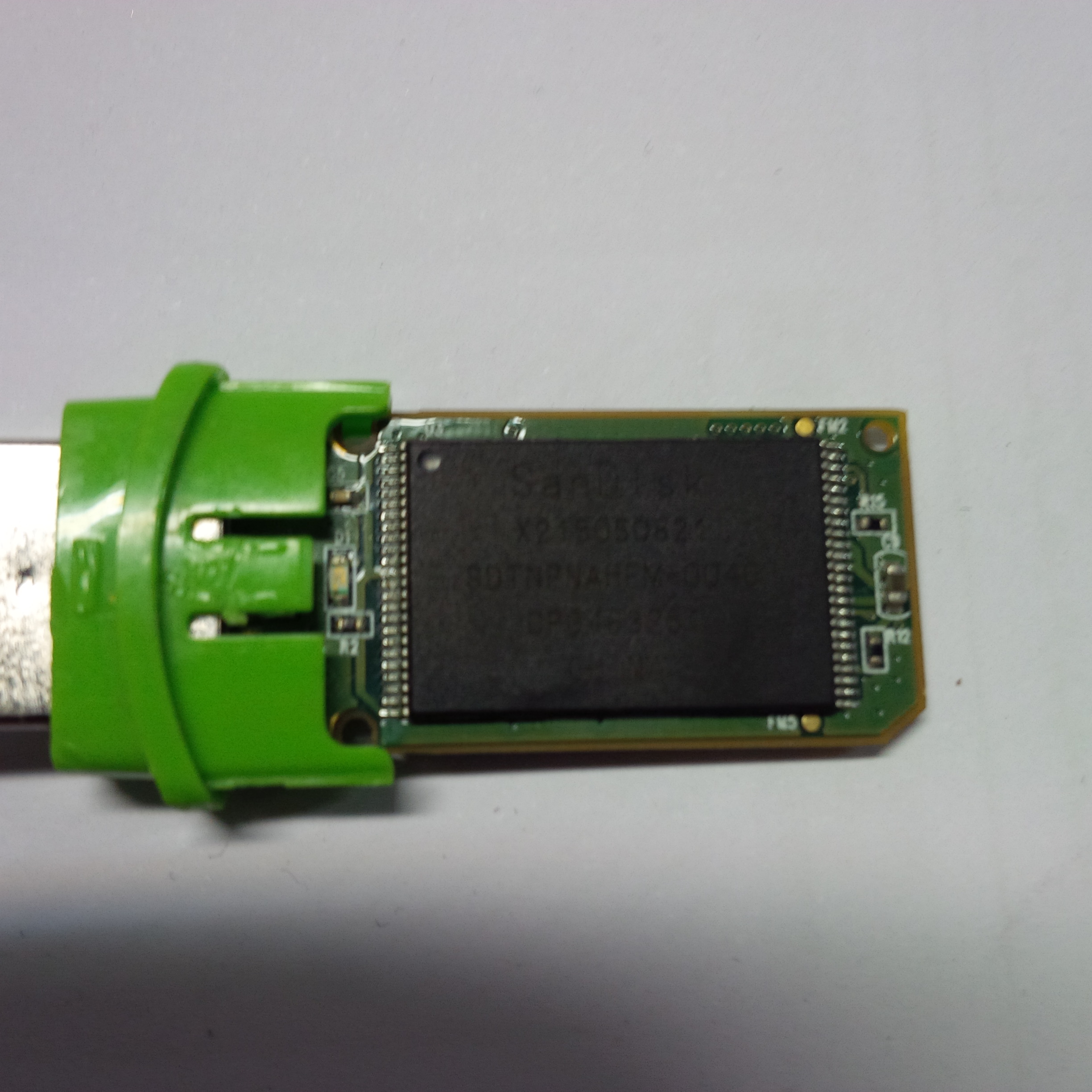

numbers on the controller? It have two Chips. One is SanDisk and another is Alcor.
It is 4GB.
 Post subject: Re: Is my Pendrive Dead ?
PostPosted: January 30th, 2016, 7:49
Posts: 3977
Thanks, now we are (slowly) getting somewhere. Any reason you didn't post the actual numbers on the controller, as we cant really read it from the picture? or didn't answer anything past number 3.
I just cant see any point continuing. The drive is dead, replace it or warranty it.

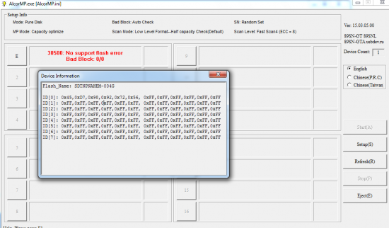

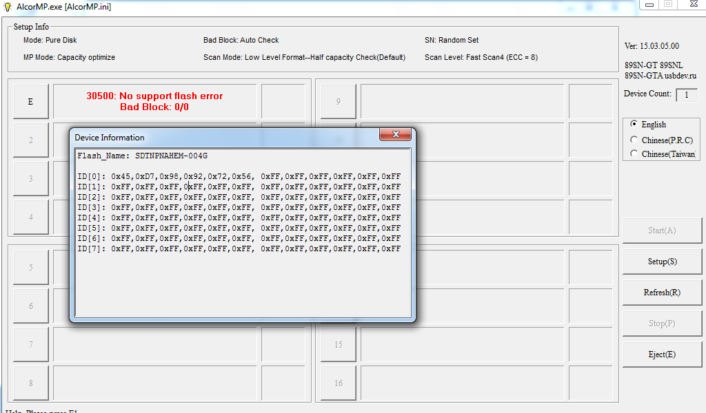

If you remember I tried "AlcorMP_UFD" but its failed :(

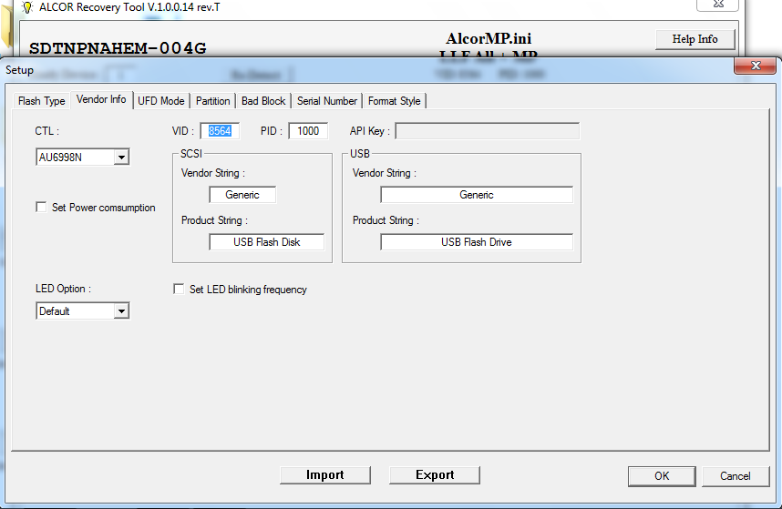

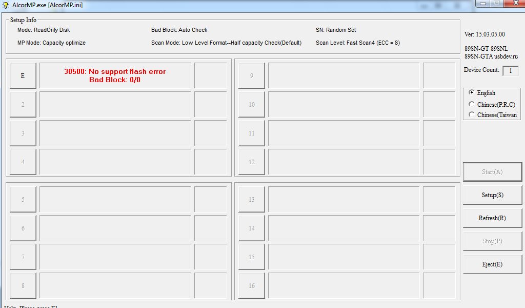

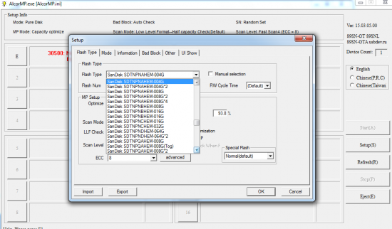

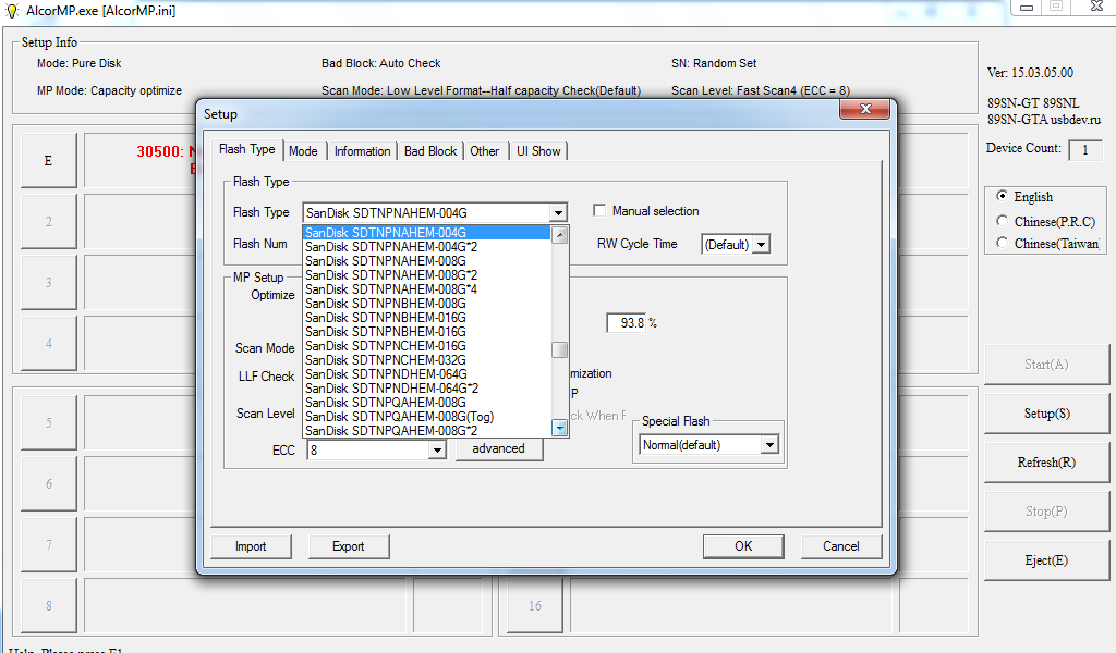

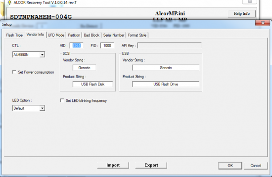

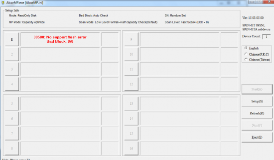

I did and I got errors. AlcorMP have a lot of options. How about Other tabs and options like "Mode" , "Bad Block" and ...?

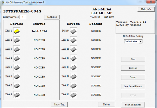

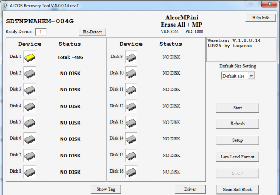

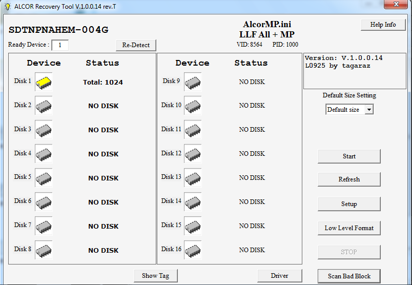

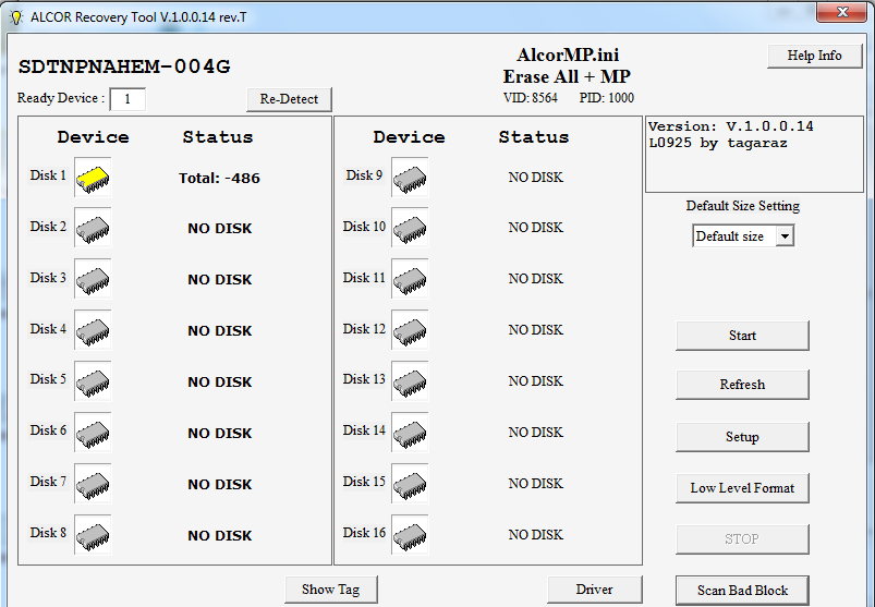

I used "Alcor Recovery tool" and set my CTL and when click on "Low Level Format" I got "1024" and when click on "Scan Bad Block" I got "-486". What these numbers mean?

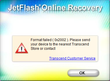

did you somehow miss the advice from the JetFlash online recovery tool? I will say it again for the last time, the drive is no good. get a new one
