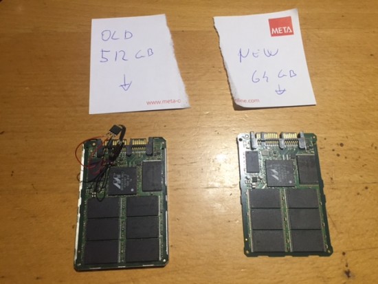

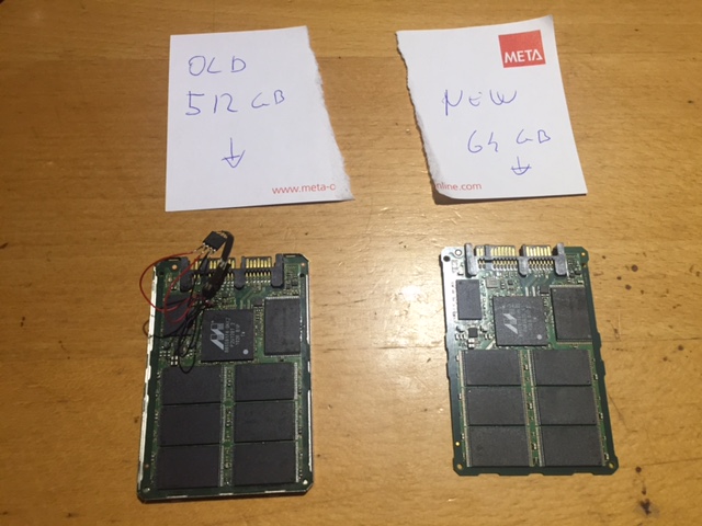

I found an SSD with 64GB card and format identical to the 512. MTFDDAA064MAM - 1J2 try to replace the firmware and see how it behaves . Alternatively I try to settle all the nand of this new card .
we hope well...

Id is locate to bios chip? how is the id and the geometry data? Is in the bios chip or in the nand flash? Thanks
