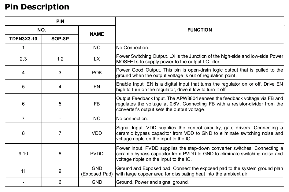

I can't see the marking on all the smaller chips, but you can start by carefully measuring the voltage at the Enable pin (#5) of the APW8804 ICs. I suspect that it will be low (0V), in which case our next move will be to find the chip that is driving this pin.

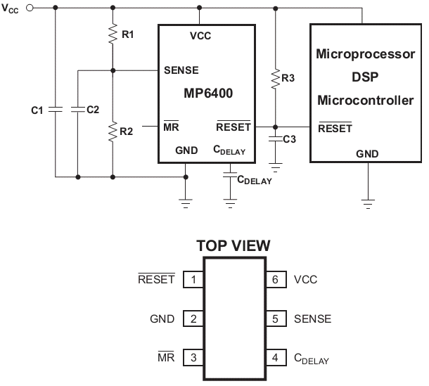

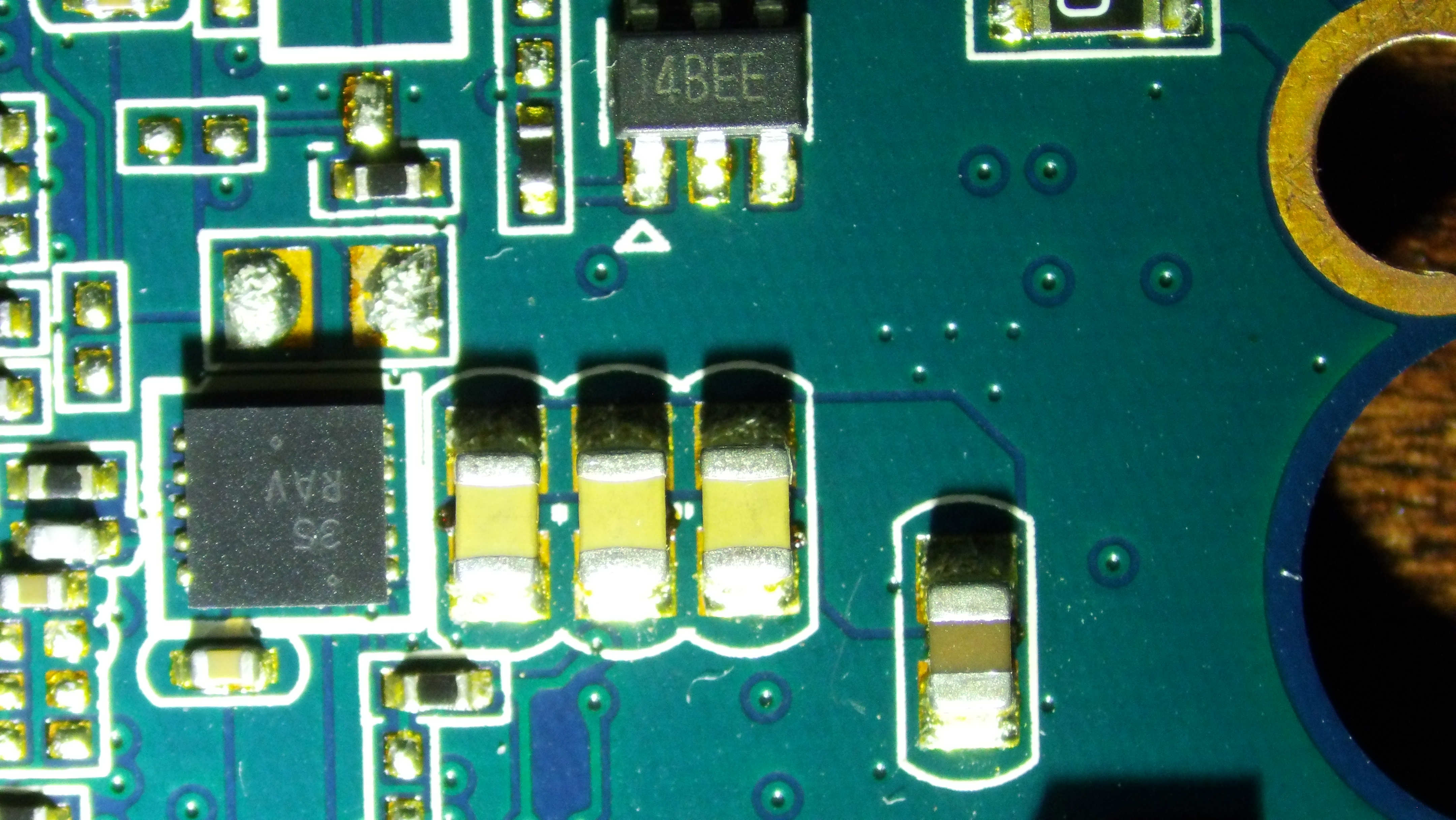

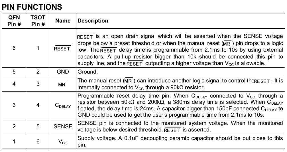

Measure pins 1, 5, and 6 of the 6-pin chips marked "4Bxx".
MP6400DJ-01, adjustable Programmable-Delay Supervisory Circuit, marking 4Bxx, TSOT23-6:
http://www.mouser.com/ds/2/277/MP6400_r1.1-371744.pdf

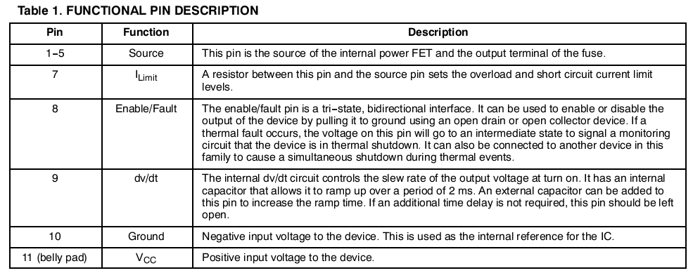

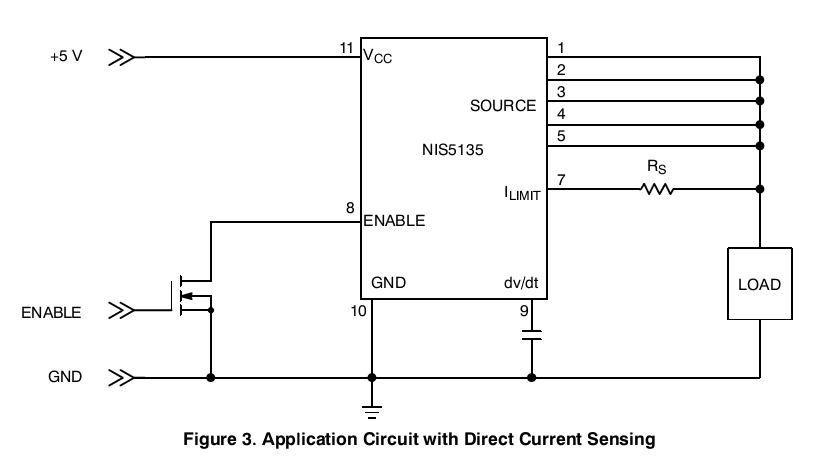

NIS5135, 3.6A 5V Resettable Electronic Fuse, marking 35:
https://www.onsemi.com/pub/Collateral/NIS5135-D.PDF

you right, pin 5 of the APW8804 is low 0.014V

chip 4Bxx
pin 1 = 0.01-0.0V
pin 5 = 0.51V
pin 6 = 0.025V

The +5V Vcc supply isn't getting to the regulators or supervisor ICs, yet you say you can see it at the output of the e-fuse. :?

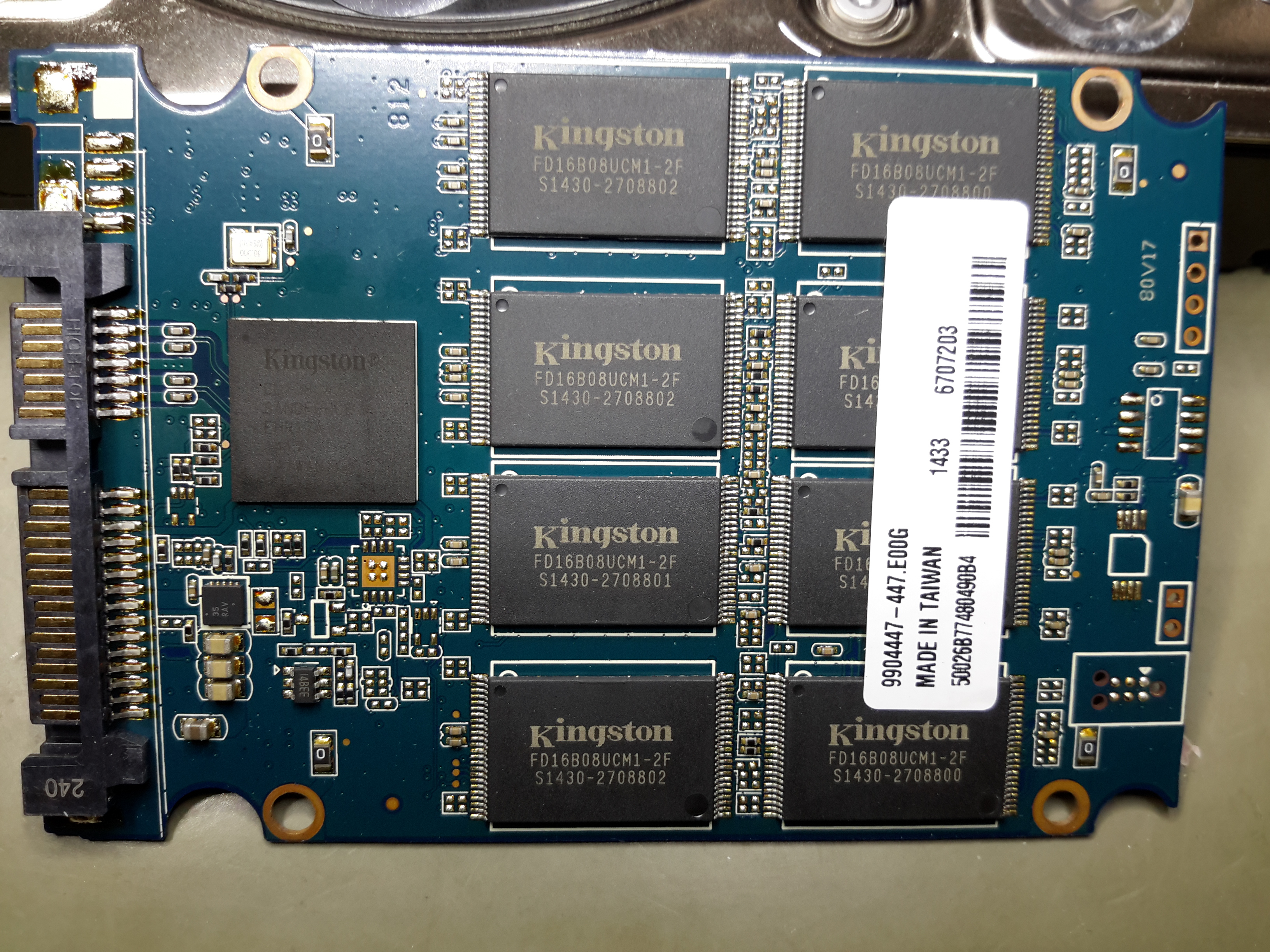

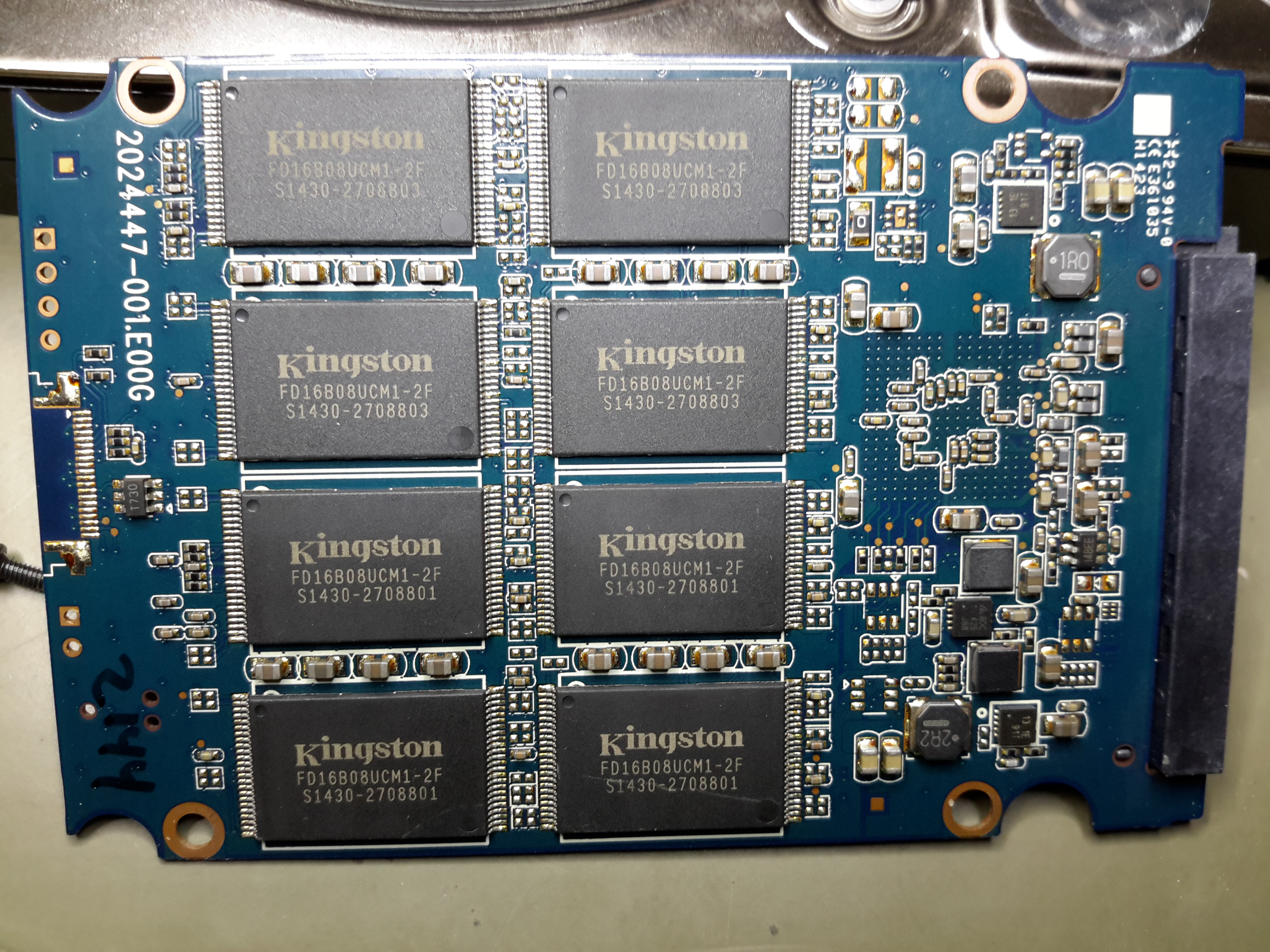

Are you able to provide better quality photos (or CCD scans) of both sides of the PCB, or can you at least tell me the markings on all the smaller chips?

let me see what I can do about the picture
 Post subject: Re: Kingston SSDNOW 300 Case Opening
PostPosted: May 9th, 2018, 21:37
Joined: May 9th, 2018, 14:50
Posts: 22

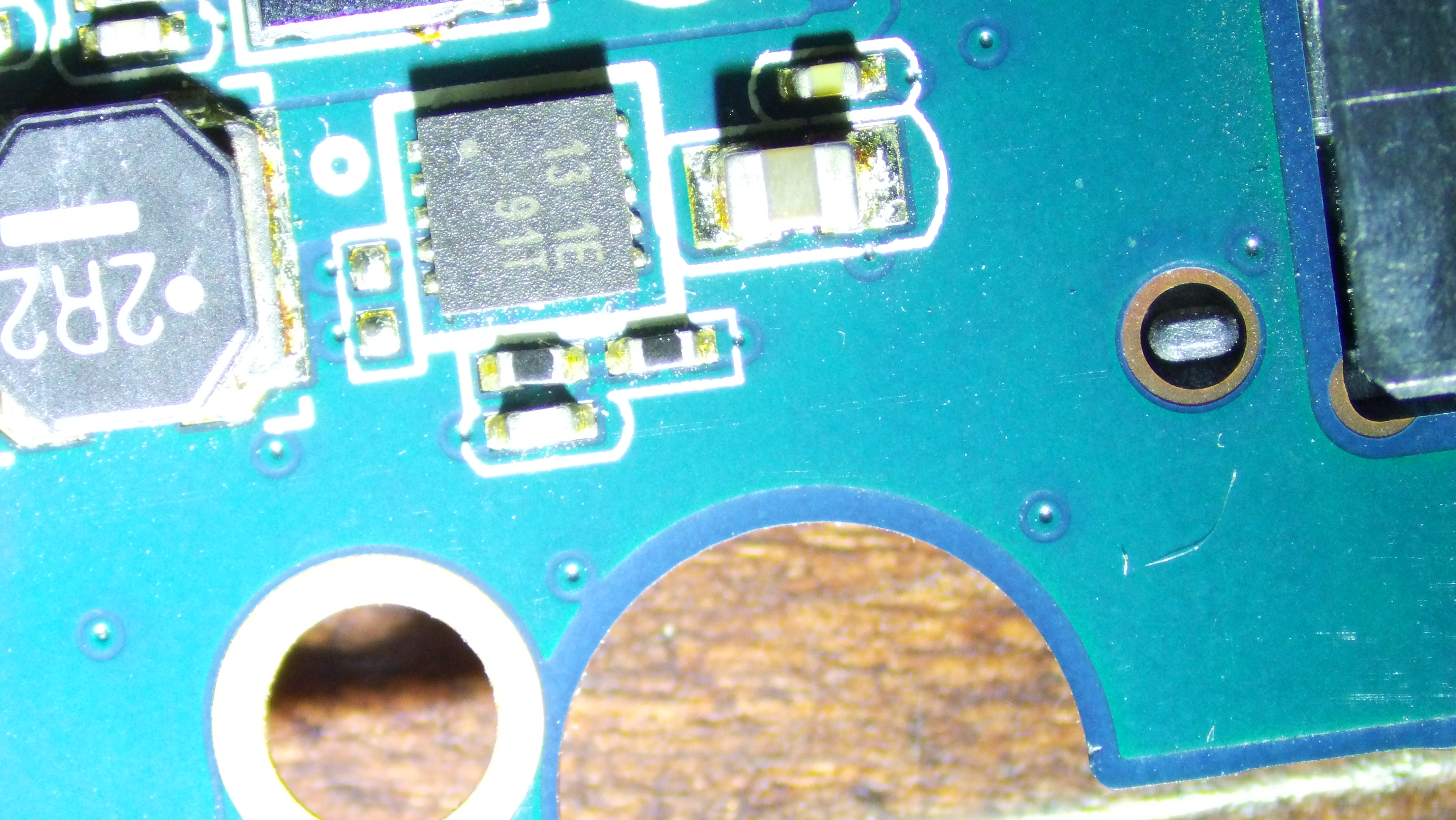

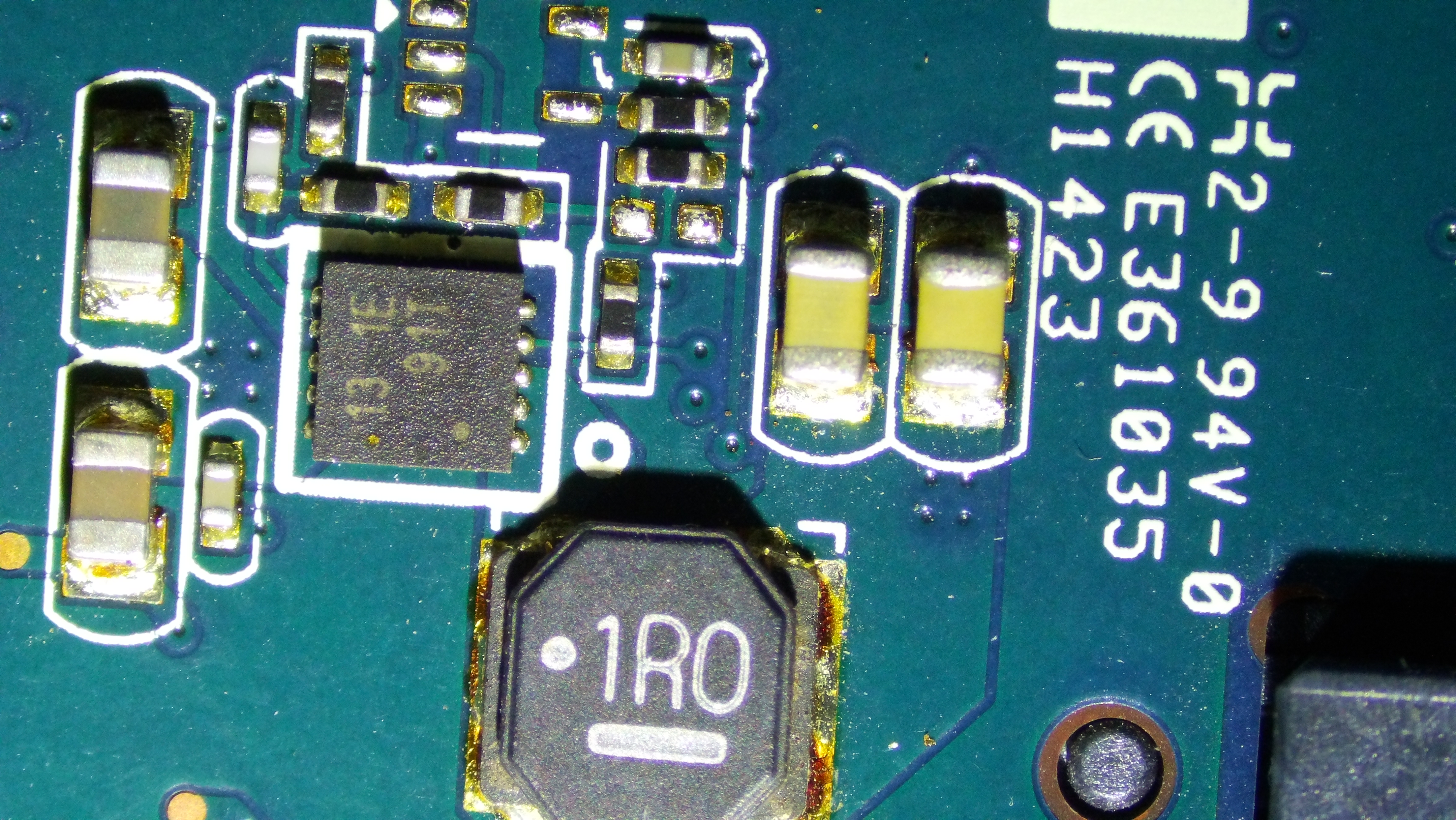

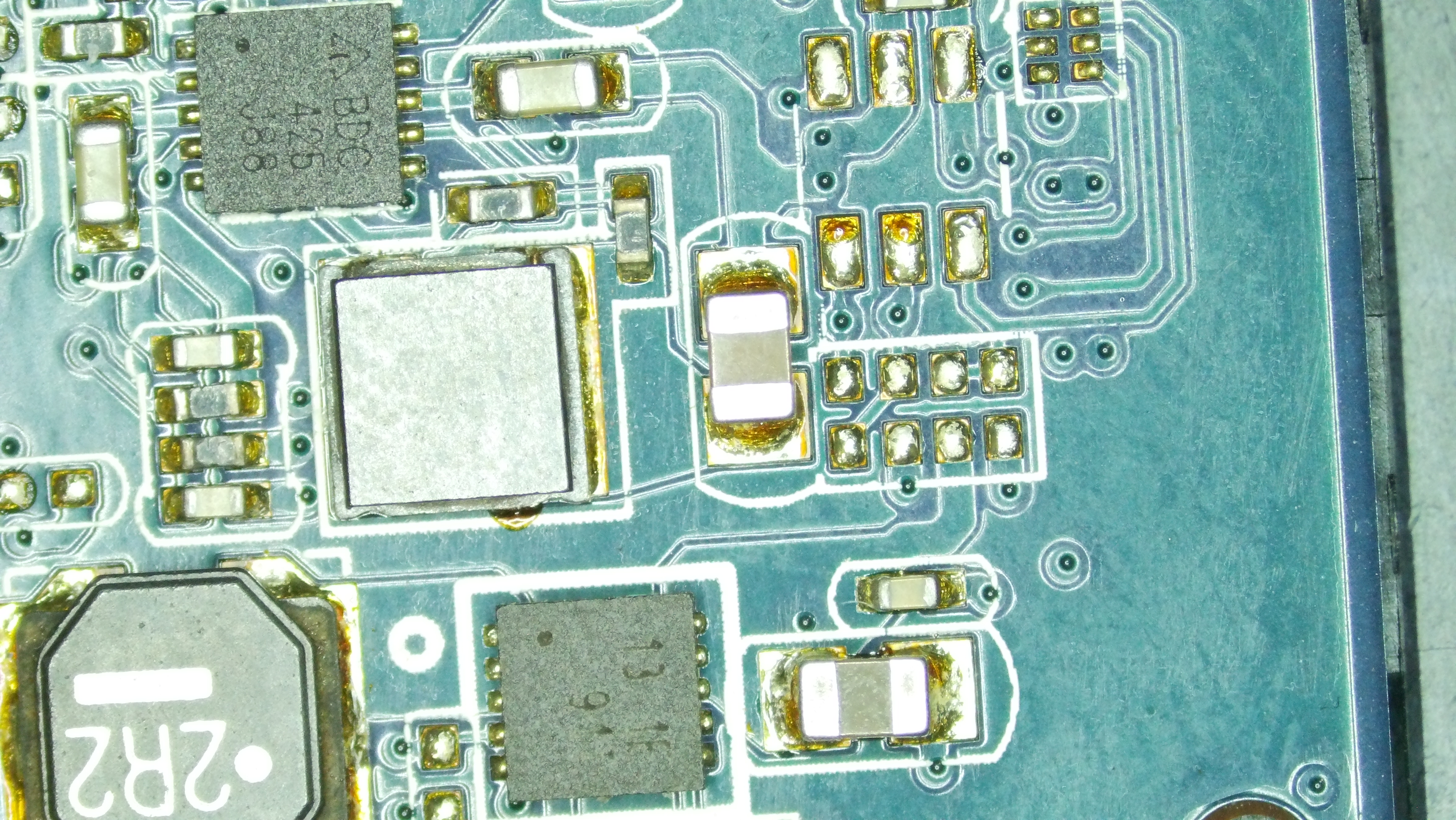

Location: SSD_Drive
thanks a lot
here they are
I hope its clear enough
PostPosted: May 9th, 2018, 22:14
Posts: 17256

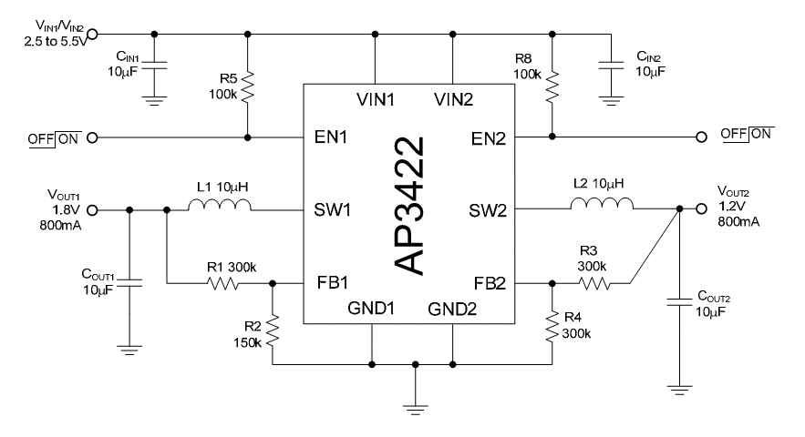

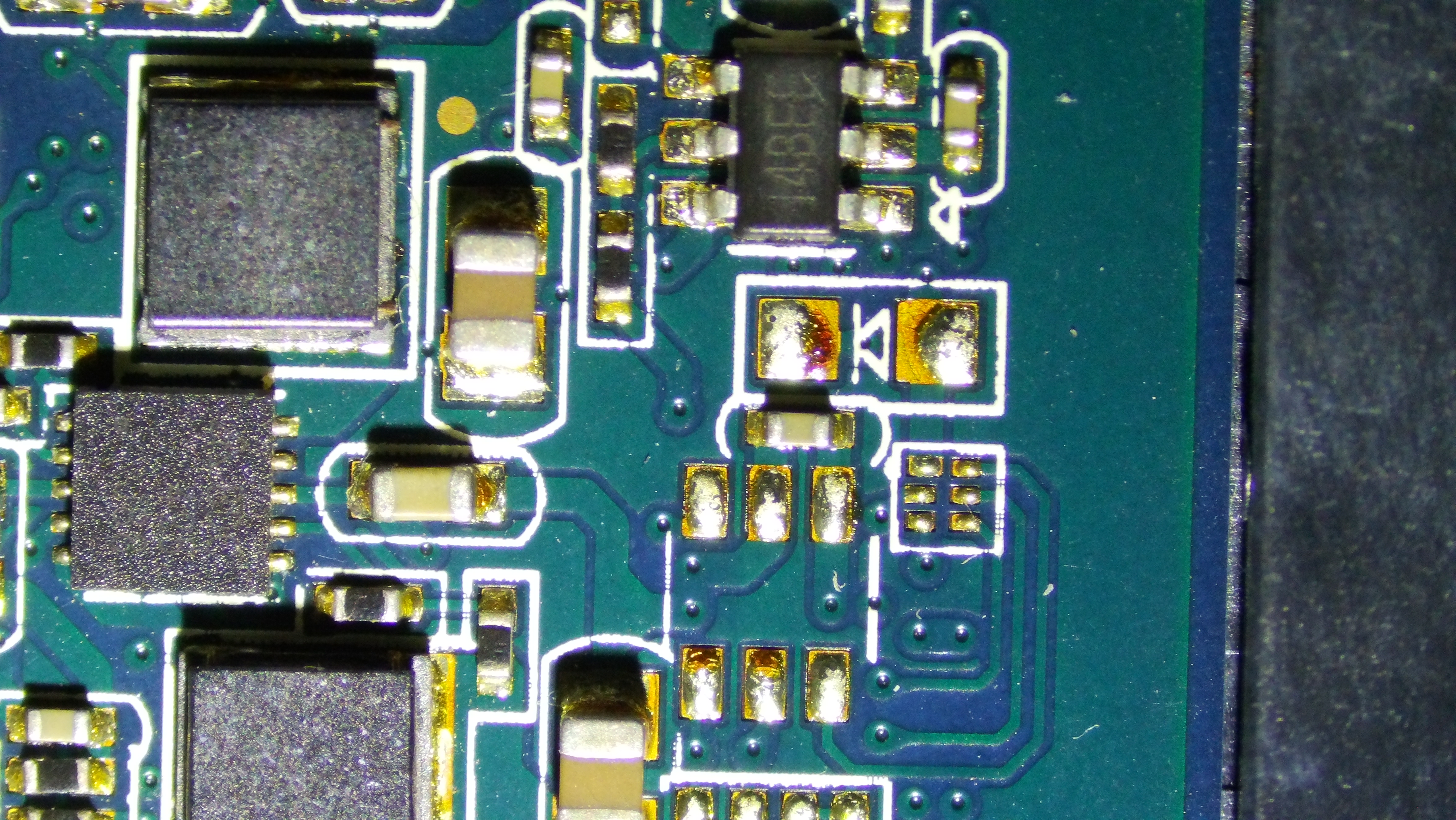

I have re-annotated my e-fuse image in light of your better photos. I mixed up the 5Vin and 5Vout, but if you observed both voltages, then the e-fuse should be OK.
The chips marked "13 1E" would be equivalent to the APW8804, so you can measure their PVDD and VDD supply pins.
The "BDC" chip provides two supply voltages. I would measure its supply inputs and also the inputs for the other DC-DC converters
AP3422, BCD Semiconductor, Dual 1.1MHz, 800mA Synchronous DC-DC Buck Converter, 2.5V - 5.5V in, marking BDC, DFN-3×3-10:
https://www.diodes.com/assets/Datasheets/AP3422.pdf

chip 4Bxx:
pin 1 = 0.01-0.0V
pin 5 = 0.11V
pin 6 = 5.11V
PostPosted: May 10th, 2018, 15:48
Posts: 17256
@Kingston, all the regulators are getting their 5V supplies, but only one of them is enabled (pin #6 of BDC). You stated that the output of this regulator (V3) is 0V, yet we can see 0.508V at SW2. This implies that the regulator is trying to do its job, but is being overloaded. I suspect that all the other regulators are waiting for this main (?) supply to come up to spec before they are enabled by their supervisor ICs (or by POK from APW8804 ?).

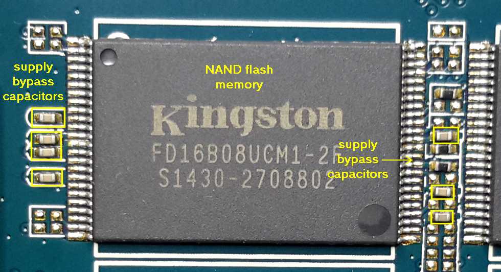

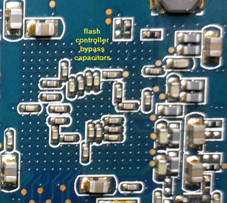

Next I would try to determine the function of V3. That is, does V3 power the SandForce controller or the NAND chips? To this end I would measure the resistances of the bypass capacitors at the controller and one of the NAND chips. Note that some of the components at the controller may be inductors, so they will normally measure close to 0 ohms. If you suspect that a component is an inductor, then measure its resistance to ground. It should not be 0 ohm.
PostPosted: May 13th, 2018, 14:15
Posts: 22
Location: SSD_Drive
they are all (V1, V2, V4 and all the marked components (capacitors/inductors)) shorted
PostPosted: May 13th, 2018, 15:18
Posts: 17256
Are you sure you are measuring 0.0 ohm and not "OL" (overrange)? What do you see when you touch the probe tips together? What do you see when you separate the probe tips?
PostPosted: May 13th, 2018, 16:16
Posts: 22
Location: SSD_Drive
unfortunately I'm sure
when I touch the probe tips together I'm getting 0.3 (and that's (0.3) what I'm getting when measuring the components)
when separated I'm getting OL
furthermore, I made A continuity test too, and everything (V1, V2, V3, V4 + all capacitors/inductors (supply bypass capacitors) marked by you) is beeping
