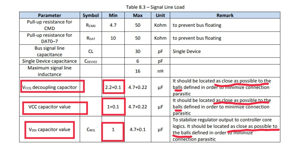

I also discovered the VCCi ball of the chip is not connected on the adapter. And it's not good because all mmc datasheet tells a decoupling capacitor must be installed between this ball and GND. It's to filter an internal voltage regulator output. And I discovered yesterday that the internal nand is supplied by this internal supply, because all signals between controller and nand are 1.8V.
Don't know if it's really the reason why this chip is difficult to read correctly without ECC errors, but it's possible!
No, it's not possible, capacitors not magically resolve error problems, even best supply quality not help. In Hynix nand memory leaks charge of cell are common, and only RR help.
Nand memory that you can read without errors are that's one who have build-in hardware ECC aka E2NAND or EZ-NAND. So, for this memory you must have ECC and RR, and it's not all, you will find out sooner or later.
 Post subject: Re: Which NAND flash reader ?
PostPosted: May 30th, 2020, 11:26
Joined: May 12th, 2020, 11:27
Posts: 43
Location: France
I don't say it will resolve anything for now. I say the datasheet says some pins need decoupling capacitor as close as possible to the ball.
For sure they matter, in particularly when pcb track between supply and chip are long and inductive. If not, the datasheet wouldn't say to install them.
I do hardware engineering for more than 20 years now, and without decoupling capacitors you can have some strange behavior, in particular with high speed digital components. You can try with any microcontroler , without good decoupling, it can works, but your analog/digital conversion result will be less good than with decoupling capacitor.
You can open any electronic product you want, you will find them everywhere.
With decoupling capacitor now the nand adapter also works like a charm in SD/MMC mode. Without, it doesn't work.

Gregory wrote:
we speak about NAND protocol not only SD.
Sorry but it make no difference, take any nand datasheet, they also require decoupling capacitors.
Nand is also high speed digital devices, they require a stable supply. MLC nand chip use analog value to store bits, any conversion noise because unstable VCC can cause bit flip during analog reading if bit are close to the threshold.
If you have not tested, you can't affirm reading quality will not be better with it.
Have you tested ?
But that's true I can't affirm it will be better with it. It will be difficult to test, because I don't have access to the VCCi ball.
PostPosted: May 31st, 2020, 2:16
Posts: 3975
is that the Datasheet for the eMMC? generally they do not include the Raw NAND details, or even the pads from the NAND chip, so we basically read it as if it is just a NAND chip. a 1k resistor between VCC in and RB may be required though.

That's an eMMC datasheet, but not this model in particular. But all models require decoupling capacitors.
The Nand part and pad position are not documented, and yes RB need pull-up
