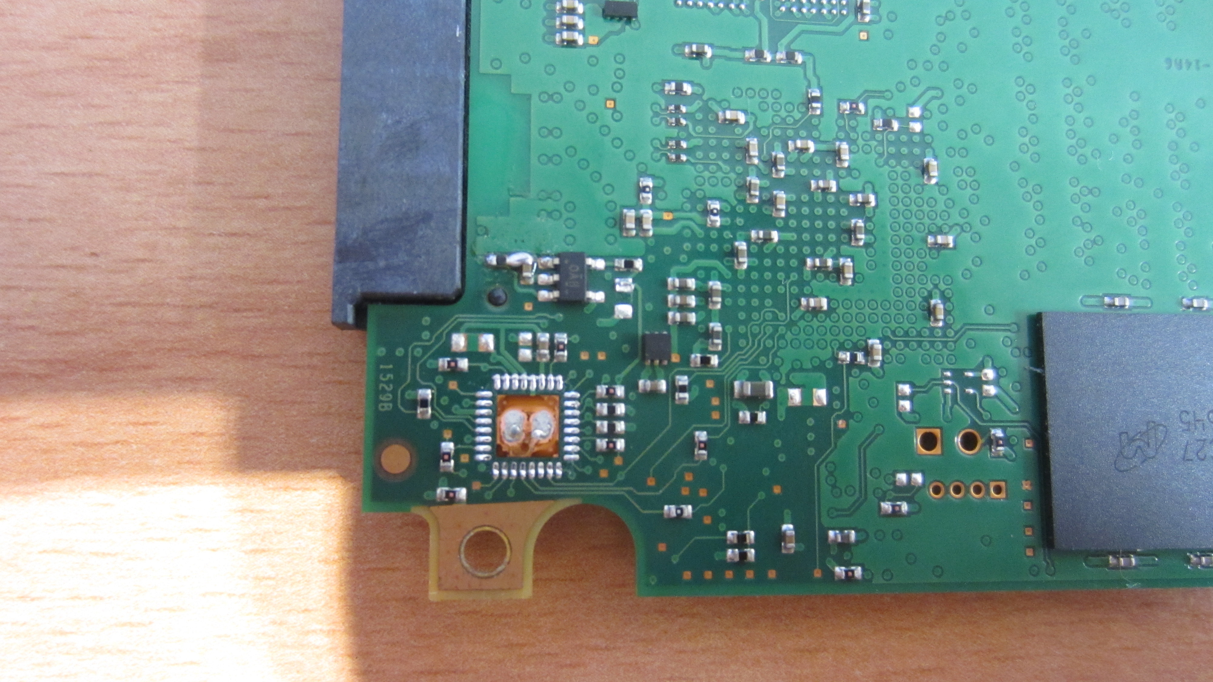

Could we see the area under the MSP430 chip? Does it look like it might be a standalone MCU?

Absolutely.
I can also confirm that all 4 enable pins of the 3x RAU and 1x ODH chips trace directly to one pins for the MSP430.

Thanks. Another thought is that the MCU might be monitoring the actual voltages and generating a PowerGood output for the flash controller.
If all chips use a common enable pin, then that makes it a lot easier. Perhaps we don't need to worry about power sequencing. Would it be OK to add a 1K (?) pullup resistor between the EN pins and the 3.3V supply?
The MP5505 has its own enable pins. Do you think it would matter if this chip were switched off? AIUI, its function is to provide a voltage for the backup capacitors and to keep the SSD alive in the event of a sudden power failure.

If that's the case, would something else enable the regulators? Is the ADC periphal capable of doing this?
Also you've mentioned twice that the order of enabling the regulators is of importance. Is that something common to SSD/HDD chips or is it possible the order may not matter at all?
I could lift the EN pins from those chips and toggle them manually. At 16 combinations finding the correct one shouldn't be too hard. But then again, transplanting from a used replacement sounds like a better option.
My bad, I should clarify: the 4 enable pins all trace back to different pins on the MSP430.
I agree, the 5505 seems only for power storage/backup functionality, so I doubt it's important for normal operation.

Unfortunately the 4 enable signals all route to different pins on the MSP. I'm tracing them now and I'll pull them up.
The ODH mode switch signal also traces back to the MSP430.

The RAU output voltages don't trace back to the MSP430 but they do have traces to the BGA of what I think is the micron controller.
I'll try to source a used part tomorrow and if that leads nowhere I'll see what happens if we force-enable the regulators and fake the power good signal.
