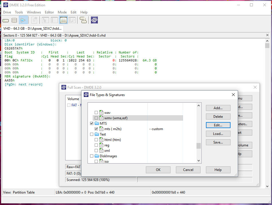

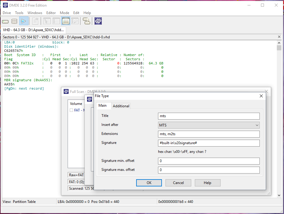

In DMDE, select Tools -> Full Scan. Tick the Raw and FAT checkboxes. Under Raw:File Signatures, uncheck everything and then Add your MTS file's signature and properties.
Hi, I've did all this. Have ran a scan, but nothing was found. Can you please check the properties that I've added? I suspect that something is wrong with the signature (#built-in signature# appears as #built-in\x20signature#).
https://drive.google.com/open?id=0B34Te ... k5ZcnhDdU0
https://drive.google.com/open?id=0B34Te ... XlOUUM0OGs
Here is some example of right signature:
https://drive.google.com/open?id=0B34Te ... jBnR3R1bG8
Thank you, fzabkar

fzabkar, I've wrote an answer to you yesterday buy it wasn't appear here until now.. How much time it takes to approve a post?..
I've wrote that I've made new file signature for MTS file in DMDE and ran a scan. Nothing was found. Maybe something is wrong with the custom signature that i've made.
And, unfortunately, I don't know how to search for a header of a file in hex editor..

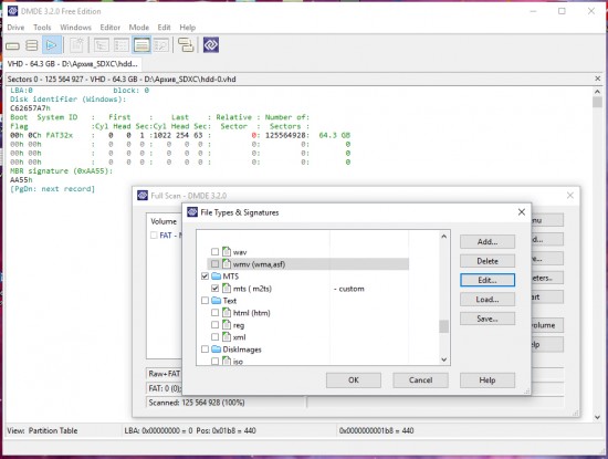

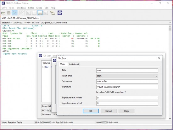

fzabkar, I've posted wrong screenshots before. Here is the rights ones:

Here is the header of an MTS file which I recorded off a digital TV transmission (SBS_TWO is the TV channel):
00000000  02 1E 15 76 47 FF FF 00 0B 00 53 00 42 00 53 00  ...vGÿÿ...S.B.S.
00000010  5F 00 54 00 57 00 4F 00 2D 00 32 00 30 00 31 00  _.T.W.O.-.2.0.1.
00000020  32 00 30 00 00 00 00 00 00 00 00 00 00 00 00 00  2.0.............
http://www.users.on.net/~fzabkar/temp/GermanyNetherlands2012Euro_start.mts
Simply open the file in HxD and view the data at offset 0. Your MTS file may have a different format.
In DMDE I might try searching for a custom header as follows:
    \x02\x1E\x15\x76\x47\xFF\xFF

It appears that the relevant part of the signature starts at offset 04. We would really need to see samples of your own files in order to configure an appropriate search string for your particular case.
