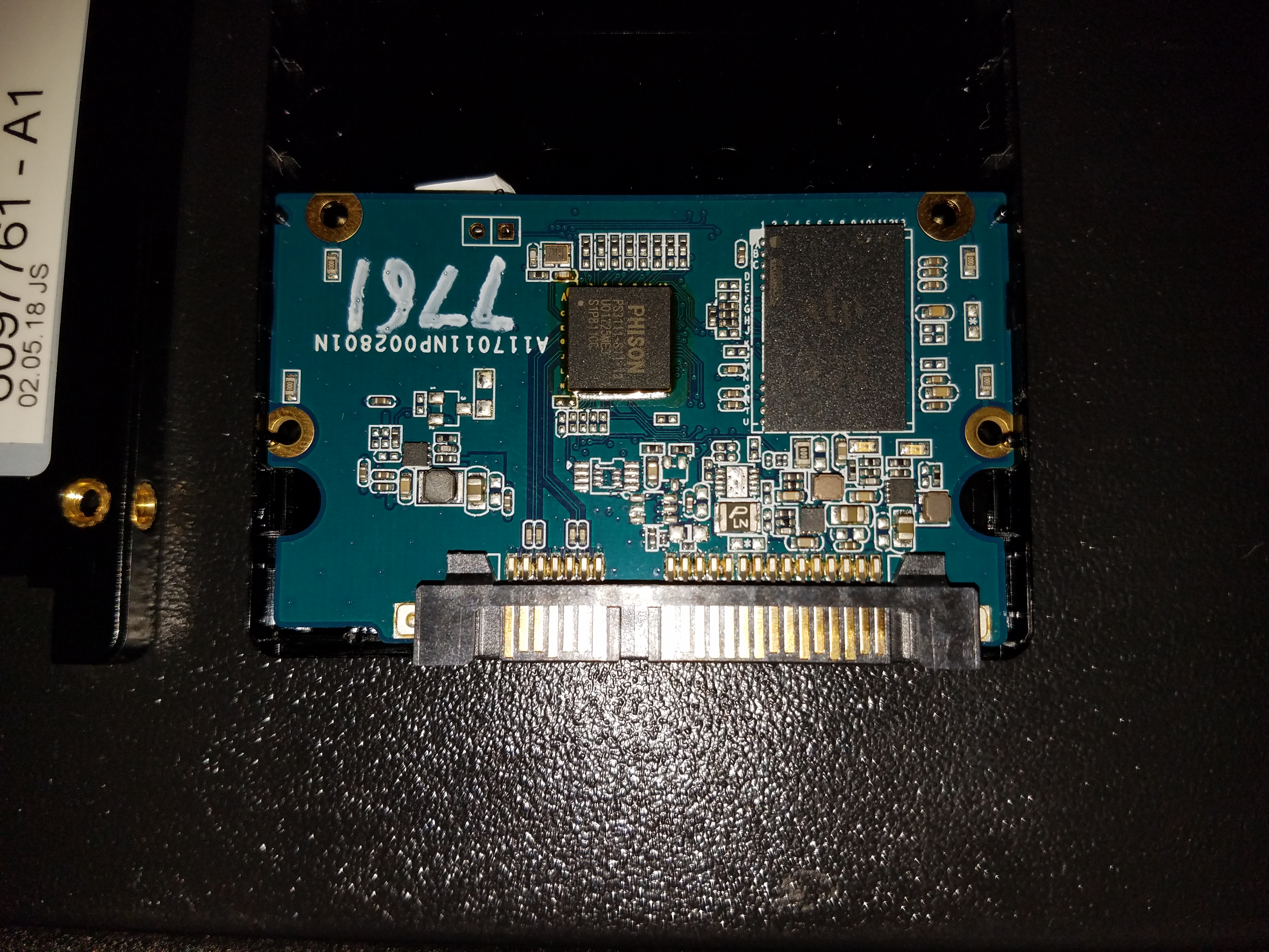

front of pcb board. when i plug the drive into a computer it install the drivers, but does not show up under My Computer. However, it does show in disk utility and is asking to be initialized (which i didn't of-course). This is what OnTrack DR told me:
They stated that the drive has "hardware failure" specifically "has faulty controller or NAND failure"
They also said "Raw Data Extraction from internal chips is not an option for this model" and that "We can’t pull the chipsets and image separate from the board so we don’t have an option "
Is the data still there? Can ACE recovery the data? Any est. on cost?

Ace says
The test results for your failed SSD storage are in and have shown that the device is physically damaged. There are missing SMT capacitors from the PCB wherein it looks like they were purposely removed. This has rendered the device completely dead. The quotation below is for repair and raw data dump and reassembly of the raw data into a logical format.
Why did OnTrack remove the capacitors from the PCB? If they didn't do this would the recovery be cheaper?
Ace wants $3,550. I thought it was going to be under 3g since the controller not encrypted (not a SandForce)?
How much to recover data if I wait for the assembler to be developed for this controller? Idea on cost? Would trying to recover with this assembler further degrade the data or recovery chances in anyway? Ty

Good grief! I have even less respect for the DR business now.
I would not let them do a "chip-off" without more investigation. I could help you carry out some basic tests. You would only need a US$5 digital multimeter.
I would need a photo of the other side of the PCB as well. If you have a CCD scanner (not CIS), that would be better than any camera.

That brown material around the controller wouldn´t suggest that someone already tried to replace it ? Also, if this was tried, couldn´t what Ace calls removed capacitors to be just empty pads that were fluxed and messed with when attempting to replace the controller chip ?
without before / after pictures, it is difficult to say for certain what happened.

I would assume if it was easy to get at OnTrack would glady charge me the $1,000 estimate they gave for recovery. I don't want to do anything myself if it can jeopardize the data in any way. Maybe price will come down in future. I appreciate the work everyone does here and I hope the price is fair market value, but maybe I should wait to do the recovery years down the road and get it done for a cheaper price. I need to get at the data sometime, but I don't mind waiting.

Here is an example for comparison:
PNY CS900 240G:
https://www.pixpo.net/technology/0IHuoP6d.html
https://img1.pixpo.net/img/1e/d/0ihuopuywl/sg_0IHuoPuYwl.jpg (controller)
https://img1.pixpo.net/img/a7/c/0ihuopb2lh/sg_0IHuoPb2lh.jpg (flash)
https://img1.pixpo.net/img/ad/3/0ihuoplmxq/sg_0IHuoPlmXq.jpg (PCB - component side)

Doesnt look like anything is missing to me. match up with: http://ssd.zol.com.cn/673/6732205_all.html I can't see anywhere you state the capacity of the disk. Most SSD drives have a lot of unpopulated pads
probably Kroll just fluxed it and heated Controller to see if any balls might have been unsoldered, and might resolder. perfectly legitamate thing to try if you dont have support for regular DR tools or chip off. HIGHLY unlikely anyone that attempts SSD DR will replace a controller.
Whats under the sticker on the memory chip, is it Micron 3D NAND or Toshiba BiCS2 TLC?
I take it the other side of the board doesnt have much on it?
This controller supports compression, and in my experience make things a whole lot worse for DR.

Ace are saying that someone physically damaged your SSD, rendering it inoperable. If you didn't do this, then it must have been Ontrack. If they didn't do it, then Ace have misdiagnosed your drive. Who can you trust?
You need to understand the nature of data recovery. Very few, if any, players have any understanding of component level electronics. When these people were recovering HDDs, they either swapped PCBs outright, or transferred the ROM chip from patient to donor. Now these same people are applying this "skill" set to SSDs. Essentially this means that, in the event of a physical fault, their only remedy is "chip-off" recovery. Ask yourself, if Ace has determined that the "missing SMT capacitors" are the cause of your "dead" drive, did they attempt to replace these capacitors before deciding on a chip-off approach? If not, why not?
