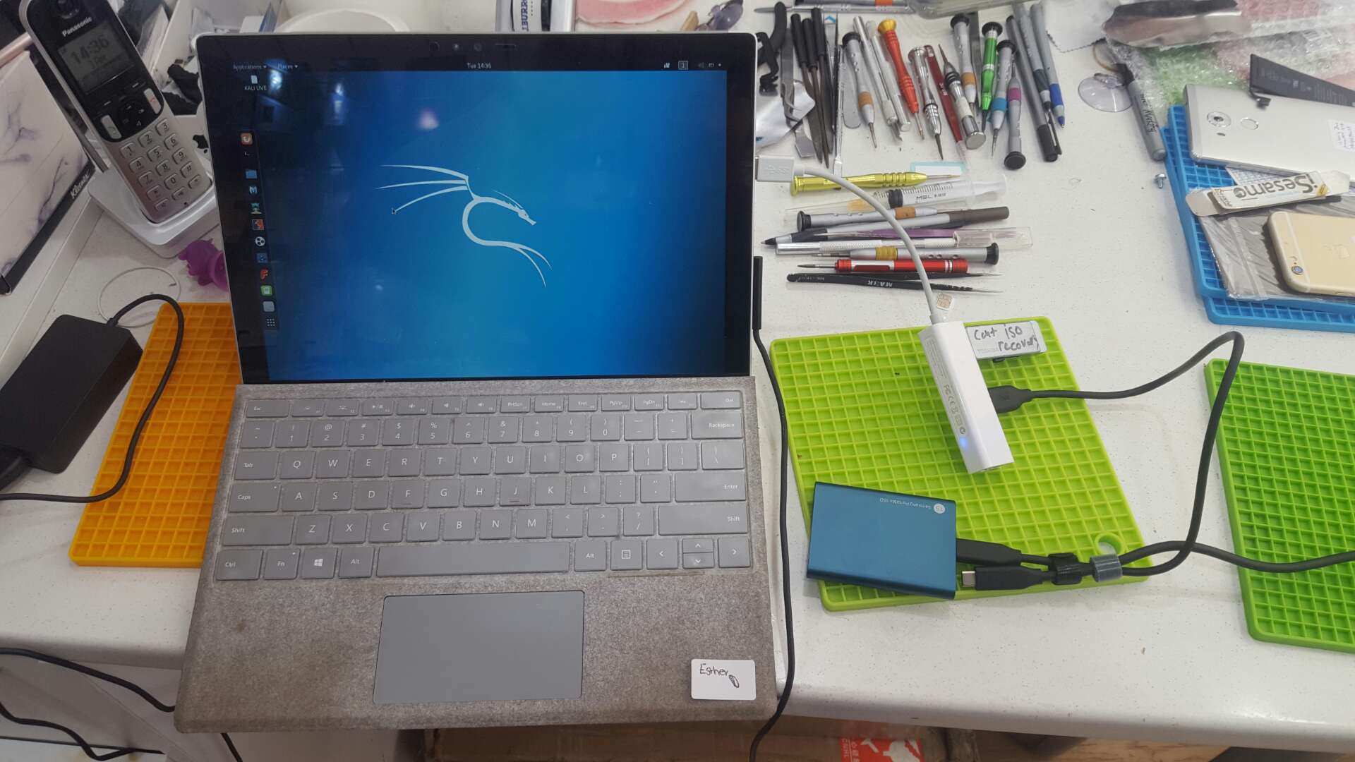

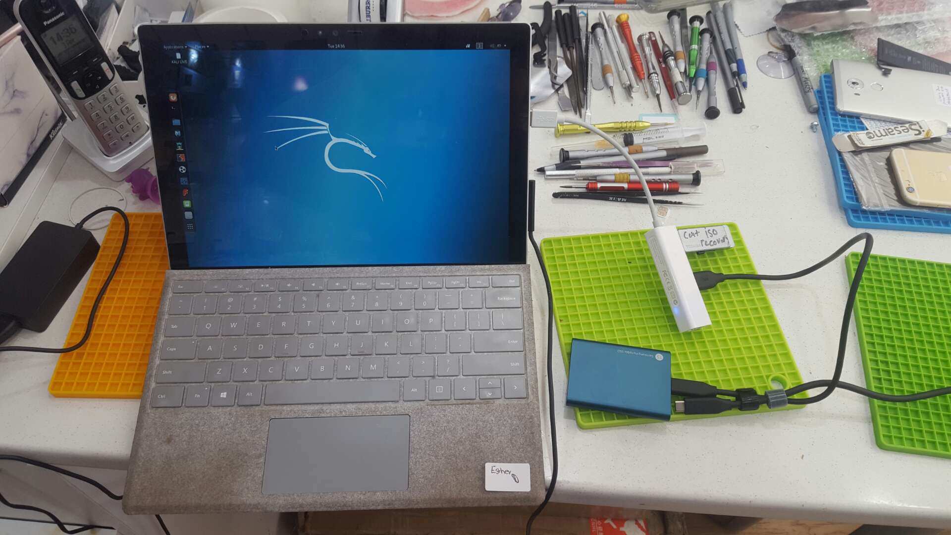

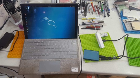

That's Kali for a recovery the other day it's easier to run dislocker our company dose 5-9 surfaces a week.if you need any help just pm and I might be able to help
File comment: Kali Linux surface pro

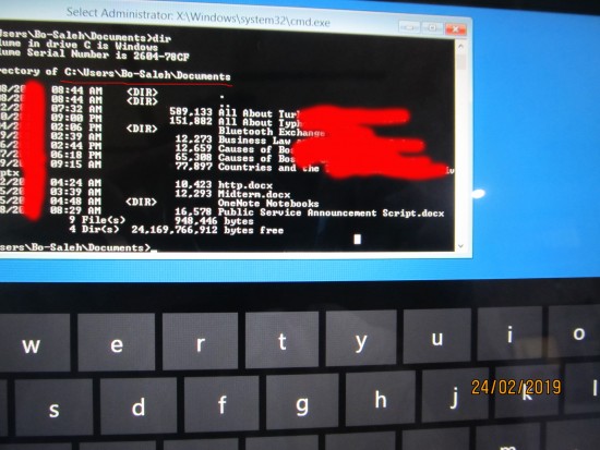

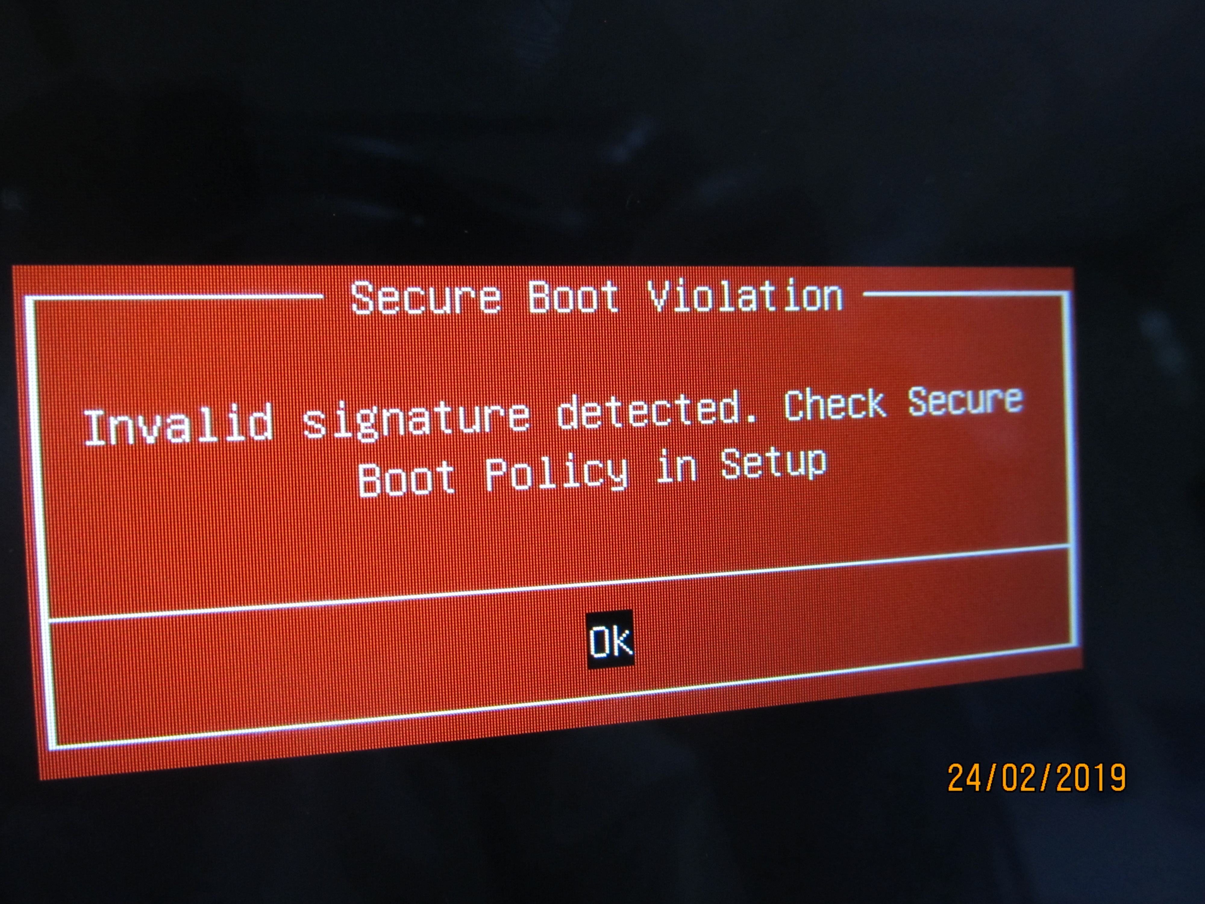

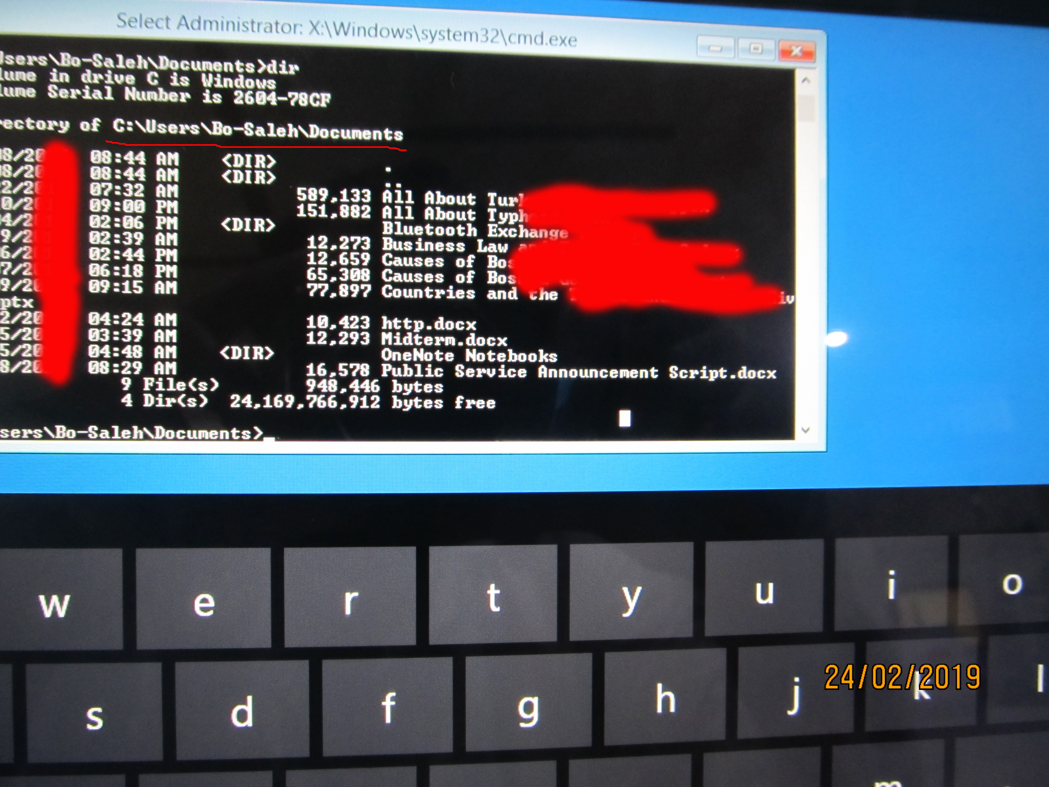

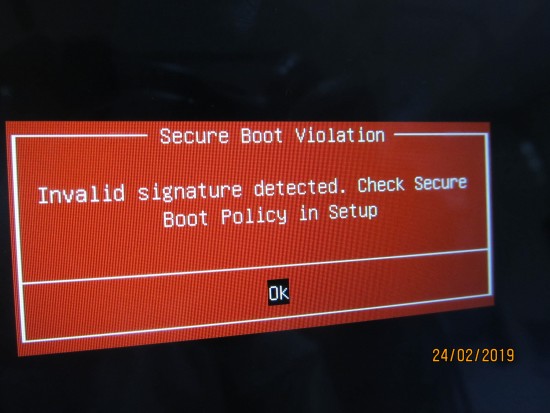

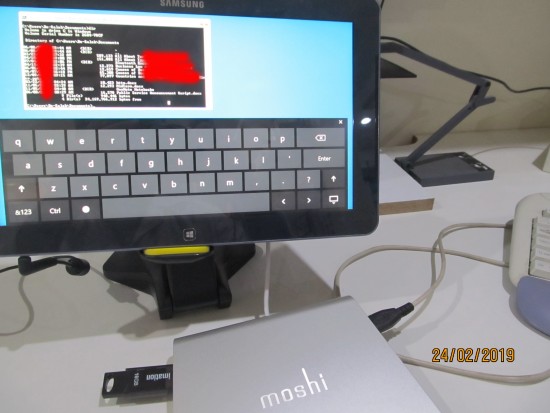

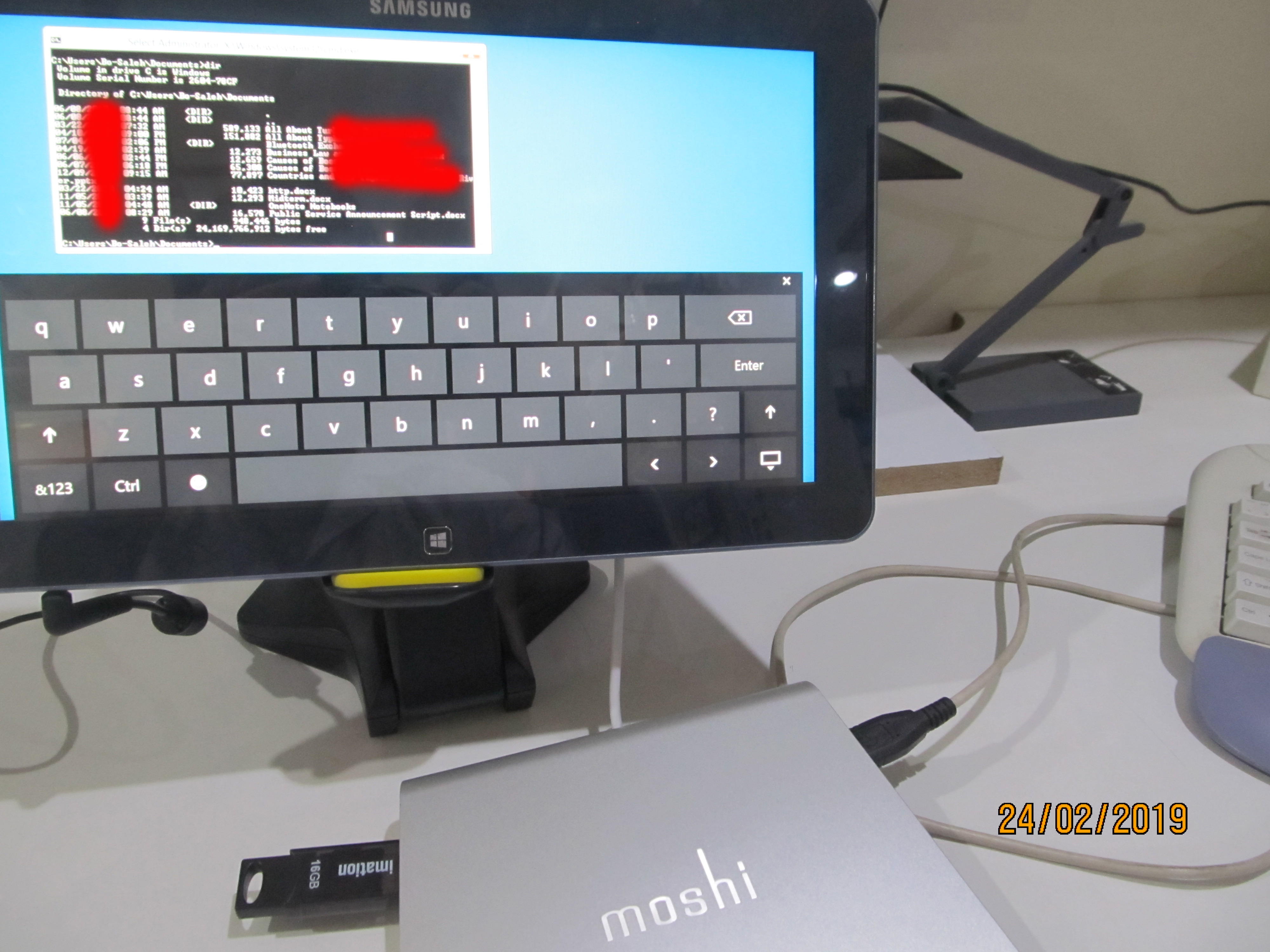

Update here,,,
Got another case but its done this time.. it took some time to understand why/how they blocked booting from ext. devices
:wink:

You can build a live ubuntu usb persistent storage thats what i do
