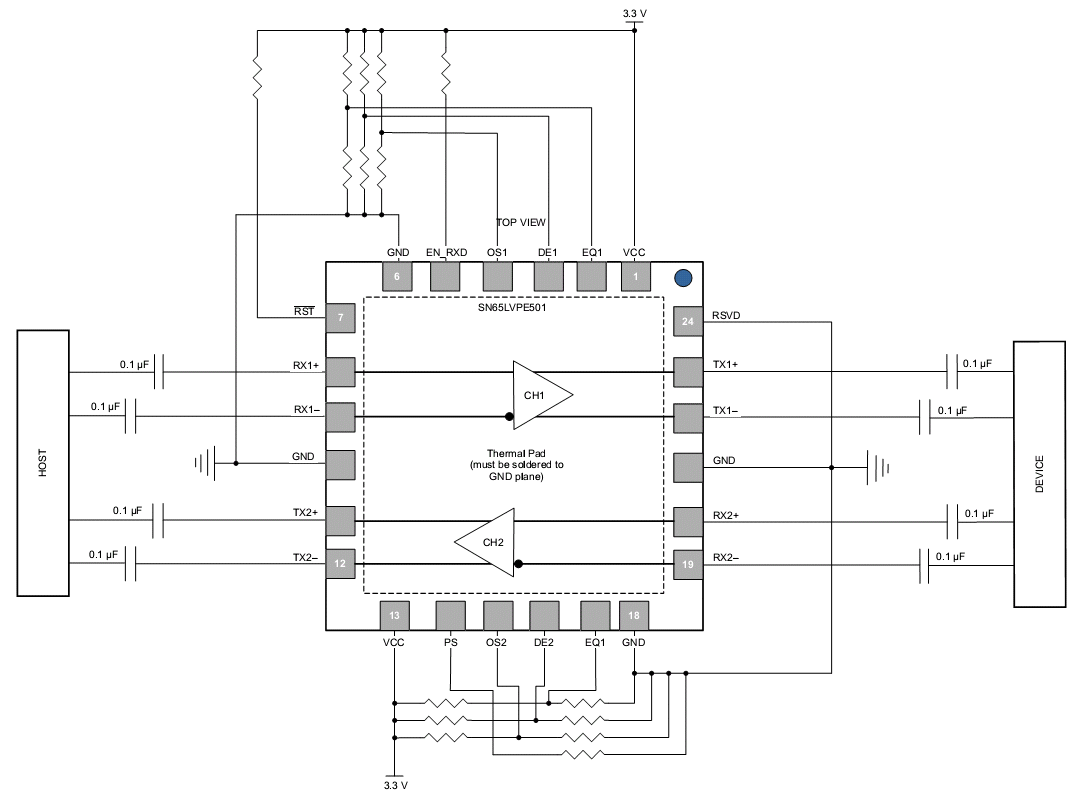

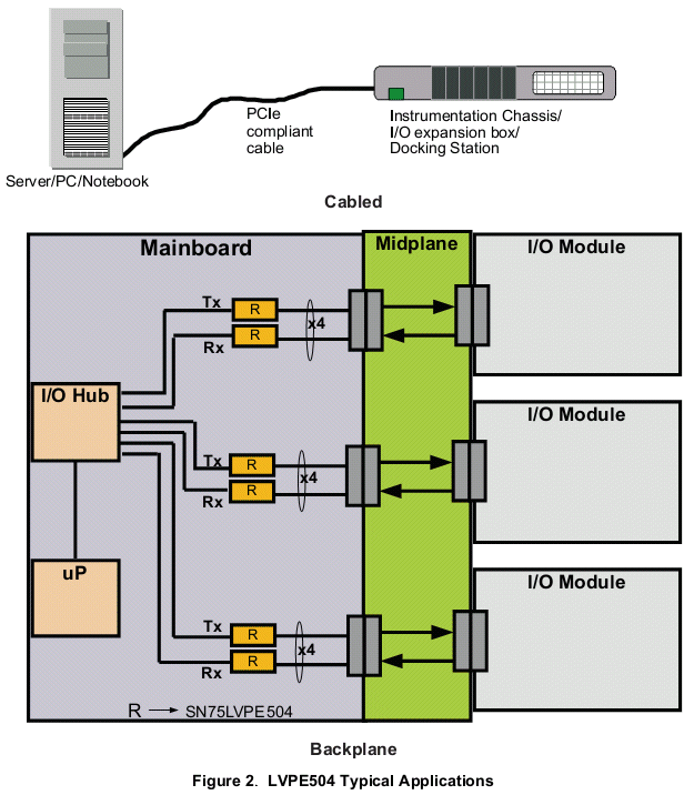

ISTM that the CD3215C00 / CD3215B03 chips could be 4-lane PCIe receivers/transmitters.
Here are two examples of standard parts:
Quad Channel (Half x4 Lane) PCIe Redriver/Equalizer:
http://www.ti.com/lit/ds/symlink/sn65lvpe504.pdf
Dual Channel x1 PCIe Redriver/Equalizer:
http://www.ti.com/lit/ds/symlink/sn65lvpe501.pdf
Therefore ISTM that the USB-C cable need not be an "active" type since there is a redriver chip at each end.
