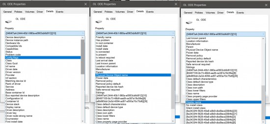

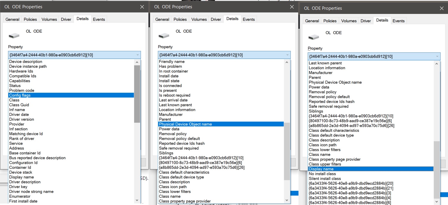

trying to repair a Samsung 850 EVO 2TB.
checked voltages, they seem ok, with the only mention that the 1.1 voltage reads 1.0v.
When I short the safe mode pins, the drive appears after some time, but not as a 500MB drive. It just appears in Disk Management. Magician doesn't see it.
In device manager it there is something about it, I uploaded the details from there.
I just want to have the drive working again, don't care about the data. I found a 500GB 85 EVO, that is recognized in windows, but is unable to copy on it (or at least that's what the seller is telling)
Can I swap the controller from 500GB to 2TB drive? Any chance to work ? Or should I try to hot swap and maybe Magician can write the firmware?

no chance that will work. I wouldn't trust the drive again even if you were to somehow get it going. Is it under warranty?

no it's not under warranty, because if it were....
why don't trust it? I don't understand? even if I replace the controller BGA chip ?
 Post subject: Re: Samsung SSD 850 EVO
PostPosted: August 9th, 2020, 21:14
Posts: 3929
ESPECIALLY if you replace the controller BGA chip.
unless you can diagnose EXACTLY why it is faulty, you are just guessing. lets say a capacitor was bad and it somehow killed the controller over time. you replace controller and it works. If you don't know exactly what was wrong, how can you be sure you have fixed it?
working =! fixed
