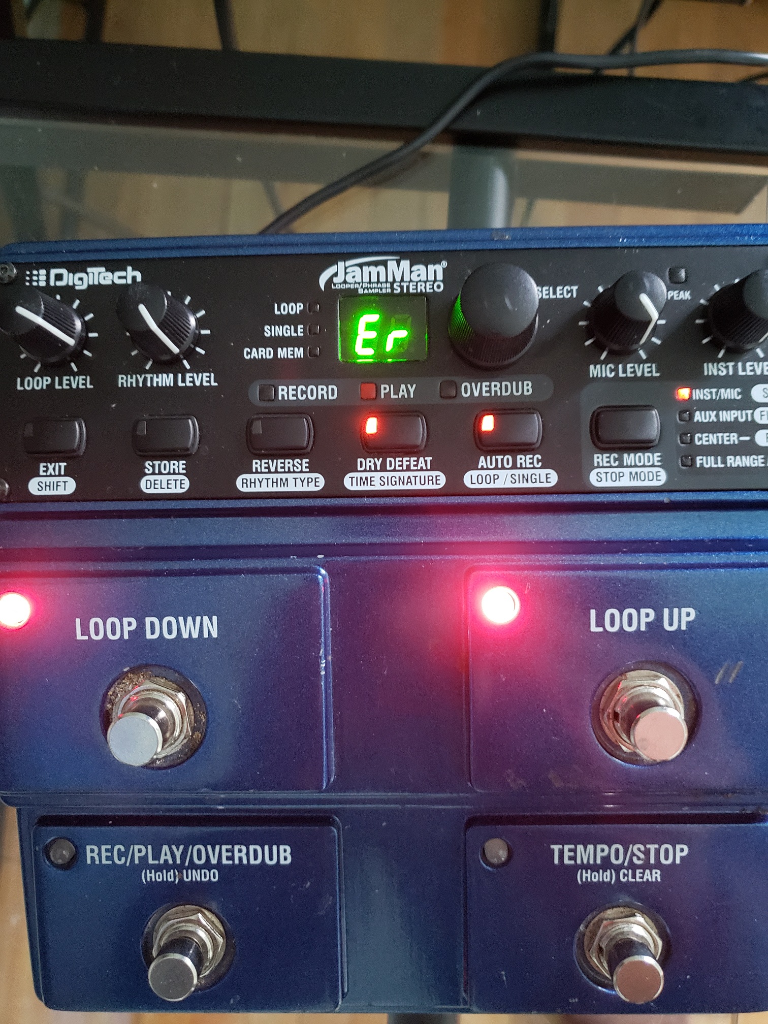

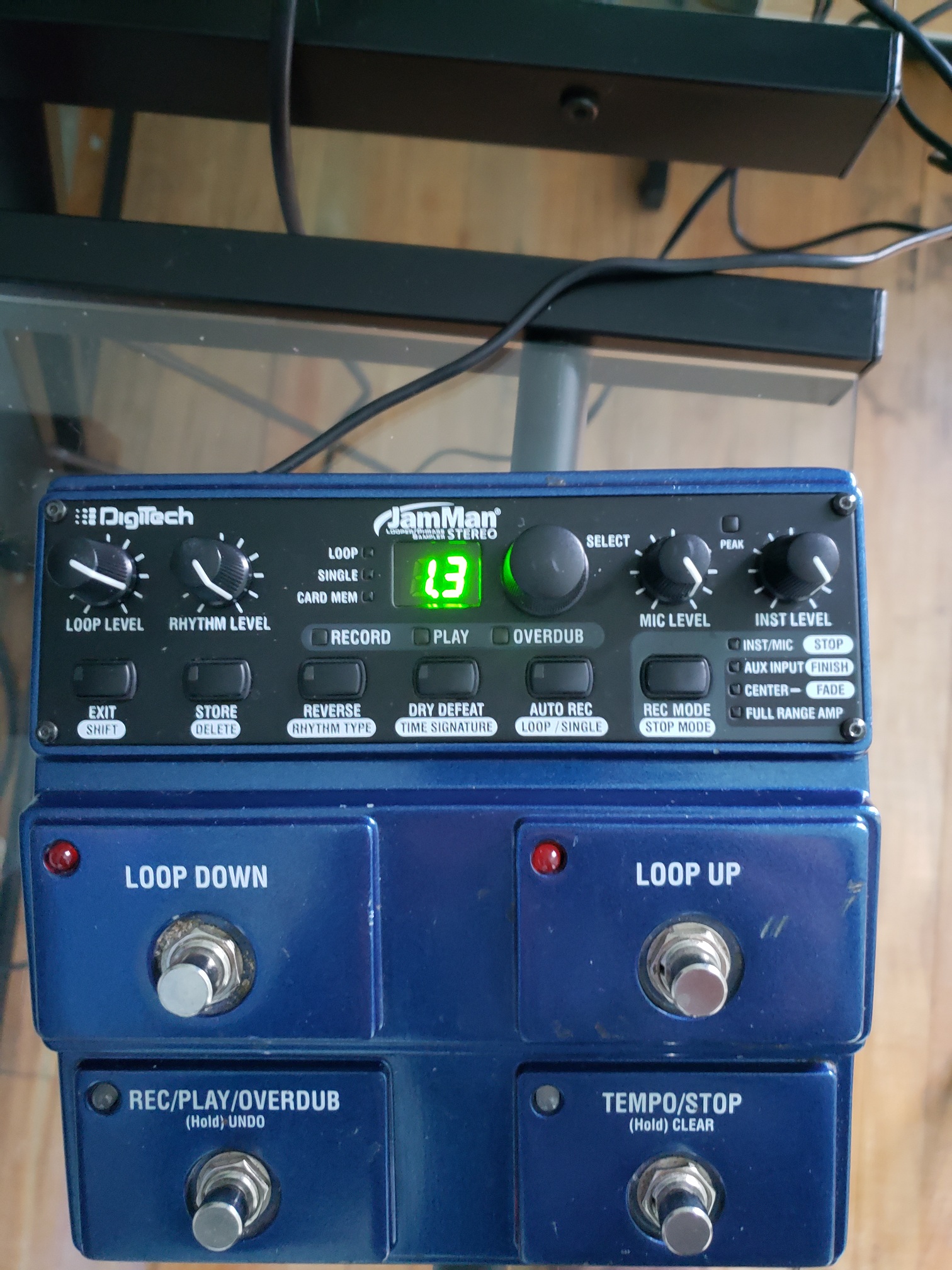

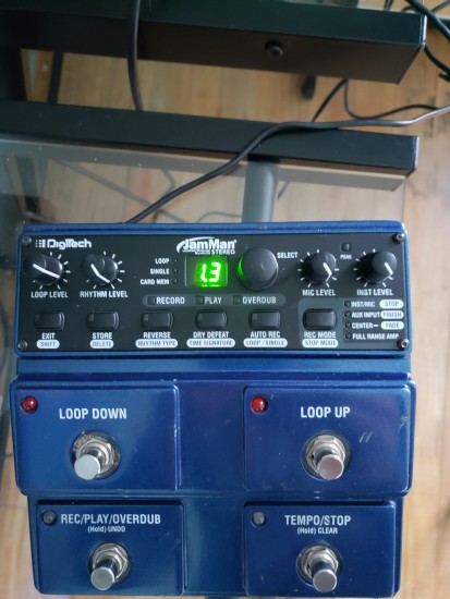

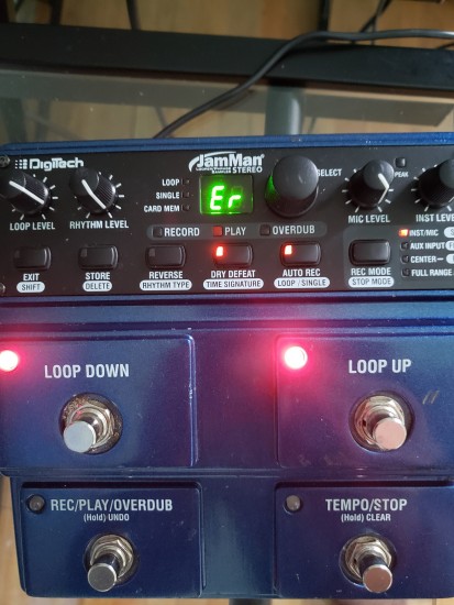

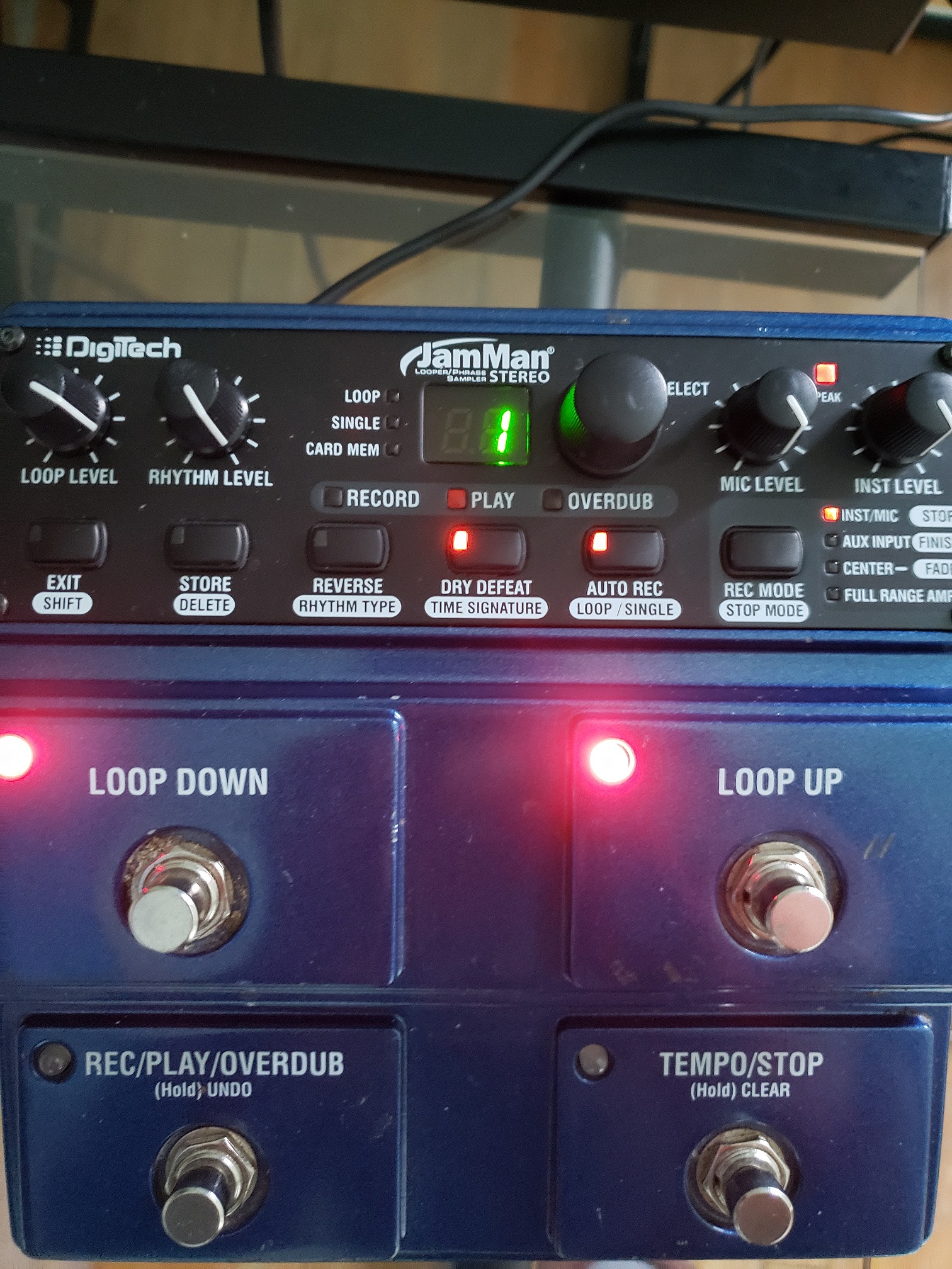

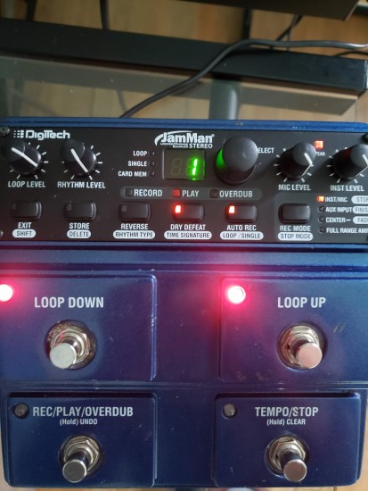

Hi,folks lets breathe life into old thread I need your expertise pls. Ive got jamman stereo looper that I used a a handful of years with no issues whatsoever . Well , it was such a day just plug it in and to my psu ... error on screen . I began searching for info then found this data recovery topic . But there is a big difference between cases . But fist things first . My internal memory is fully accessible via jamman xt so I copied everything to my pc and sc card as well . There's time for experiment now . What was done before anything else is attempt to default settings of course it didn't work out . All right then I tried to update firmware over jamman xt since it has old 1.3 version , in the moment of clicking on firmware update check now causing the program to crash immediately ( tested on both WIN 7 X65 and WIN 10 with same result ) . I took it apart and pulled the pcb board out and checked every component for soldering cracks blobs etc , nothing suspicious . I then moved on to voltage measures , everything within a tolerance (used datasheets provided in this topic as reference) . Well , what we have in the dry residue , control panel seems responds and works , switches up/down increase and decrease lcd loop counter. Also looper recognized when hook up over usb and I can erase any loop from internal memory but no recording anymore , and sd card works read/write when engaged green led on . A diagram posted here shows than Micron nand and sdram are sitting on the same bus . Could be a nand boot code is corrupt ? I can swap this bga chip with brand new no problem but will atmel mpu boot up with blank nand and download firmware via usb ? as to sdram nanya , can we make assumption that both chips are alive as I said I can copy any recorded loop from internal memory and back . Needles to say that Digitech didn't even replay to me , what I wanted is to try very last resort flashing boot firmwire from sd card that I couldn't download from resources . have any ideas how to fix it pls share your thoughts here . I will be very grateful
