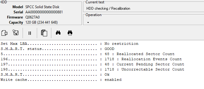

Our little experiment didn't work on this occasion. I think the principal was good, but the drive still goes BSY trying to read a sector. The drive stopped responding altogether at 2.7v, which I guess is no surprise.
It is a strange one. The generic utility in PC3000 even reports SMART status....

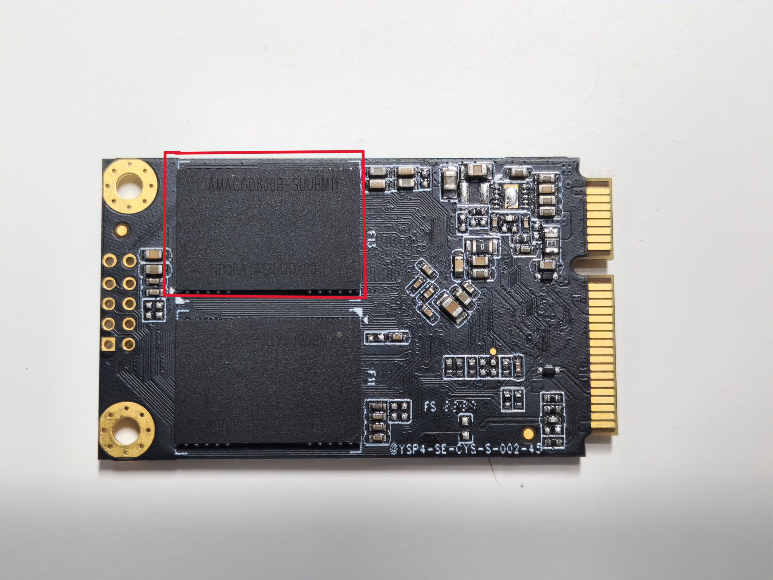

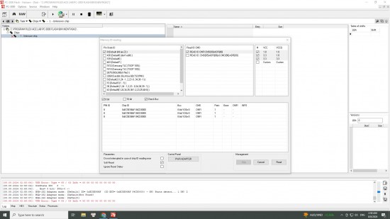

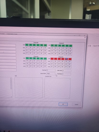

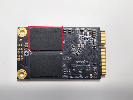

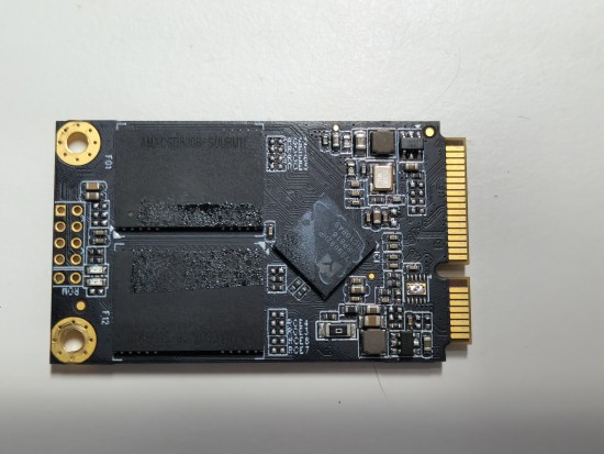

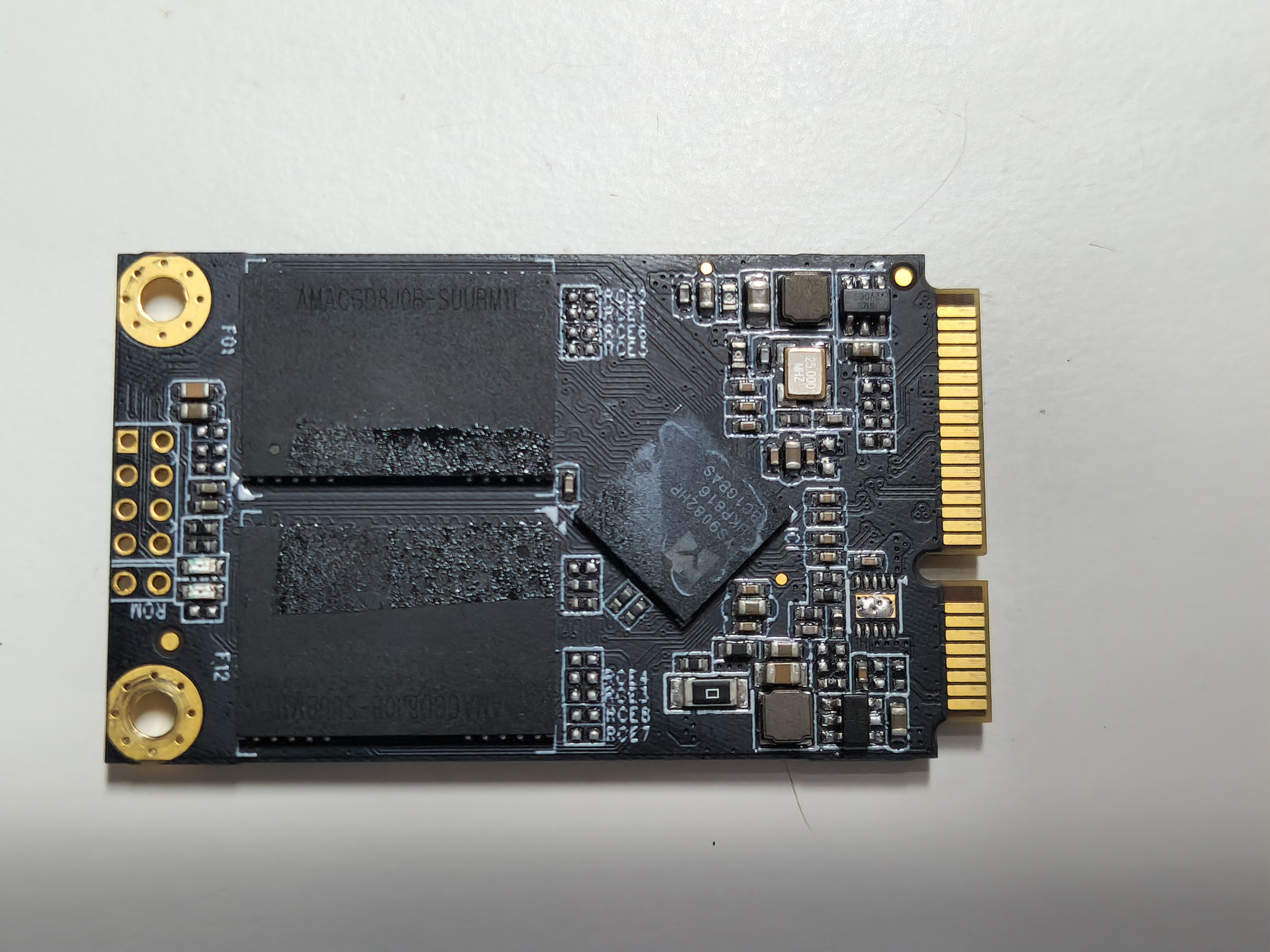

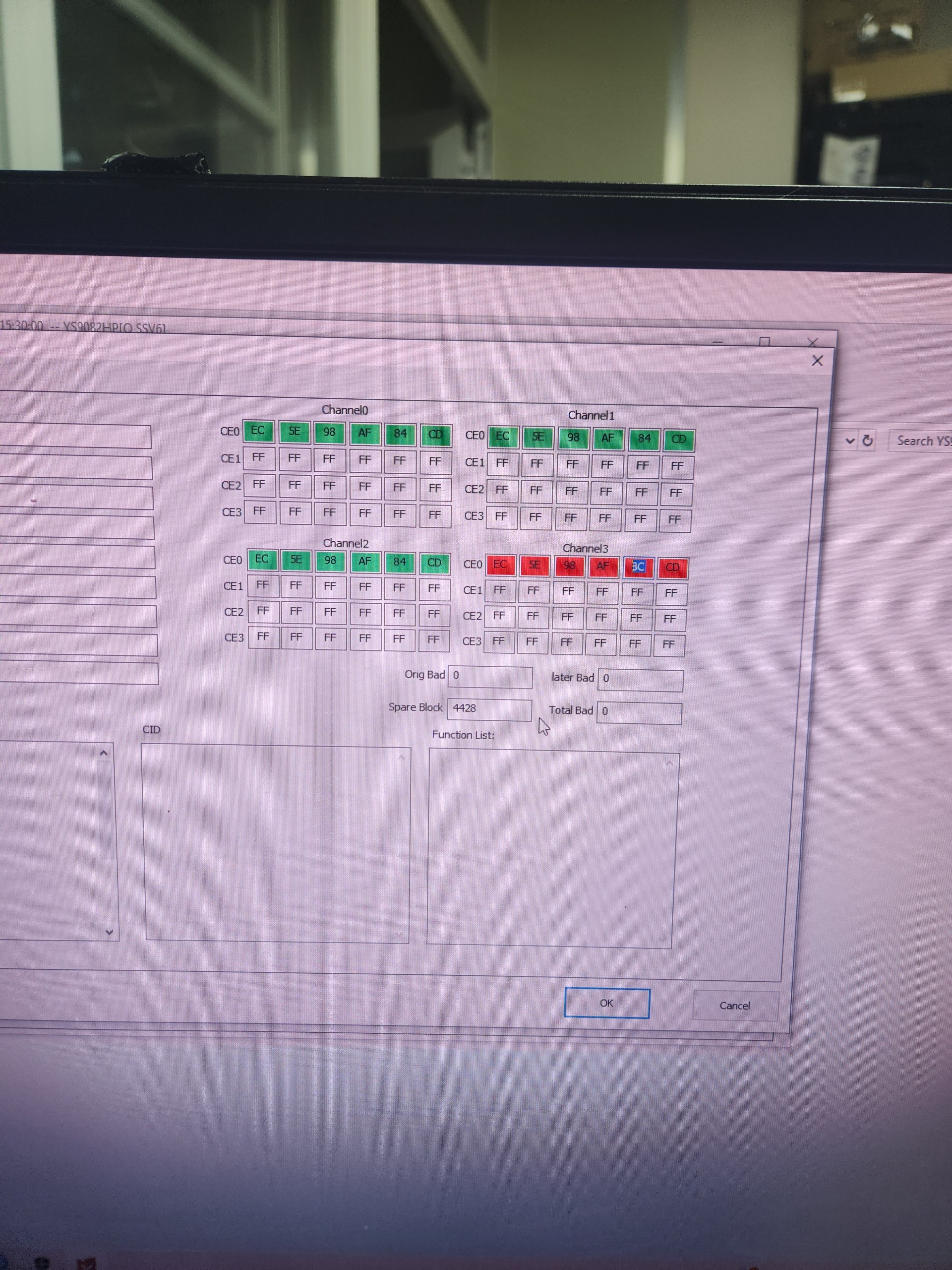

Ok i am digging this up cause i find it fascinating, and having the same exact problem. And might even get lucky with it
So i have a case https://forum.hddguru.com/viewtopic.php?f=10&t=44566

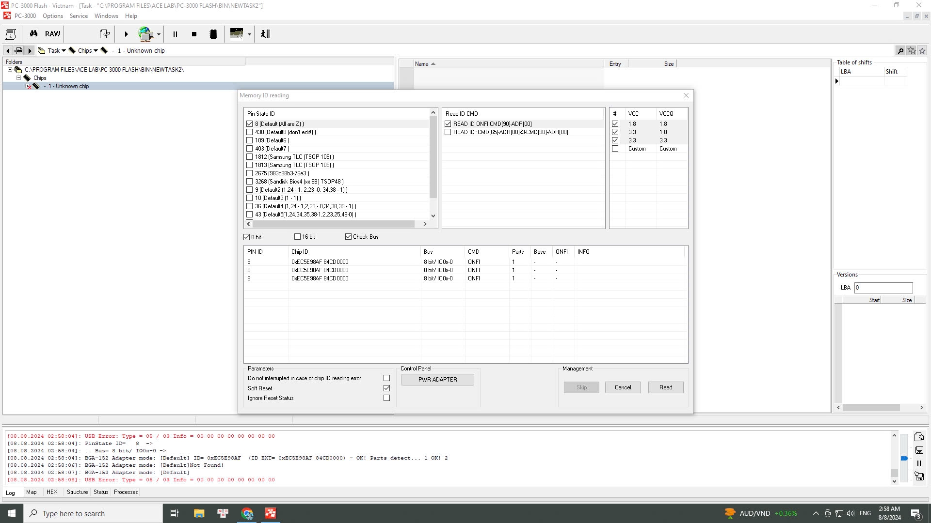

Upon using MPTool to read out Chip IDs i found out Bank 4 of Chip 4 is wrong, Instead of 84 it shows 8C
However, when doing chip-off to id it on PC3000 i get a good ID with 1.8V Vcc 1.8 Vccq
So now im trying to find a way to send out 1.8V Vcc to that chip/
Thanks fzabkar for pointing out the right direction
File comment: Faulty chip and Back
File comment: Front
File comment: Not Faulty in PC3000 Chip off VCC 1.8
File comment: Faulty ID in MPTools
