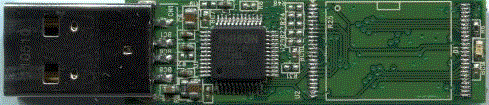

arvika wrote:
fzabkar, from my experience for about 10 years I meet only three cases that TOSP48 have other pinout than standard. Anyway, it is easy to check.
Here is one:
http://www.users.on.net/~fzabkar/temp/photo_188_TSOP48_ONFI.jpg
Here is one:
bottom pictured chip is TSOP-56
but anyway, doesn't really matter what the chip is, just need the pinout. I would heavily lean towards standard TSOP48 pinout.

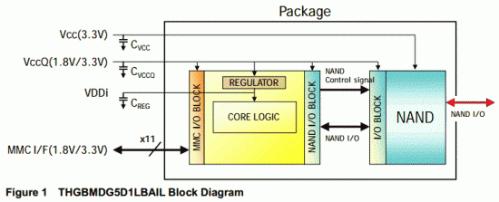

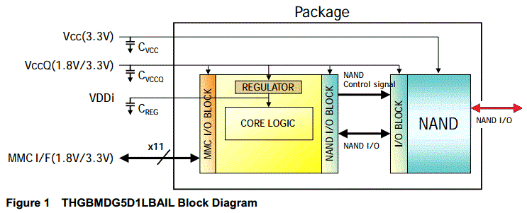

That hacked TSOP-56 chip appeared in a thread where the OP connected it to a standard ONFI TSOP-48 jig. Incredibly, the chip was not damaged. Since the example in the current thread is non-standard, it would seem prudent to at least locate the power rails and determine the respective supply voltages before proceeding.
Moreover, I see that the MMC interface balls have traces which appear to be wired to the TSOP pads, although I can't be certain of this. If true, then I can't see how one could access the NAND via this path. This is what led me to speculate that the controller may have an alternate function, possibly a USB-eMMC bridge.

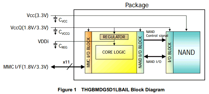

I added what the data sheet wont show you:
I often see pads on the PCB that make no sense, and I assume it is because a board could support a few different chips, capacities, or the developers revise the PCB and don't bother to erase the original, just do the minimum to add support for what they need at the time.
BTW, maybe I am having a blank mind day, but I cant remember when I last saw an external eMMC controller chip.

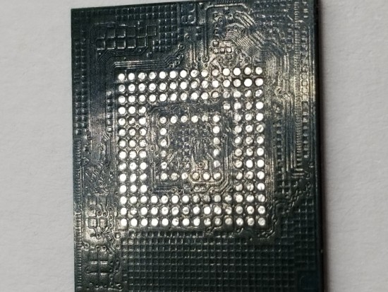

I traced the pinout as best as I could. There are 3 sets of 3 balls at 3 corners of the BGA. These are wired to the NAND control pins (R/B, CE, ALE, WP, etc) at the TSOP-48 pads.
The eMMC Data_0 - Data_7 balls are wired to TSOP pads IO_0 - IO_7. There must be something going on inside the chip that isn't shown in the block diagram.
I can't see where the CMD and CLK pins go, but there appear to be pullup resistors in the vicinity.

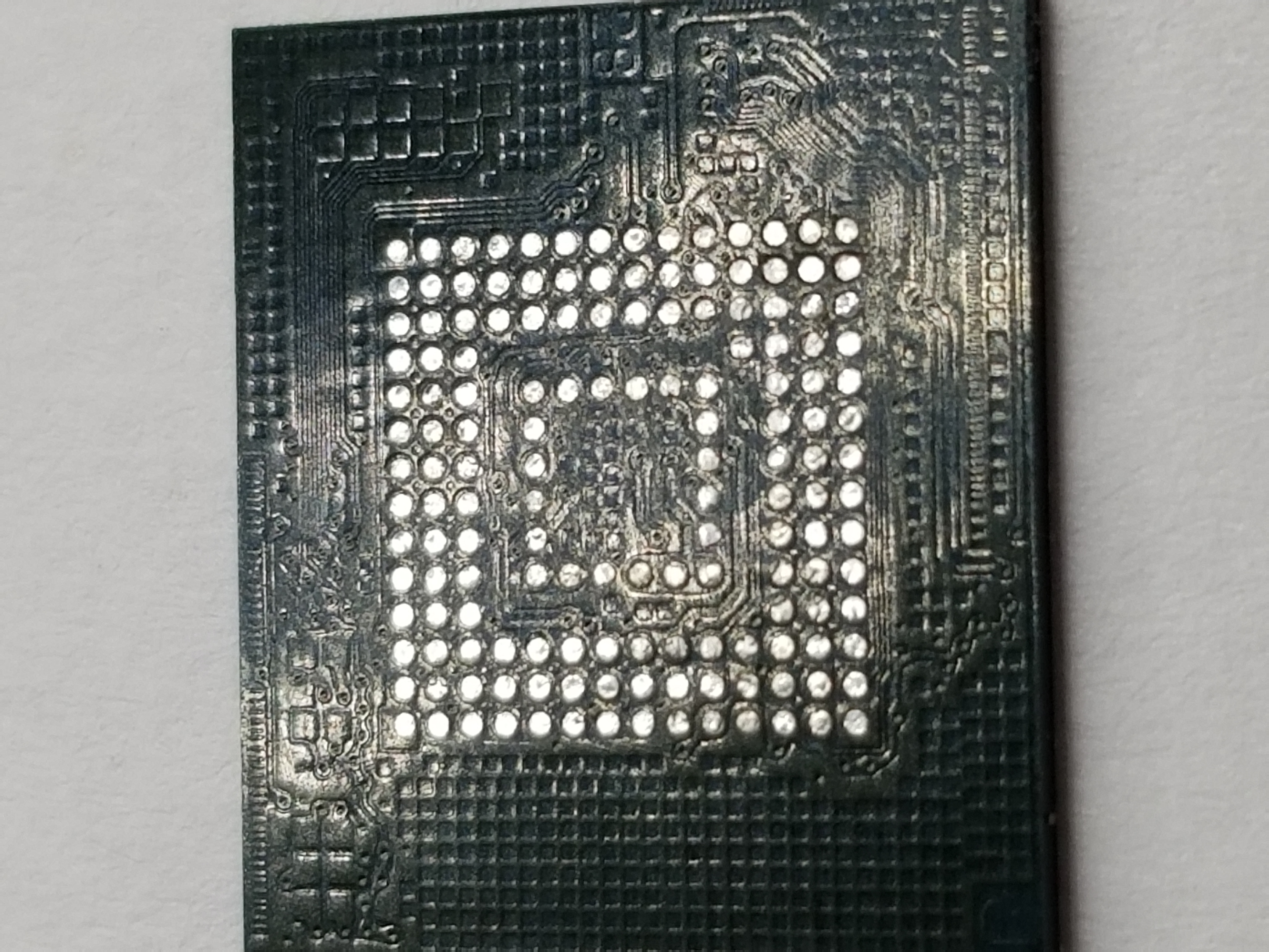

Here you go JB. I will be working on this today hopefully.

AISI, pinout discovery is just a matter of tracing the connectivity between the balls and the pads with a multimeter. I can find most of them by sight. Surely this can't take more than 10 minutes? :?
I'd be interested in finding out what the PCB does with the CMD and CLK balls. I'm wondering whether these signals are used to determine the configuration of the flash chip at power-on. Could it be that they determine whether the chip powers up as an eMMC or as a regular NAND (MMC controller disabled)?
There are also 3 balls labelled VSF (Vendor Specific Function) which should normally be left floating.

Posts: 922
When eMMC chip is refurbished and used in flash with external controller, they use only NAND module from eMMC chip (controller is cut off/damaged/not working).
