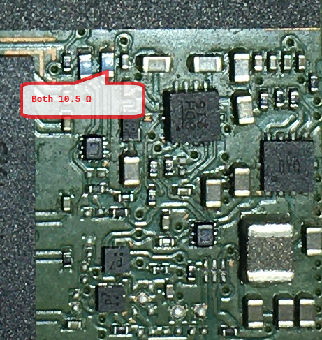

I think I can see two similar components in the middle of the PCB, above the top left corner of the SK Hynix chip.
 Post subject: Re: Dead nvme Intel 600p -> Data Recovery -> now part is mis
PostPosted: October 14th, 2020, 4:45
Joined: October 10th, 2020, 8:01
Posts: 31
Location: Germany
I've noticed them as well. From the dimensions and colouring, they could be the same.
But I wouldn't know how to measure them, without taking them off.

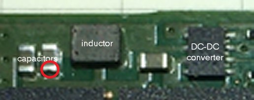

I can't see the markings on the ICs, but measure the voltages between ground and the junction of each inductor and its associated capacitors.

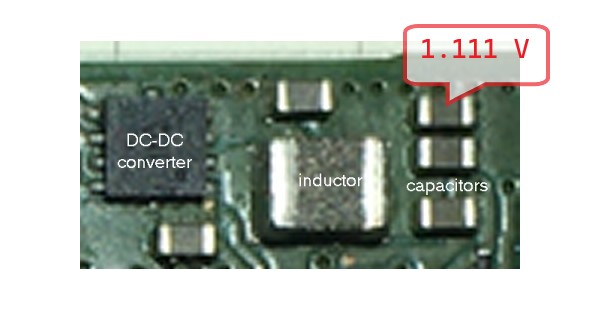

Thanks for looking at this!!! Just to confirm, since this electronic terminology is foreign to me, would this be the spot to measure, for example?
PostPosted: October 14th, 2020, 5:27
Posts: 17256
Just measure the voltage across the capacitor. It amounts to the same thing.
This is what you are looking for (quicker-and-dirtier switchmode regulator):
http://www.hddoracle.com/download/file.php?id=6446&mode=view
Tutorial - Linear and Switchmode Regulators used in HDDs:
http://www.hddoracle.com/viewtopic.php?f=59&t=231
As for the other components, just measure their resistances (with power off).
PostPosted: October 14th, 2020, 5:53
Posts: 17256
After you have verified the supply voltages, read this article:
https://blog.acelaboratory.com/how-to-recover-data-and-evidence-from-nvme-drives.html
It may be heavy going for you, but it tells you that your PCB most probably has a "ROM mode" test point at the "technological" end. Normally you would short the "ROM mode" test points during power-on, and then release them after power up. If the SSD then identifies itself, it will prove that the flash controller is not brain dead.

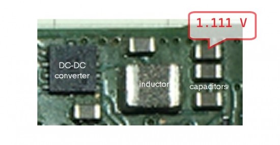

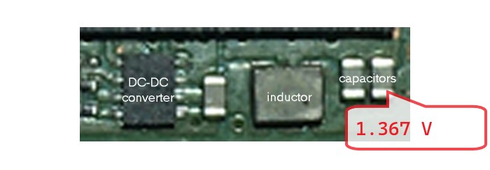

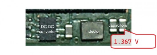

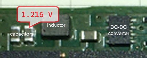

Thank you for the background info! I've done the measurements.
Can you read anything from that?
PostPosted: October 14th, 2020, 8:59
Posts: 31
Location: Germany
at the points indicated all ~ 3 kOhm, when measuring negative probe at GND

Resistance at junction inductor/capacitor to GND (image regX.jpg):
  • 1 = 1.57 kOhm
  • 2 = 0.98 kOhm
  • 3 = 5.59 kOhm

Posts: 17256
I wonder if the resistors are of the following type:
High Precision Wraparound - Wide Ohmic Value Range Thin Film Chip Resistors, Sulfur Resistant:
https://www.vishay.com/doc?53017
The SDRAM chip is rated for a supply of 1.35V or 1.5V, so I would think this accounts for the 1.367V measurement.
The Vcore supply for the flash controller would be around 1V, so I would think that would account for the 1.1V supply.
The 1.2V supply and the 3.3V supply would power the NANDs, IIUC.
In short, the power supplies look OK to me.

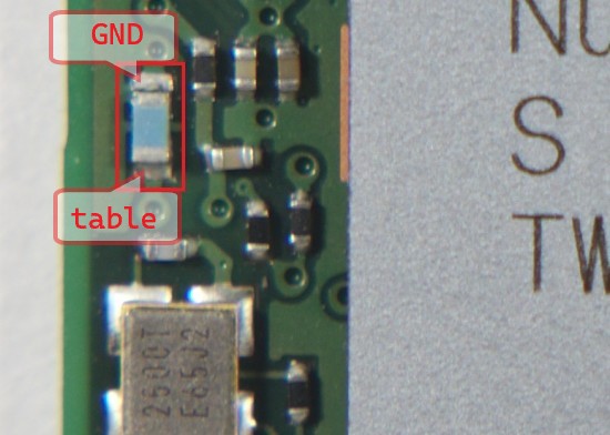

@fzabkar: Thank you so much, for identifying all those parts.
I am still trying to get the resistor somehow back.
Of course both companies tell me, they didn’t remove it.
I can‘t judge, if the ssd would be able to communicate at all without the resistor. Shorten the pins or not, drive is not detected in BIOS.

@P.F, if @gold6565 measured the resistor in-circuit, then the measurement would have been loaded by the resistance of the circuit. Taking your own measurements into account, the adjusted resistance would be 954 ohms or 825 ohms, depending on how the measurements were taken, but this would still be dependent on the multimeter.
    R = 770 x 3990 / (3990 - 770) = 954 ohms
    R = 770 x 11460 / (11460 - 770) = 825 ohms
You could solder two short wires to the pads and experiment with various resistance values, eg 820 ohms and 1Kohm.
One other thing you could test is the MP5087GG load switch IC (marking "BDG" ?). Measure the voltages on the adjacent capacitors.

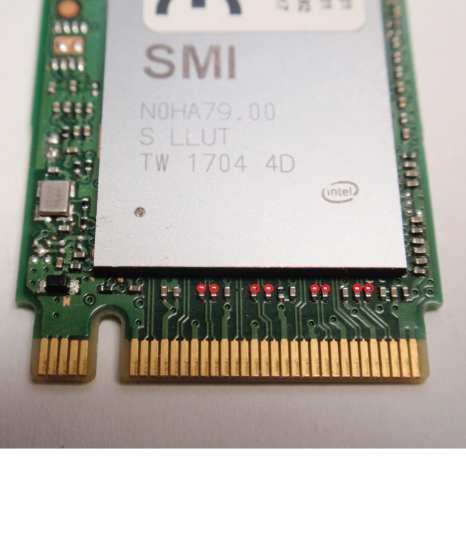

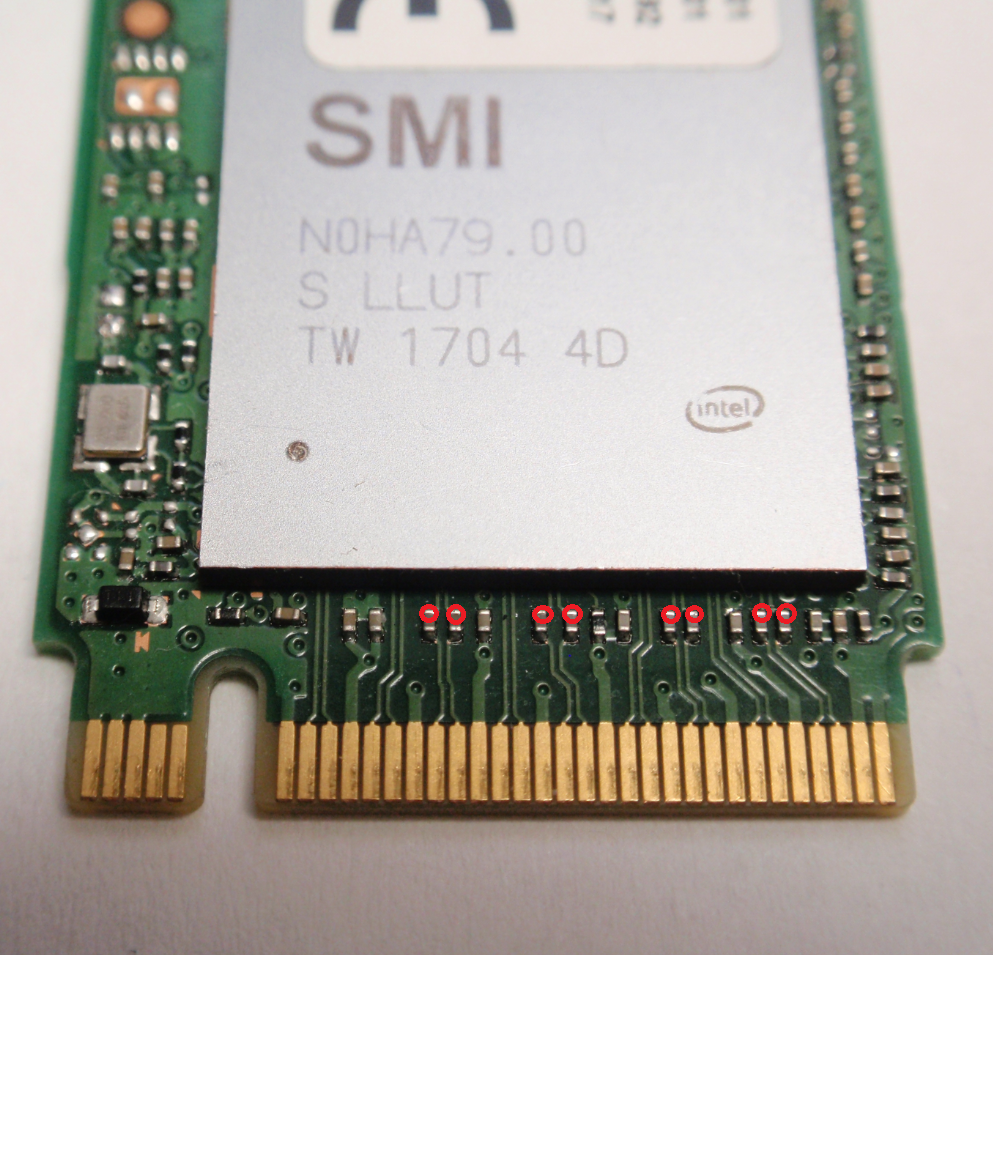

Hello Gurus,
sorry for the long wait. The donor drive arrived later than expected and my comparisons took time as well.
Here are the results so far:
  1. Restistor Value = 770Ohm, meassured out of circut, so exactly what gold6565 was saying, thank you
  2. When the resistor is taken off, drive has the same symptoms, not detected by bios, no rom mode when contacts shortened
  3. When resistor is put back, the drive is detected fine, INTEL (or SM2260 in ROM mode) (did this 4 times at least, take off, put back), the donor drive that is, not the one to be rescued
  4. When putting the resistor to the patient drive, unfortunatly, nothing :cry:
  5. BUT (now its getting interresting): I measured the voltages at the resistor pads, with resistor and without, on the working drive and the defunct.
      donor  |  patient  |  remarks (all measurements taken using usb adapter, IB-1817Ma-C31, while machine booted fully into windows 10)
       0.45V |    0.000V |  with resistor
       0.30V |    0.005V |  without resistor, laptop powered by battery
       1.00V |    0.005V |  without resistor, laptop powered by power adapter
       0.02V |    0.005V |  without resistor, laptop powered by battery, after ~106s, I noticed some blinking of the led of the usb adapter
             |           |  it seemed that's some powersaving functionality, the blinking and voltage switch did not happen, if only booted to BIOS
So, now I am thinking a lot of probably stupid things, but maybe you can make some sense of those observations.

Were the supply voltages (1.1V, 1.2V, 1.35V) the same on your donor SSD?
PostPosted: October 27th, 2020, 18:36
Posts: 31
Location: Germany
Yes
