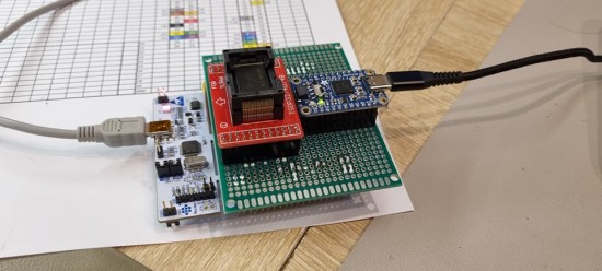

I rebuild my reader to increase reading stability. It seem to wok well.
Now I can go deep into ECC / BCH....
I'm curious to know how much it cost you to build your reader (time & $$$) in comparison to the $210USD for the flash-extractor reader (http://www.flash-extractor.com/shop/).
I'd also like to know if your setup will allow you to re-read the bad blocks after ECC is run on the dump.
Either way, you certainly have a lot of drive, persistence and free time to be doing this for your friend. I sure hope that they appreciate what you are doing for them.

Yes I spend ~30 min per day, not every day. I write my own C console application to download data from the reader. Yes I can set the start block and end block on the command line to download a block series or all.
I build the reader with what I have under my hand. I did not calculate the price of hardware, but it's something like :
NUCLEO L476RG    15.00 €
TSOP48 ADAPTER   10.00 €
FT232H BREAKOUT  10.00 €
PROTOBOARD        1.00 €
WIRE+CAPA         1.00 €
TOTAL            37.00 € (43 $)
It's really interesting technology but the main purpose is to help my friend
