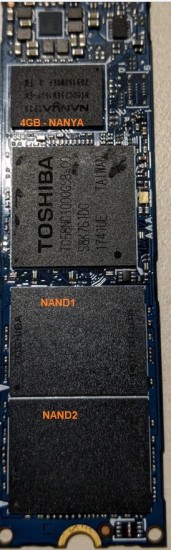

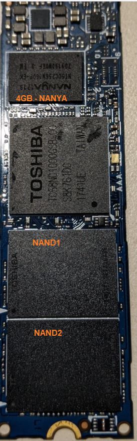

The only thing that occurs to me is that you could try to find the NAND R/B pin(s) and short one of them to ground during power-on. These pins are open drain, so no damage should result.
Thank you.
You mean 4 GB DDR 3 or the two Toshiba NAND?
https://www.nanya.com/en/Product/4248/NT5CC256M16ER-EK
 Post subject: Re: KSG60ZMV256G TC58NC1000 - rebranded Phison PS3110
PostPosted: June 8th, 2022, 16:32
Posts: 17092
I expect that each NAND would have an R/B pin, perhaps shared, and this pin would be pulled up to 1.8V via a resistor.
I don't know what would happen if you were to "defeat" the SDRAM.

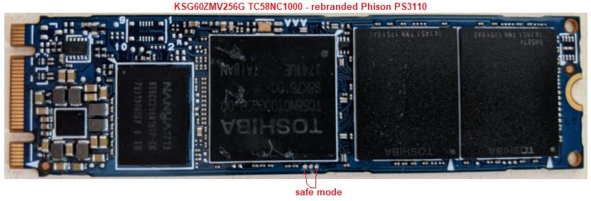

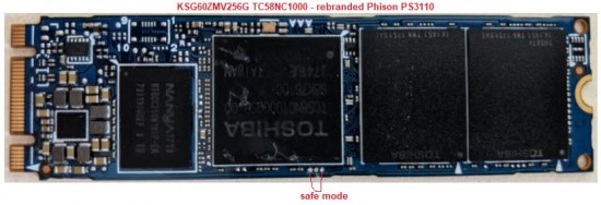

So have anyone found the ROM Mode of this SSD??
PostPosted: November 9th, 2025, 11:48
Joined: November 5th, 2015, 18:00
Posts: 80
Location: in the lab
The first image shows safe mode.
