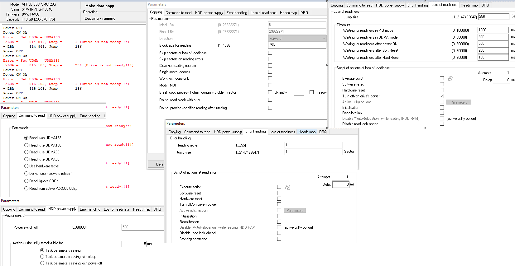

Here are my settings, i know it's ugly patchwork... :mrgreen:
Thanks for the effor!!!
I have UDMA133 disabled. Will try with your template anyway and report back.

UDMA133 is disabled because you entered settings manually, but the drive is definitely capable of that.
