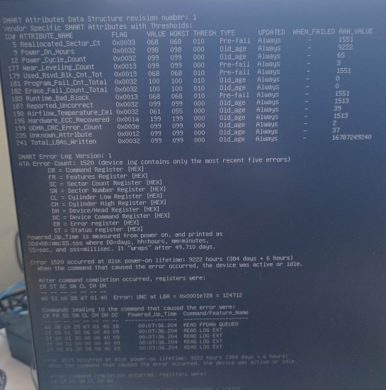

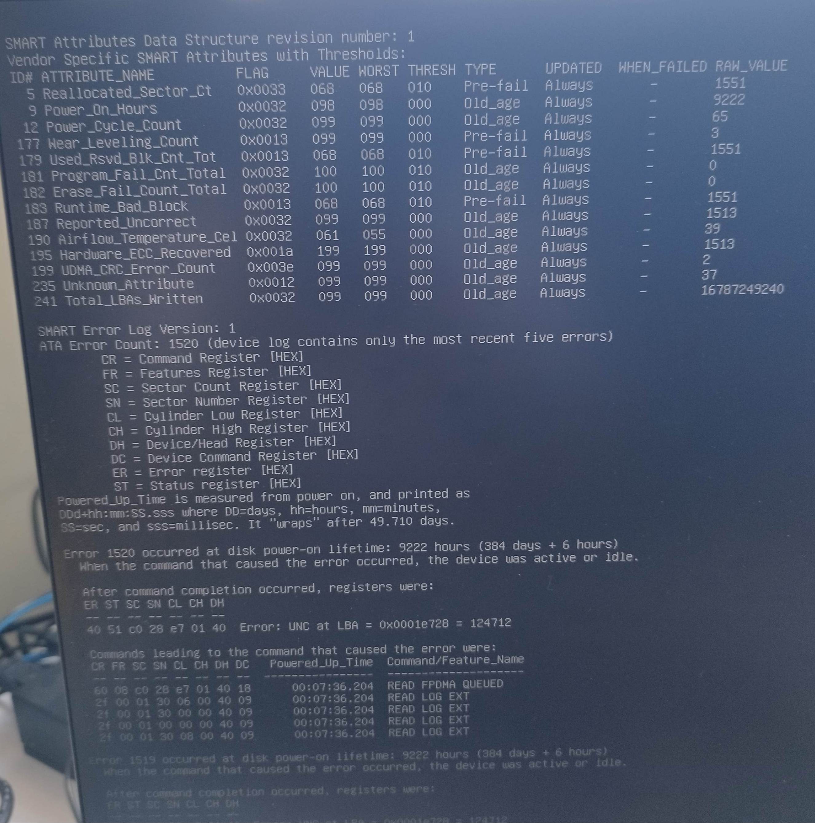

Unbelievable my Samsung's 870 Evo SSD SATA is obsolete after using 385 days. Still using firmware v1.
See also Ata TRIM cmd for all 800 serie have never been supported by Kernel main line
SSD Blacklist:
https://github.com/torvalds/linux/blob/ ... re.c#L4196
Some Windows user doesn't seem to have problems.
File comment: Picture of dumped smartdata
