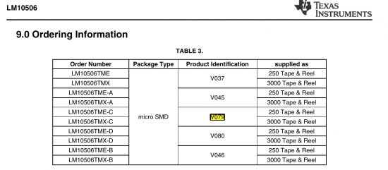

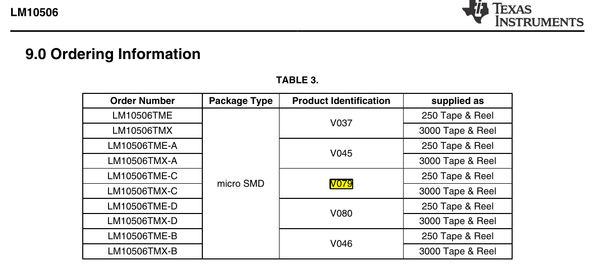

I had just a doubt about the L3, it took around 3 minutes to give a stable result after a long countdown, this didn't show up as a healthy part, compared to L2 and L4 that gave a stable result after a seconds.
Anyway, according to the image, my IC Chips is labeled as '79EJ V079', and it seems to be related to LM10506TME-C or LM10506TMX-C, ordering one or the other doesn't makes any difference or it really makes difference ?
Your answer is appreciated for then placing an order, thanks very much

The E and X denote the package quantity (250 / 3000).
Digikey has the A version but not the B, C and D versions.
https://www.digikey.com/en/products/base-product/texas-instruments/296/LM10506/93682
I congratulate you on finding a datasheet.
I came up empty here:
https://www.ti.com/packaging/docs/partlookup.tsp
... and here:
https://www.ti.com/lit/ds/symlink/lm10506.pdf
Here are the version differences:
https://e2e.ti.com/cfs-file/__key/communityserver-discussions-components-files/196/LM10506_5F00_LM10504-version-differences.pdf
 Post subject: Re: WD Green SSD 480GB Short Pins board Location SM2258XT
PostPosted: January 17th, 2023, 22:23
Posts: 17335
LM10506TME-C, Texas Instruments, PMIC, 3 x bucks + 1 x LDO, marking V079, DBGA-34:
https://datasheet.datasheetarchive.com/originals/library/Datasheets-IS94/DSAH00695519.pdf
It seems to me that the C version can be substituted with the base version. TABLE 1 shows that the Output Voltage Configurations for LM10506 and LM10506-C are the same. The ordering information section of the datasheet states that the C version has a "soft start in bypass mode" and "the buck 1 vout is discharged for 8ms via an internal pulldown after a UVLO rising event".
