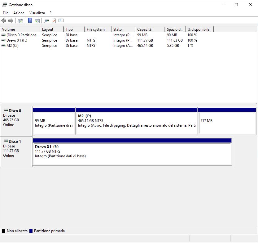

And continuing to tinker I was able to solve the problem and bring the ssd back to life!!
I leave the exact version that I used to flash the firmware, this is for those who have had the same problem as me,
thanks again for the help received from fzabkar, it helped me to get a minimum of culture and be able to understand certain things.
SM2258XT_IM3D_PKGQ0202B_FWQ0120B 2C,B4,78,32,AA,04\SM2258XT_IM3D_PKGQ0202B_FWQ0120B
I don't upload the file to avoid violations of the forum rules, but if someone gives me the ok I can do it.

Yes.
I also noticed that it was worth bringing back to life, because today looking for more info in it I saw that the bad sectors weren't even that many.
I also did some benchmarks (even the read and write speeds don't seem to have suffered much loss), and finally I did an optimization on it.
So I reinstalled SSD in my brother's PC, put on W10, the PC is better than before in moments!
In conclusion, it was definitely worth losing these days behind it to fix it.
