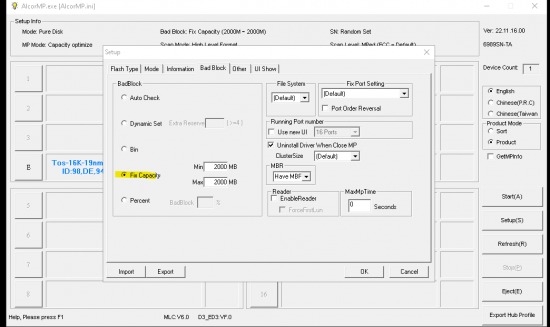

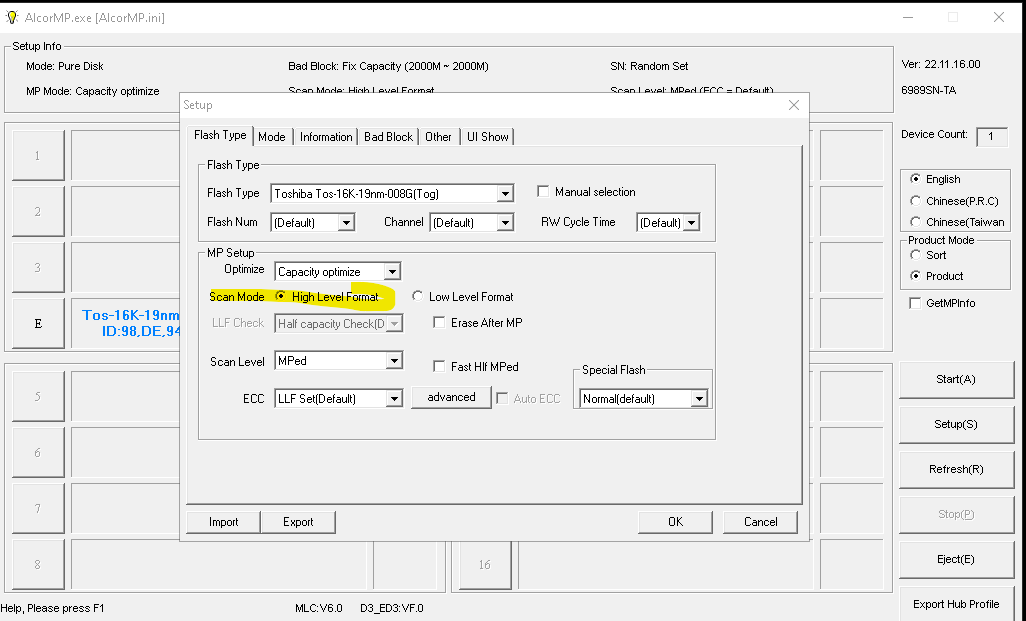

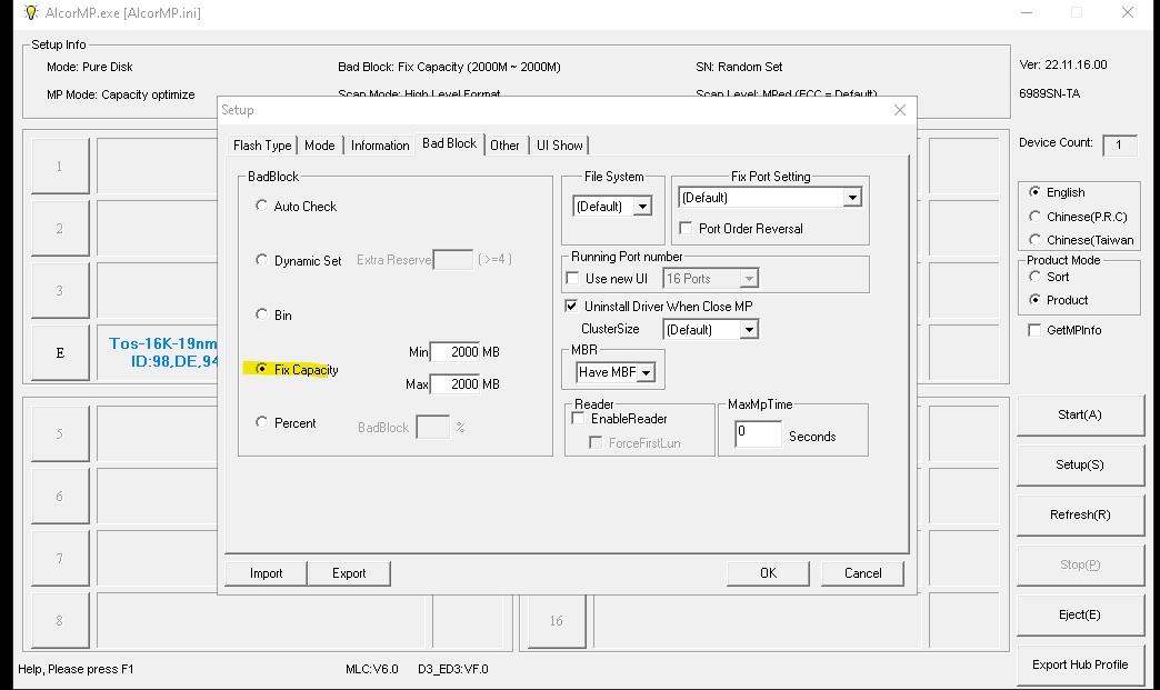

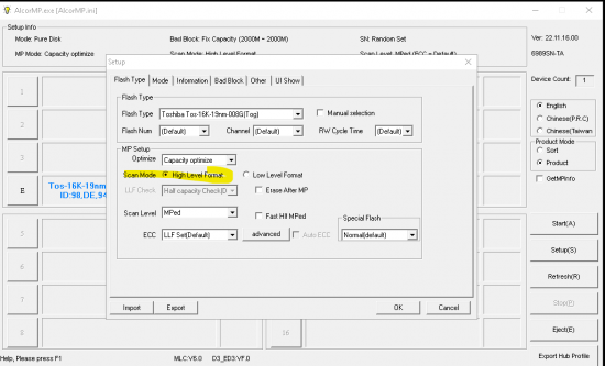

I am making steady progress in flash work.
I have only3 queries -
1) What should be minimum and maximum capacity I should choose - I want to reduce size of pen drive to 2Gb so is it OK to choose min /max 2000MB ?
2) Instead of low level format is it ok to choose high level format ? What is technial difference between them
3) I have not changed any other settings but might change custom serial No and USB vendor ID as per customers requirements.
Is there any additional settings I should choose ?
Thank you

 Post subject: Re: Size reduction (set max ) possible for USB pen drives ?
PostPosted: July 30th, 2023, 12:14
Posts: 339
Location: Eastern Europe
You are doing the complete refubrishen process.
The old table of defective blocks is erased and a new one is built based on the scan.
I would not change the default settings, except for the size and labels.
If you are worried about time - you have more than one USB ...
You set the required size in MAX, in MIN you save 1 less, for example.
PostPosted: July 30th, 2023, 12:43
Posts: 339
High level format, in theory the same Windows format. But didn't check.
Whether this will change the size - I do not know, I have not tried it.
Try it. :)
PostPosted: July 31st, 2023, 1:27
Joined: August 10th, 2015, 9:00
Posts: 41
Location: asia india
Hi Good Morning SWM
Thanks . MP tool is an advanced manufacturer level tool suitable for large OEM's typically. It has most powerful settings like limiting current /write protect /ECC etc.
Unless you have thorough knowledge its wiser not to touch anything.
Since I am just reducing size and actually not refurbishing like bad sector removal etc , high level format might be enough ,I will check both ways.
Regarding minimum capacity do you mean 1MB? or 1999MB ?
Thanks again. :good: :-D
PostPosted: July 31st, 2023, 14:35
Posts: 339
If NAND is good, the maximum size will be selected.
So it does not matter whether 1MB or 1999MB.
Good luck.
PostPosted: August 1st, 2023, 5:13
Posts: 41
Good luck.
OK Thanks . I have completed lot of first 100 out of 400 pen drives. Aprox 10 brand new pen drives failed giving bad blocks error though program managed to reduce (refurbish) it to lower value.
It seems Nand used is of low grade or due to ageing its degraded.
I also learnt that why Nand chip is also important in flash related work (often I see besides controller nand chip id was also mentioned.
I was wondering since controller uses wear levelling algoritham if controler is known or supported then why nand is needed
But now I realised that block design of each nand is differnt. So same controller may write differently on different nand chip I think.
Though this all exercise seems to be non professional non high tech ( since version available is from unknown sources and may not be actual updated proper version )
Still its learning experience. Thanks SWM it was possible because of you.
