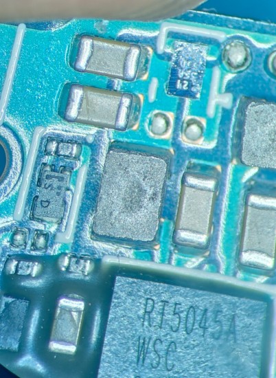

https://www.ti.com/packaging/en/docs/partlookup.tsp?partmarking=cbz
 Post subject: Re: Toshiba m2 died
PostPosted: December 30th, 2023, 23:51
Posts: 17356
GU = DZ2J068 / DZ2S068 = 6.8V Zener for constant voltage / surge absorption circuit:
https://www.mouser.com/datasheet/2/315/DZ2J06800L_E-1142209.pdf
https://docs.rs-online.com/7c3e/0900766b80e4a742.pdf

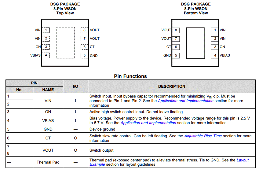

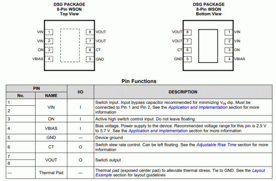

Measure Vin and Vout of IC "ZSA0".

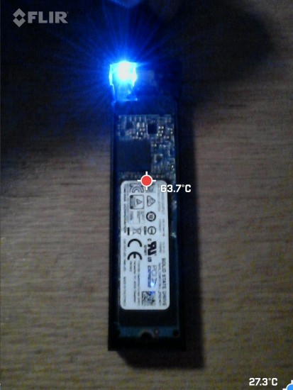

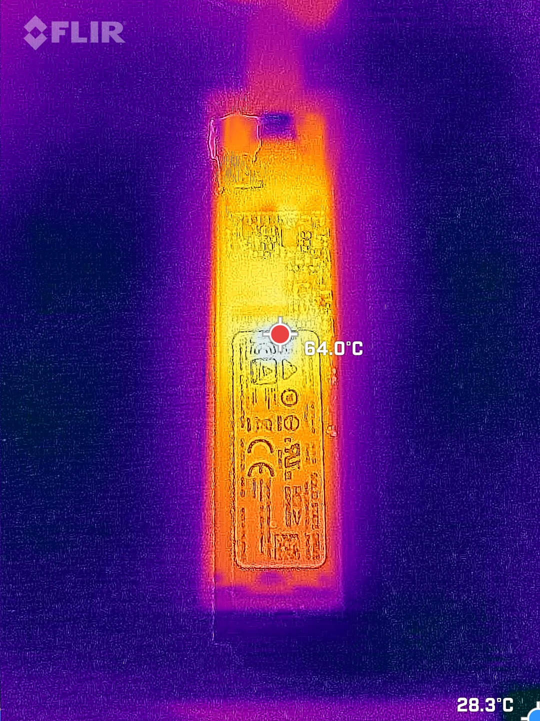

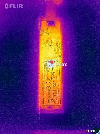

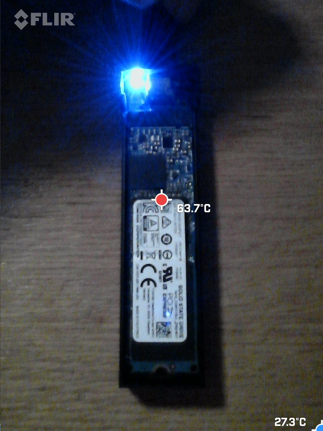

Usb c kabel were bad. I changed the cabel now the m2 ssd gets hot.
Here is a pic
PostPosted: January 1st, 2024, 19:52
Joined: December 30th, 2023, 17:17
Posts: 53
Location: Denmark
Vin and Vout is 3.2V.
The m2 adapter tries to start up but since there is a malfunction it start and stop every 5 sec. so the vin and vout voltages toggles between 3.2V and 2~.
its just a value, i think it starts so quickly up again , so the 2something volt is not important.
A ram chip gets hot, but im not sure if anything cause it. hard to feel.

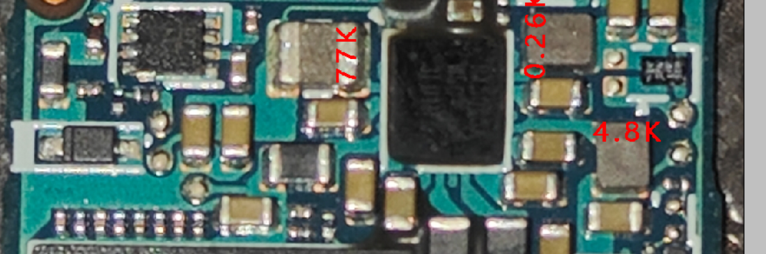

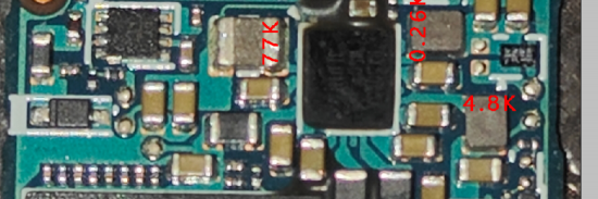

Measure the resistances between ground and each of the inductors at the PMIC. One of the outputs could be overloaded.
PostPosted: January 1st, 2024, 20:17
Posts: 53
Location: Denmark

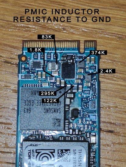

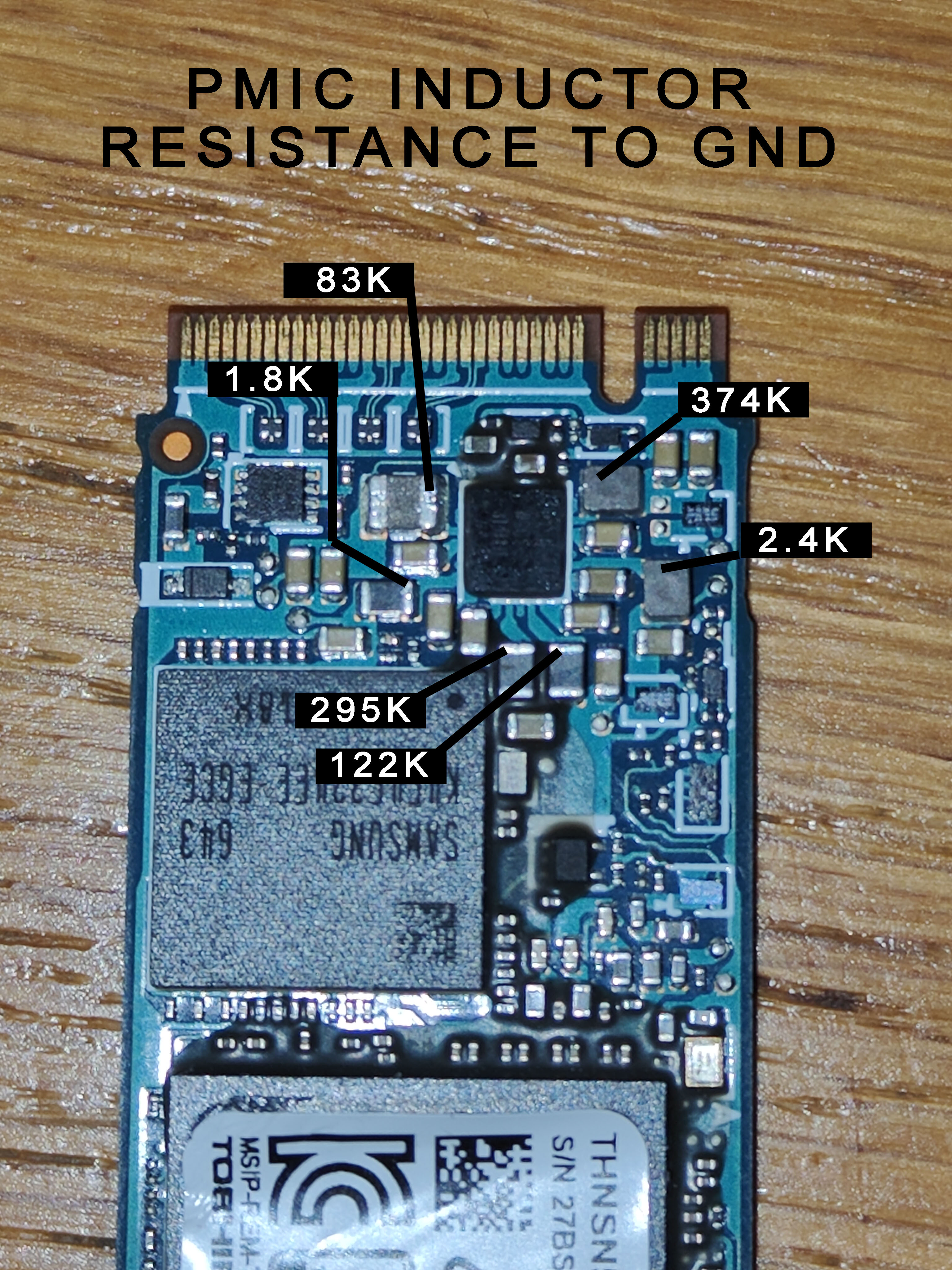

Maesured compard to GND
77 K
0.268 K
4.8 K
PostPosted: January 1st, 2024, 20:26
Posts: 17356

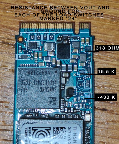

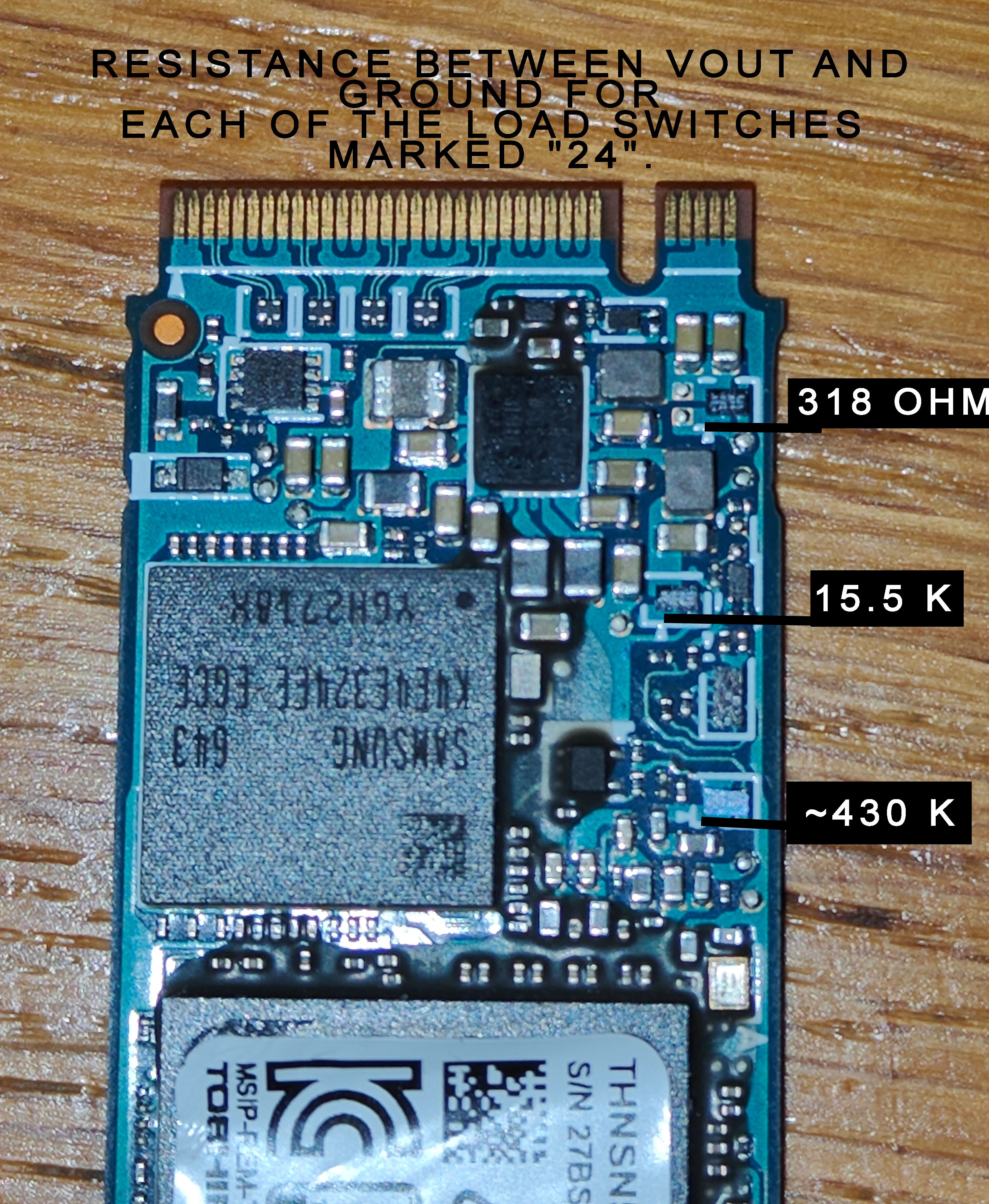

There are 3 more inductors, 2 below the PMIC and 1 at the bottom left corner.
If all those are OK, then measure the resistance between Vout and Ground for each of the load switches marked "24". Maybe that chipped load switch is actually faulty.

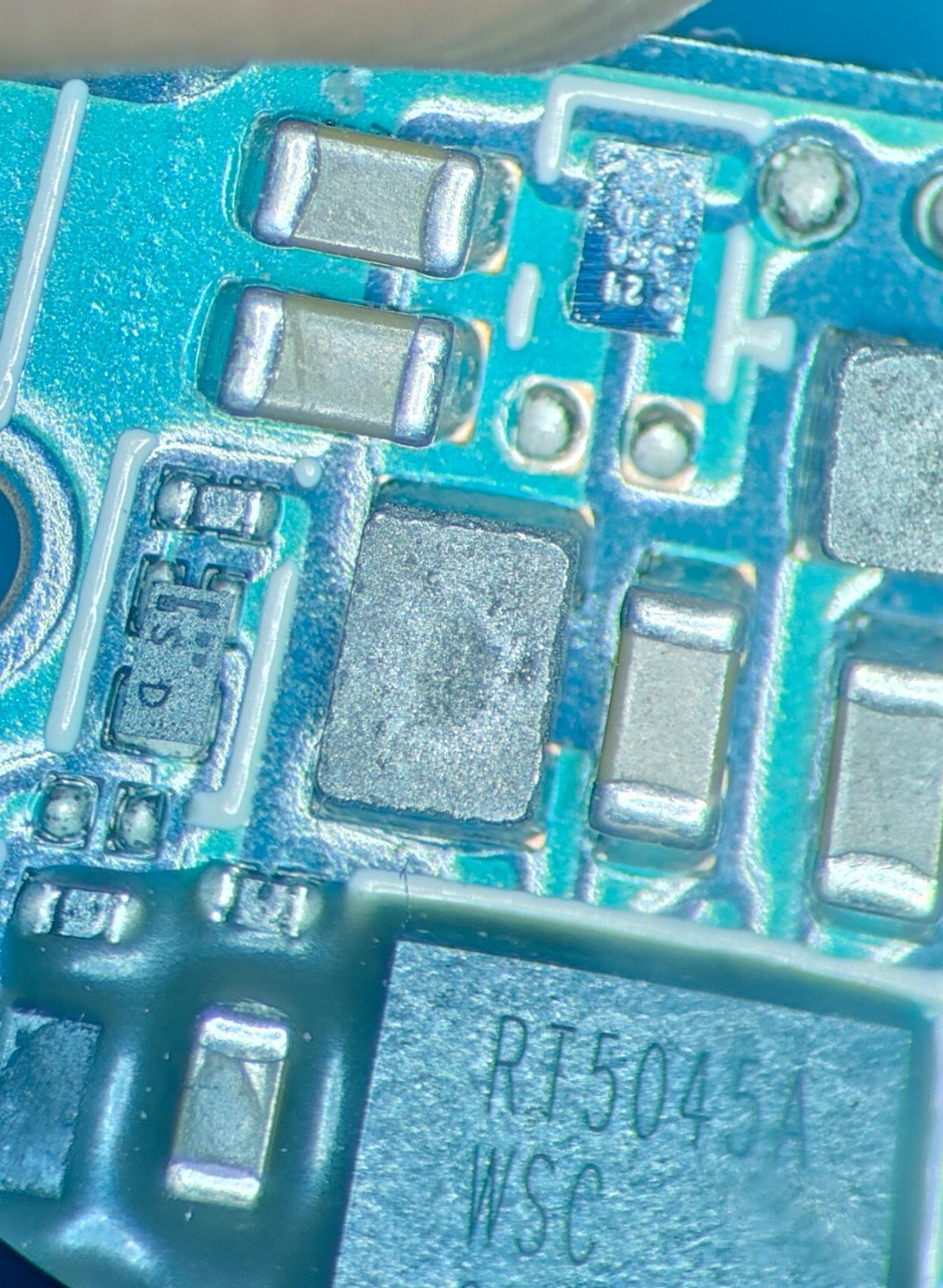

File comment: Chip 24 , out to GND
File comment: Pmic inductor resistance to GND
