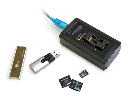

 Post subject: Re: Flash Disk Data Recovery Equipment (FDRE)
PostPosted: November 5th, 2008, 22:26
Posts: 1151
CK wrote:
http://www.acelaboratory.com/pc3000.flash.php
hello,CK,
i can not open you provide link, so you mention this tools?
data recovery service[/b]
PostPosted: November 7th, 2008, 14:44
Posts: 791
I would be interested if it can read MicroSD cards and descramble SAN-DISK Nand devices :)
