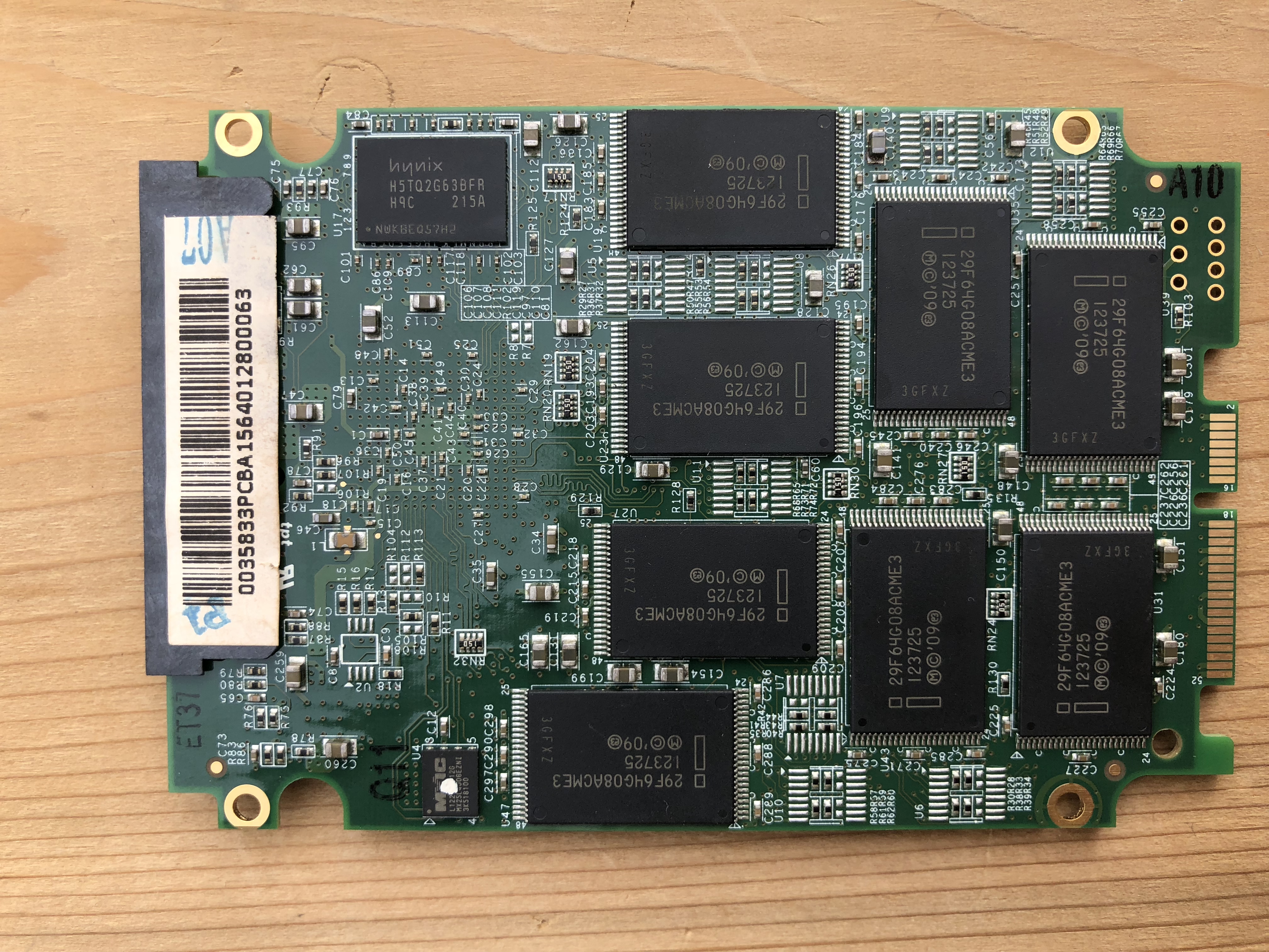

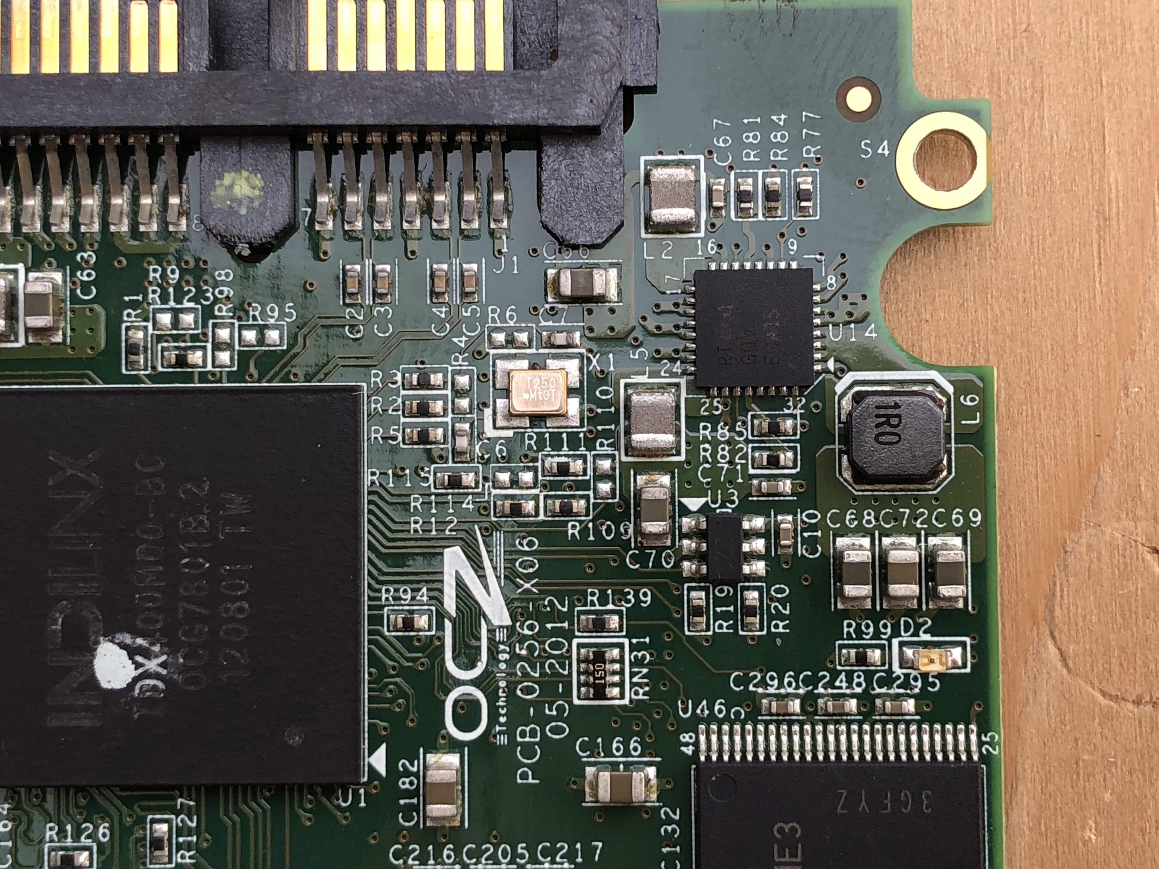

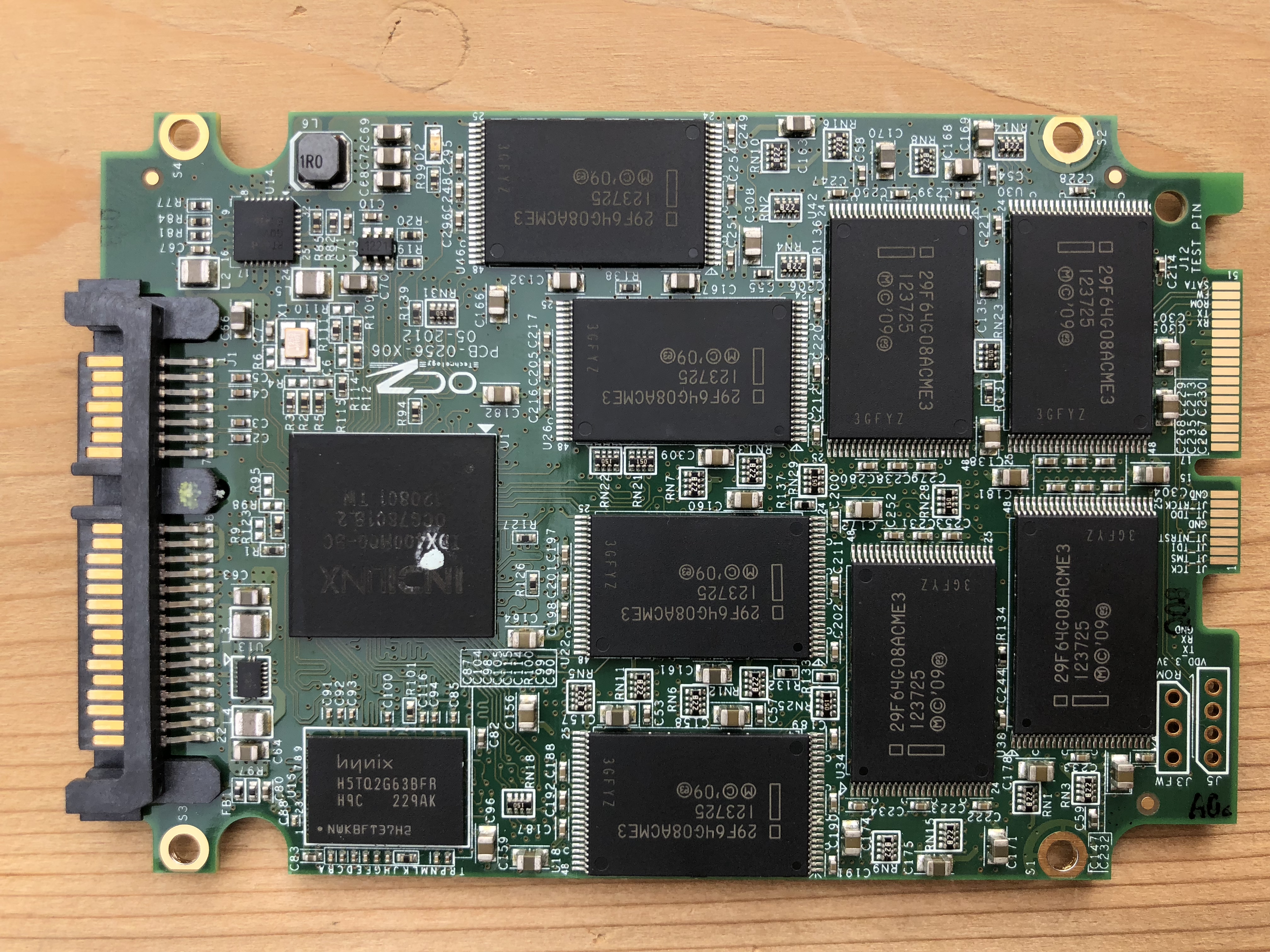

Yes reaching to test point and figure what can i replace that might bring the SSD from the dead will be great
Help to me.
Also visual check show that D2 led doesnt lit at all, and C140 show color sign of burn.
attaching clear photo as asked
Thank you :-)
Yuval

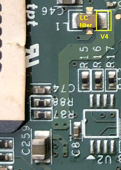

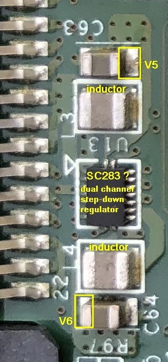

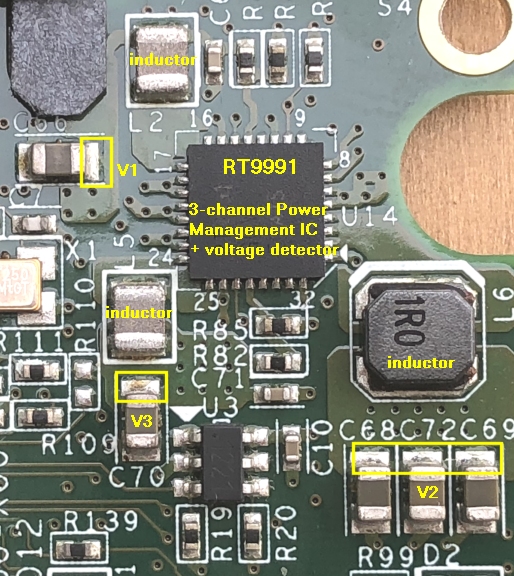

Start by measuring the resistance of C140 on the 200 ohms range of your meter.
Then measure the resistances between ground (eg a screw hole) and each of the V1 - V6 test points.
If there are no short circuits or excessively low resistances, then power up the SSD and measure the voltages at V1 - V6.

Remove C140 and check whether V2 is still shorted.
 Post subject: Re: OCZ Vertex 4 128gb UART Recovery method?
PostPosted: November 29th, 2018, 18:47
Joined: November 28th, 2018, 17:59
Posts: 15
Location: Israel
C140 Removed V2 changed to 30k resistance.
PostPosted: November 29th, 2018, 18:52
Posts: 17389
Power up the SSD and good luck.

Measure the voltages V1 - V6.
PostPosted: November 29th, 2018, 19:23
Posts: 15
Location: Israel
While power on:
V1-2.49
V2-3.28
V3-1.79
V4-2.49
V5-0.99
V6-1.49
PostPosted: November 29th, 2018, 19:31
Posts: 17389
Those voltages look OK. The drive appears to have a "firmware fault", ie the controller could be in "panic mode". :-(
You could leave the SSD powered on for a few hours and see if it eventually comes ready, but other than that I can't help you. Sorry. :-(
BTW, it doesn't appear that PC3000 has a solution for your Indilinx IDX400M00-BC controller.
